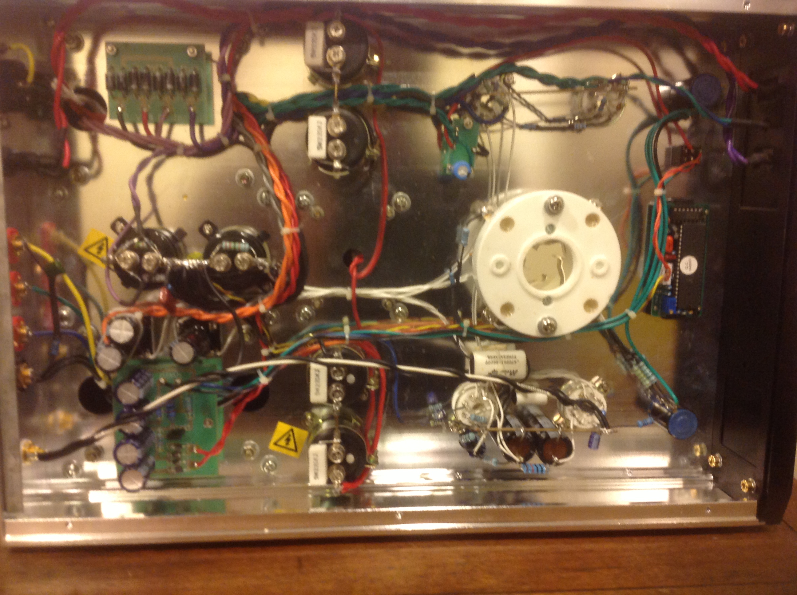

Hello.
I have a pair of ASL AQ-1006/845 Antique Sound Labs monoblocks and both died at the same time. I replaced the blown fuse and upon power on, they come on for 1-sec then shut back off - it blows the fuse. I don't smell anything burning. Roscoe suggested I post this to see if anyone wants to replaced whatever is failed. I'm in Bowie Md, so someone local to the DMV would be great.

Both mono blocks failed at the same time. I have taken out all of the tubes and replaced the blown fuse and upon power on it does the same thing. In short, it blows fuses whether it has tubes in or not.

There is a 0.1u mfd capacitor across the primary that could be shorted. If it's okay, you may want to start disconnecting one lead from each secondary until you find the portion that is screaming for current.

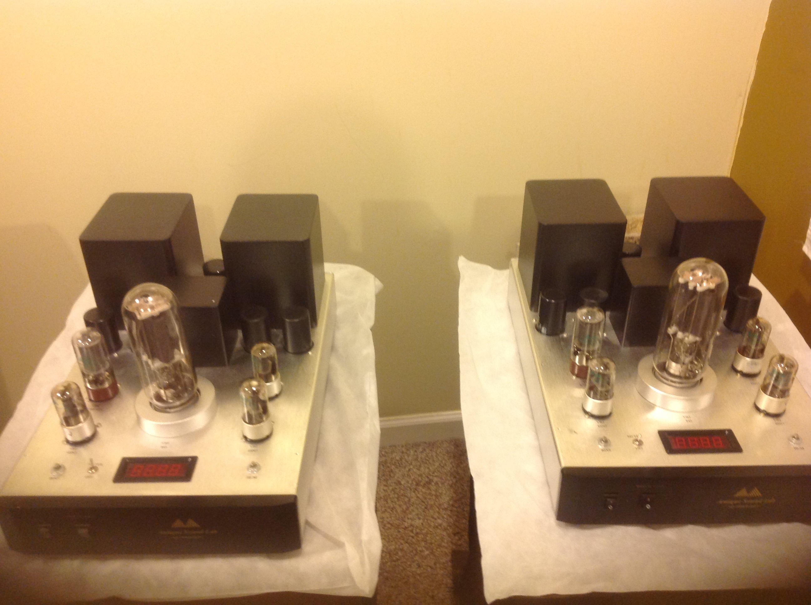

They have not been siting. They were working 1-2 days prior to failing. They were plugged into the wall. They longest duration of off/idle was about 48 hours.

It is odd that monoblocks would fail at the same time. I wonder about a power surge that shorted a small cap across H and Neutral or maybe fried the SS rectification?
