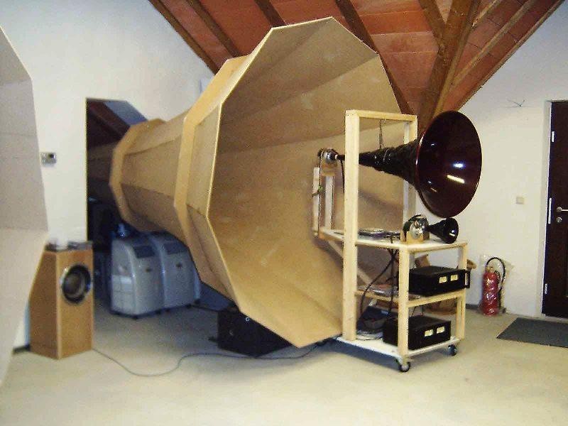

 Post subject: Re: My kinda speaker
PostPosted: July 14th, 2018, 8:02 pm
What's the cut off frequency of the big horn?
PostPosted: July 14th, 2018, 8:10 pm
Posts: 1202
Good question. I was wondering about disconnect between horns.
I would assume the bass horn goes up to 100Hz and black horn goes down to about 400 Hz.
