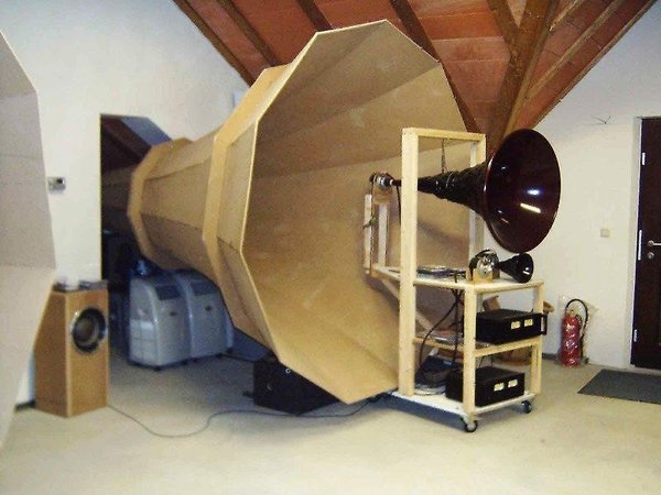

What's the cut off frequency of the big horn?
 Post subject: Re: My kinda speaker
PostPosted: July 14th, 2018, 8:10 pm
Posts: 1185
Good question. I was wondering about disconnect between horns.
I would assume the bass horn goes up to 100Hz and black horn goes down to about 400 Hz.

I always been curious to why it's considered that the launching point is at the VC and not the opening.
Maybe I can see that with horns but what about conventional drivers
The launching point would be at the voice coil. I recall when the late David Wilson was dialing in a pair of WAMMs here in Baltimore he used a dual-trace scope and pulses to line up the multiple drivers. When all was said and done they were all neatly aligned voice-coil-to-voice-coil. Since he was going for drivers' output to arrive at a point (the prime seating position) they were arranged in a way (kind of an arc) so that they were all aimed at that seated position.
The thing was that with all of those drivers including the electrostatic tweeters, as big as that system was, it sounded as one. Most manufacturers do not try to do that but Vandersteen and Dahlquist -- as but two examples -- made the effort in production speakers.
Of course Magnepans and electrostatic speakers are time-aligned by default. My horn-based system has an add-on ring tweeter that once time-aligned with the 800-Hz horn it joined the party and sounds as one driver not two.
I've sat in front of a big system a while back that had a tweeter tower, mid-range tower, and sub-woofers. It was not time aligned and that was immediately evident because of disjointed reproduction. It felt as though I was listening to three systems that could not synchronize and work together. It simply was not "speaking" with one voice.
I see your point. Time aligning sub bass horn is impossible but Mid and HF horns should be time aligned.
For compression drivers diaphragm is the launching point and for cone drivers, cone is the launching point.
