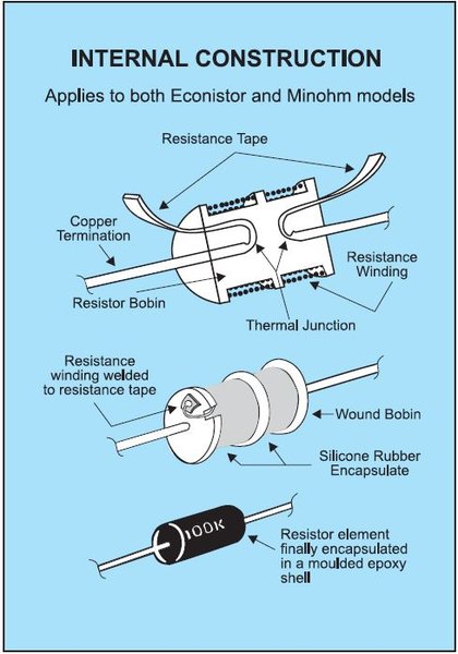

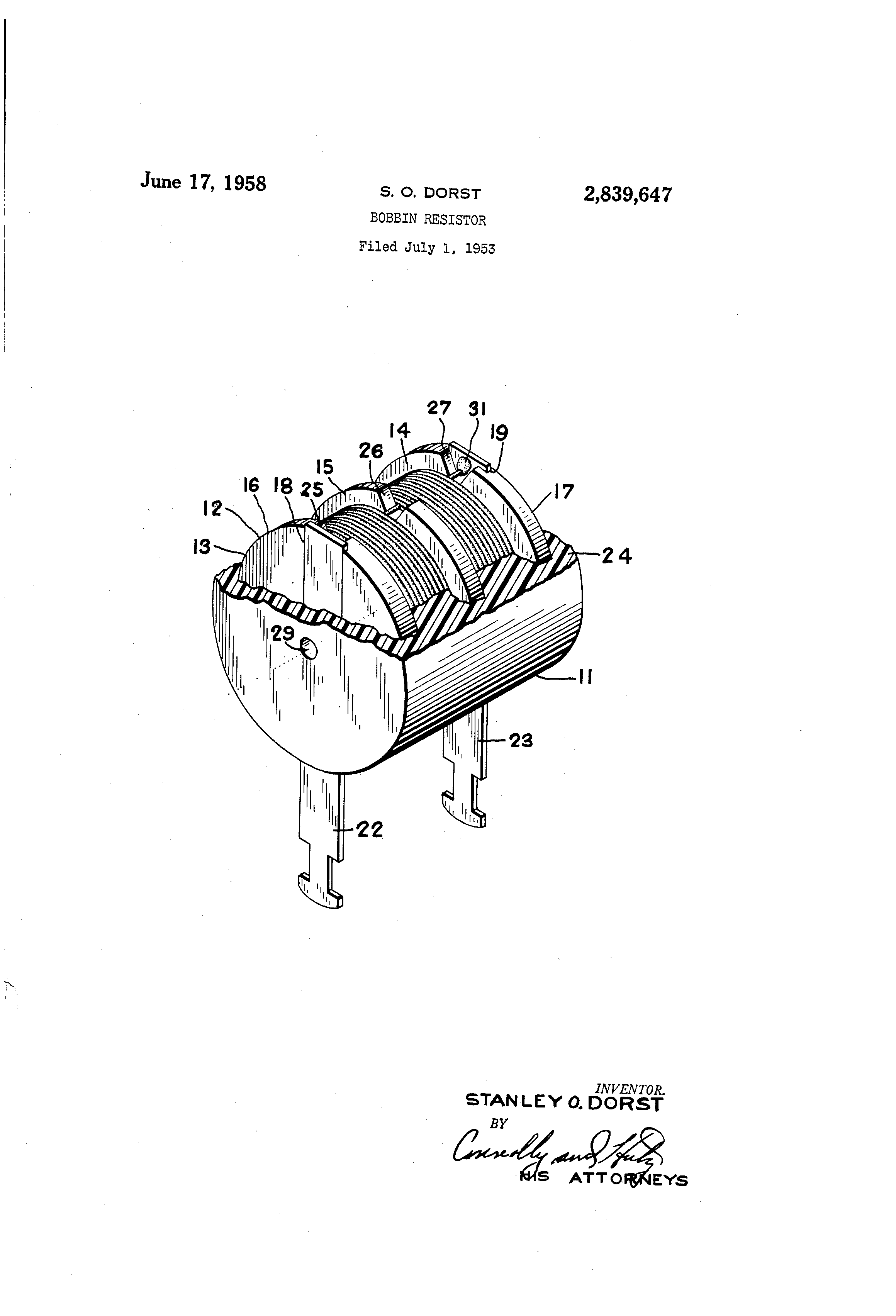

Are they just non-inductive WW resistors or bobbins? Bobbins are like two copper-wire coils back-to-back. Look at the attached images.
