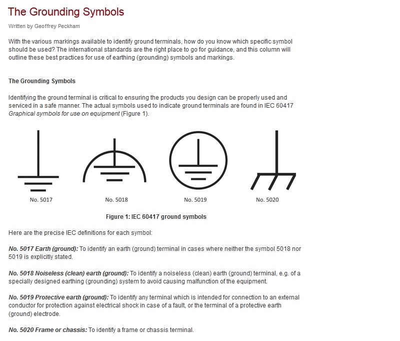

Yes maybe so that other models may have different configuration. I emailed the company and they would not send me a schematic. I would like to know what that weird ground symbol is about

Here is a link to info I found on the dirrerence between a standard earth safety ground and a noiseless ground. In any case it appears that the symbol is not used properly in this isolation unit as both grounds are common.
http://www.aelgroup.co.uk/faq/faq008.php
Re: Isolation transformers
August 8th, 2018, 4:46 pm
Thank Tom
I found the article very interesting since I was going to try circuit 2 and isolate equipment ground from house ground. I have done this before but found that it is against code to have two separate grounds and if one chooses to have multiple grounds they must be bonded.

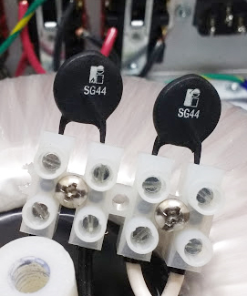

I am finishing up my build but I have a question.
Pictures are a couple devices that are in series with the primary Load and Neutral
I first thought they were MOV but I thought MOV go accross between N and L
anyway here is the pic:
August 11th, 2018, 10:50 am
Pelliott321 wrote:Pictures are a couple devices that are in series with the primary Load and Neutral
These are NTC (negative temperature coefficient) thermistors. They limit the inrush current that can occur when you first power on a piece of equipment.
Here are a couple of links from the manufacturer of these parts that explains their properties and how they protect transformers.
---Gary
https://www.ametherm.com/surge-gard
https://www.ametherm.com/inrush-current ... rrent.html

August 11th, 2018, 10:58 am
---Gary
I am not sure you want those devices in circuit. They will definitely raise the source impedance, which would not be an issue with computer electronics.
Besides, the surge is not going to be any more than the current draw of your goodies. You may also find that your power amps. will not perform as well when fed from the isolation transformer. Even my Carys don't like it and they only draw 3-amps. on a good day.
August 11th, 2018, 1:09 pm
Thanks for the info guys. I was hoping to determine that those device could be left out.
I just want the Felix filter on the mains side and duplex sockets on the load side
