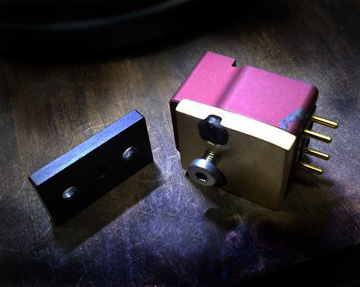

I spent way too much time making a new cartridge mount out of brass. The picture shows the original from arm builder on right. It weighs a little over 2 grs.
The new one mounted to the Denon weighs 8gs. This makes the overall weight 4grs more than when I added weight to the stock arm. The potted Denon
weighs 14gr, considerbly heavery than the stock Denon at 8.5gr.

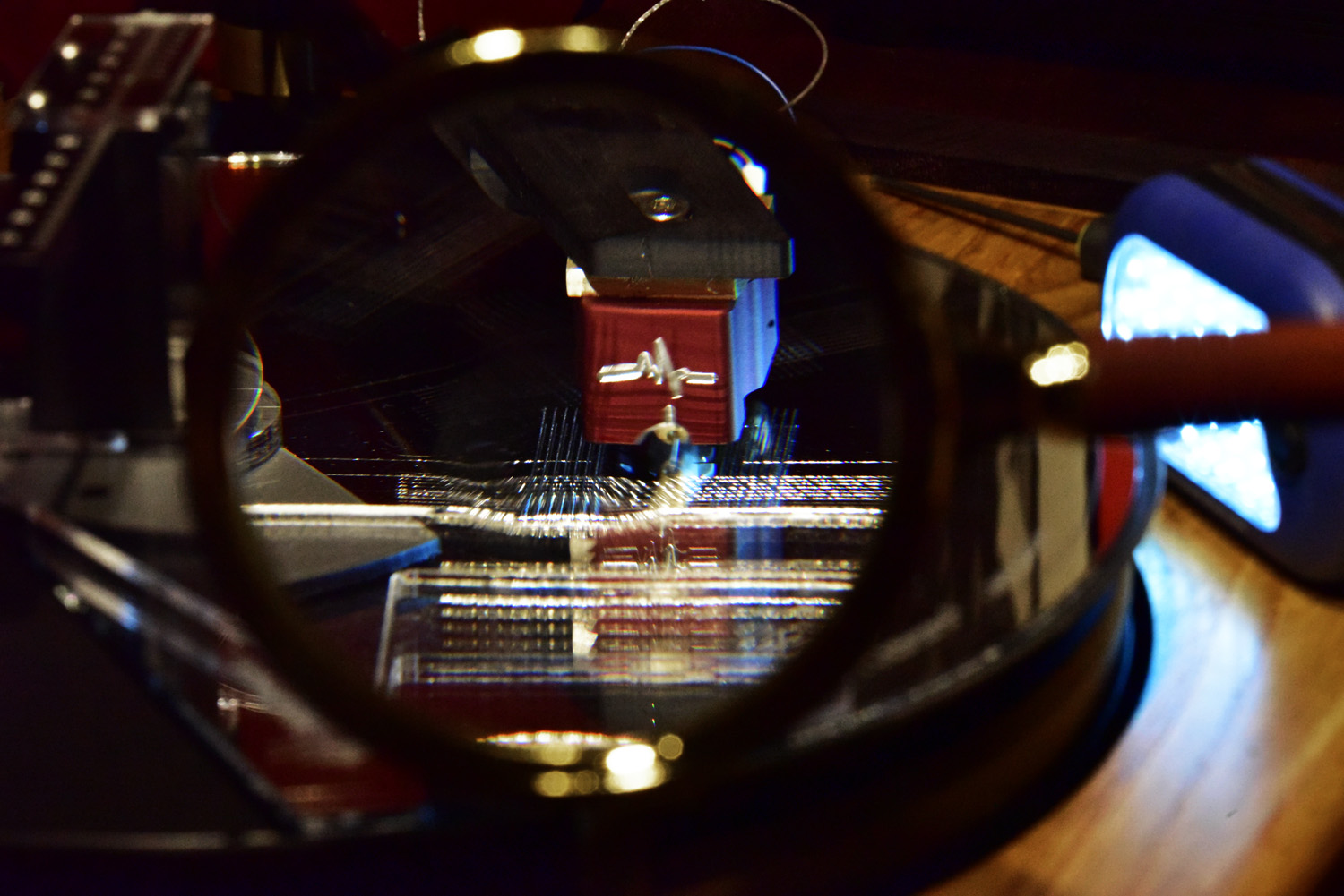

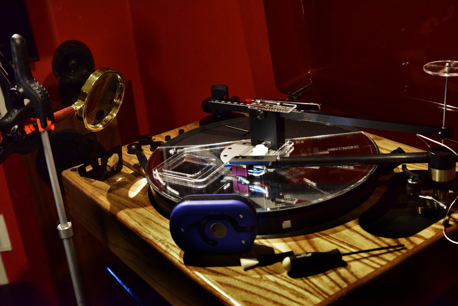

I purchased on ebay a 20X hand held magnifying glass
https://www.ebay.com/itm/182946295838
this really makes setting up a breeze
