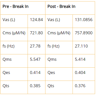

Paul:
Here is an example of the parameters of a 10" woofer before and after break in. Note that the parameter changes are minimal. the change in Fs is about 0.7 Hz, hardly noticeable. Also you don't have to be concerned with VAS because they are not in a box
Driver breakin parameter change.png (16.81 KiB) Viewed 23153 times

I am just relating what the designer/builder said.

One example doesn't prove the general case....
http://www.gr-research.com/myths.htm
http://www.gr-research.com/burnin.htm
paint a somewhat different picture...
