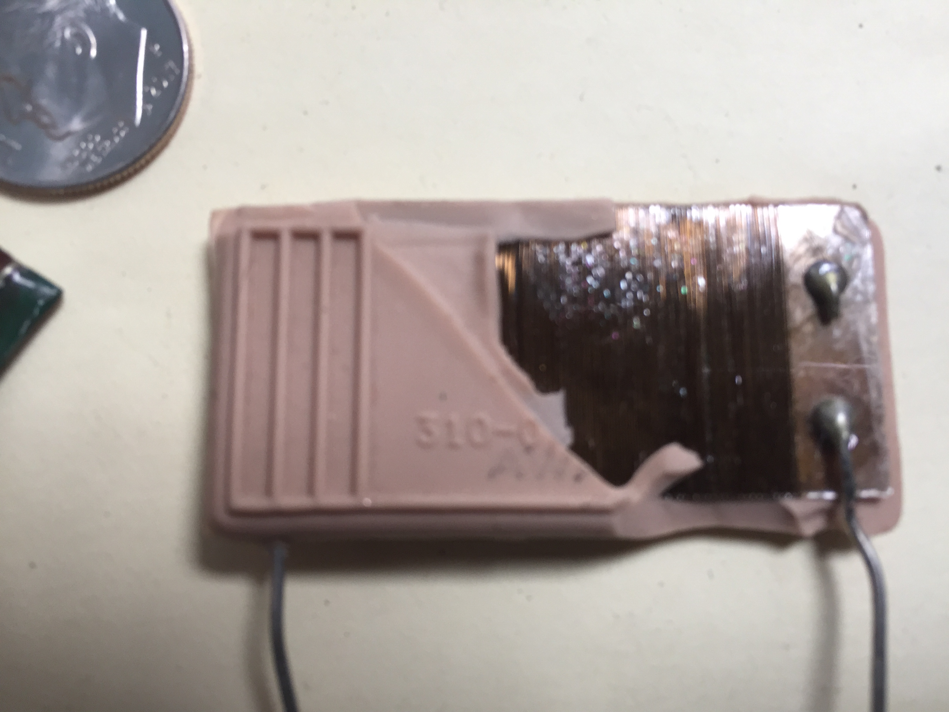

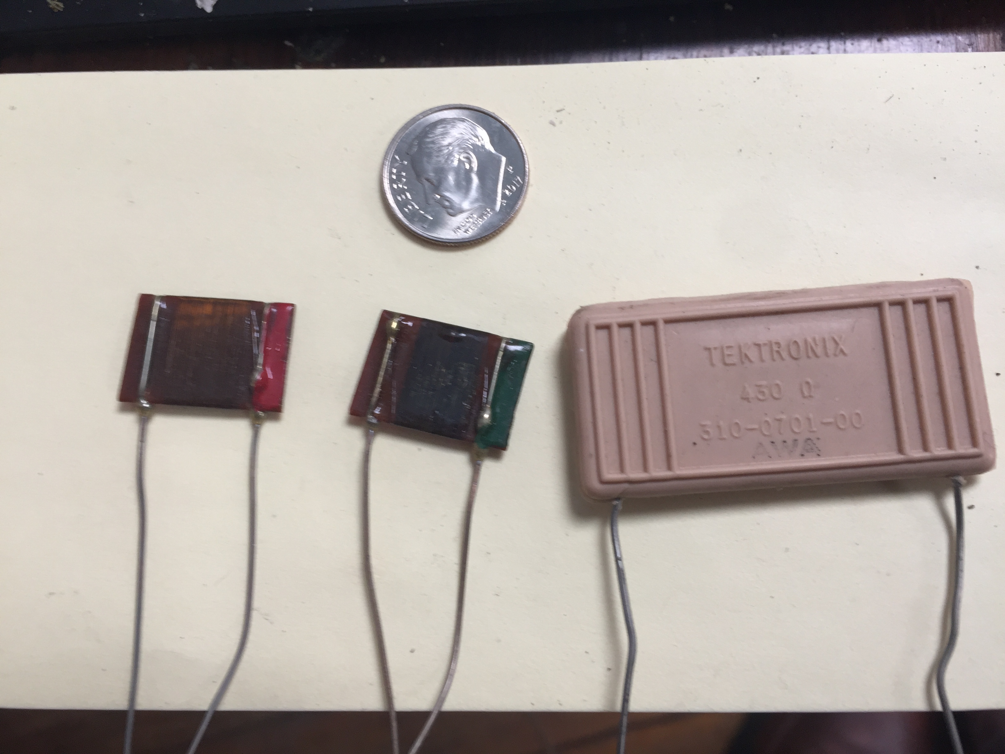

Here are a couple photos of card wound resistors I found at the hamfest on Sunday FYI...about all I could find to buy! :mrgreen:
The two on the nude phenolic formers look to be WE or Daven, And I found a weird rubber coated mica card resistor marked Tektronix. This construction is naturally low impedance. Zero impedance is basically impossible. Stability and low noise are the reasons for these rather than low inductance per se. There are some with special winding geometries for even lower inductance, but these kinds of resistors are usually in DC or low frequency circuits where the small inductance values have little effect.
