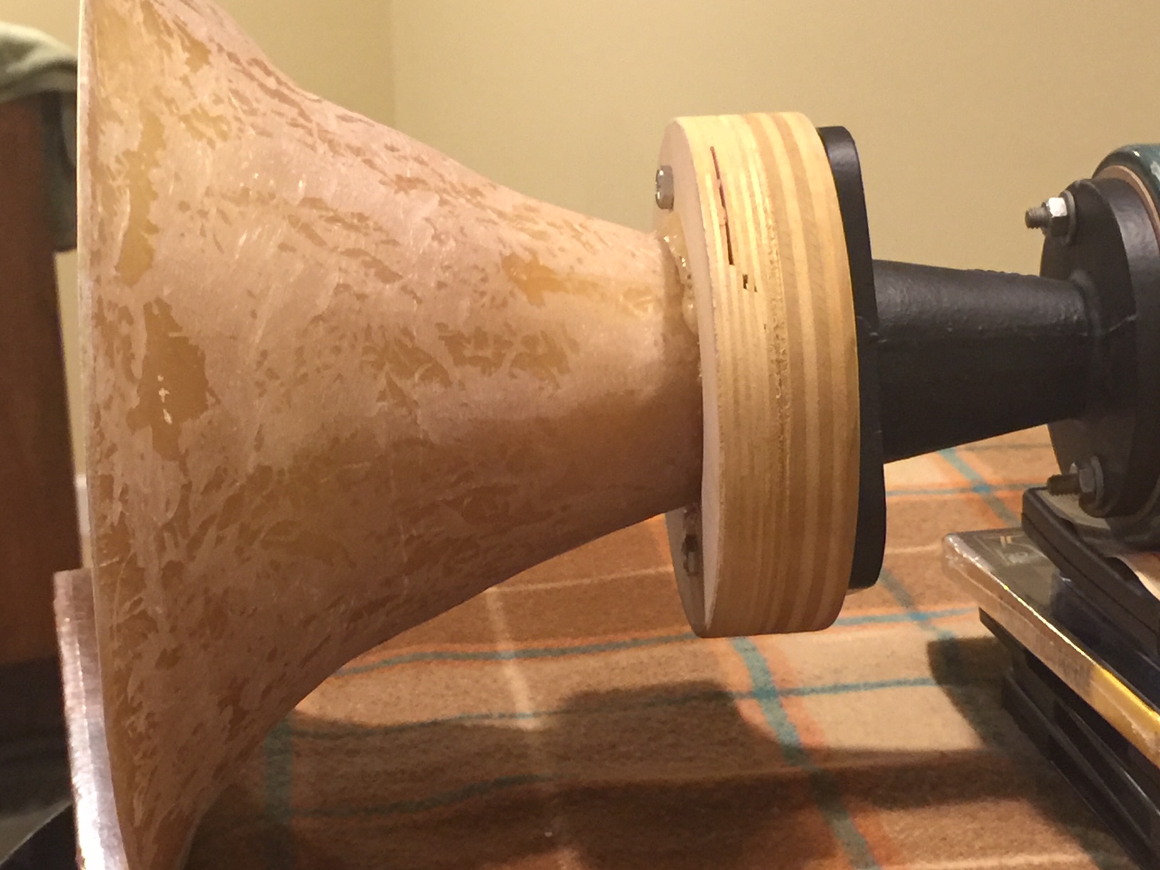

They're a JM Le Cleac'h based horn that Gary had made...
The horns I have do not have the LeCleac'h mouth rollback.
