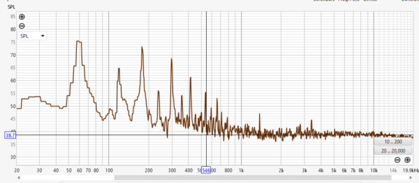

This is the noise floor measured by REW.
Look at the 60Hz fundamental and its harmonics. Any ideas?
PostPosted: March 29th, 2024, 11:55 am
I think you just have a ground loop. You have a very complex system setup and its going to be very tedious to hunt down problem.
You got to simplify and just start with one amp and one speaker.

With the David McGown's help, I was able to eliminate the hum in couple of amps. There is still a slight hum in one sub channel coming powered by a cheap solid-state amp. Going to replace the amp soon.
