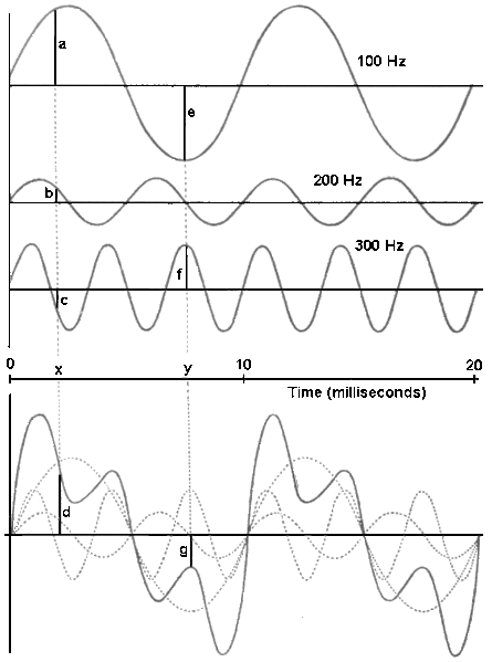

What are the transmission line effects and how do they apply to audio frequencies? I can gather this which seems very relevant to audio.
Quote:
As a mental shortcut, so as not having to analyze the harmonic components of a signal, compare the rise time of the signal to the propagation delay. If the rise time is less than twice the propagation delay, transmission line effects must be considered. So if the propagation delay of a wire or trace is 5ns, then any signal with a rise time of less than 10ns will be affected due to transmission line effects.
https://www.allaboutcircuits.com/techni ... sion-line/
Lets look at a simple application of addition of three sine wave frequencies. Its not hard to imagine where harmonics will create a waveform whose propagation delay is less than the twice the rise time.
IOW, transmission lines might help preserve the harmonics and dynamics. How they do it, is beyond me. Maybe, David will chime in.
