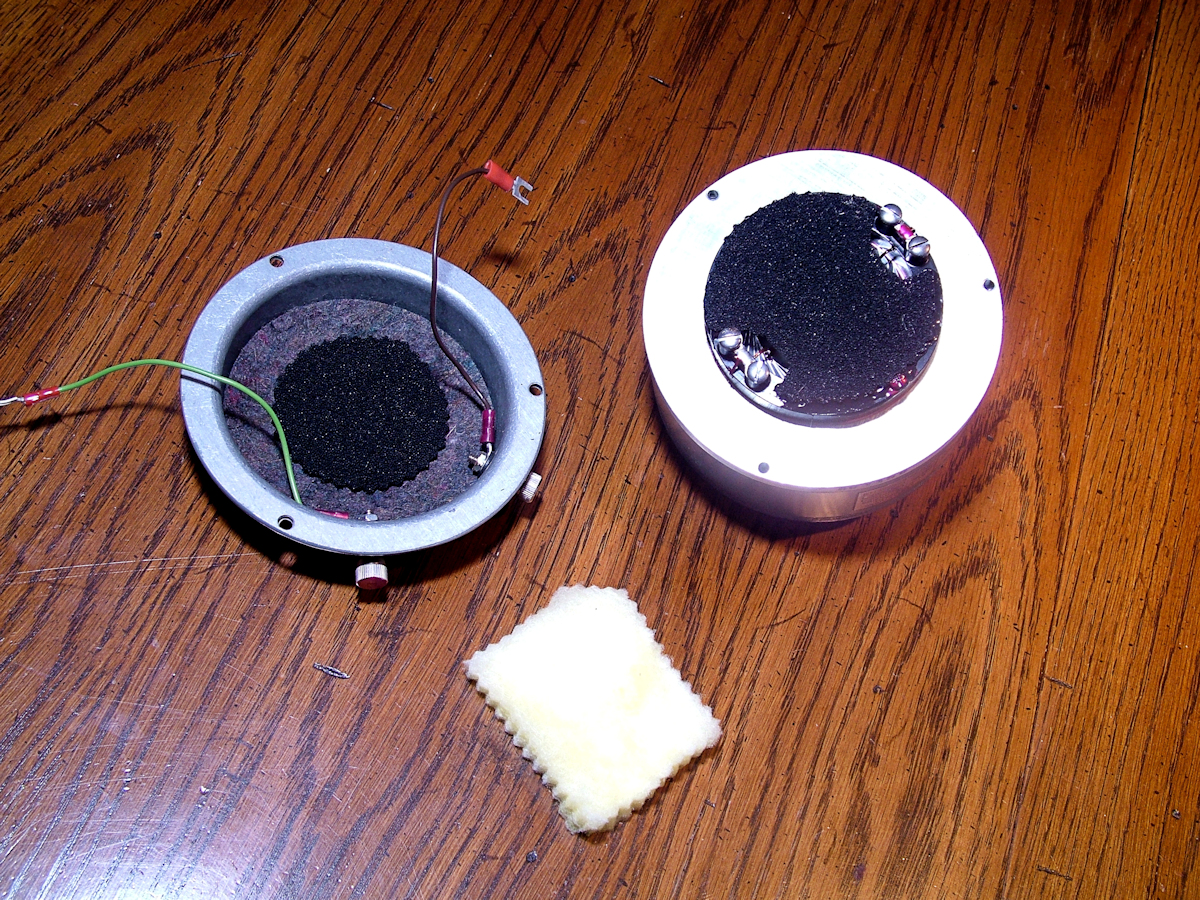

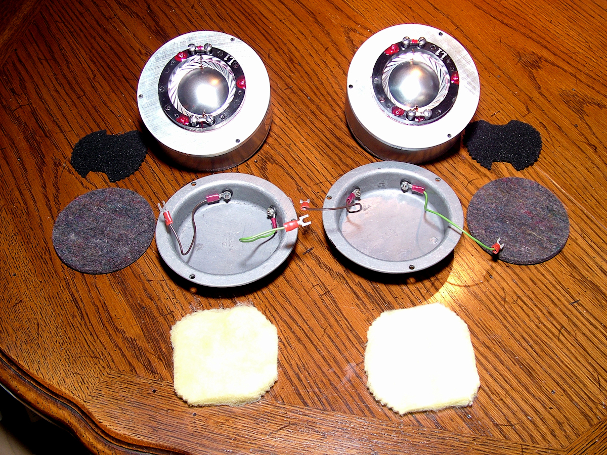

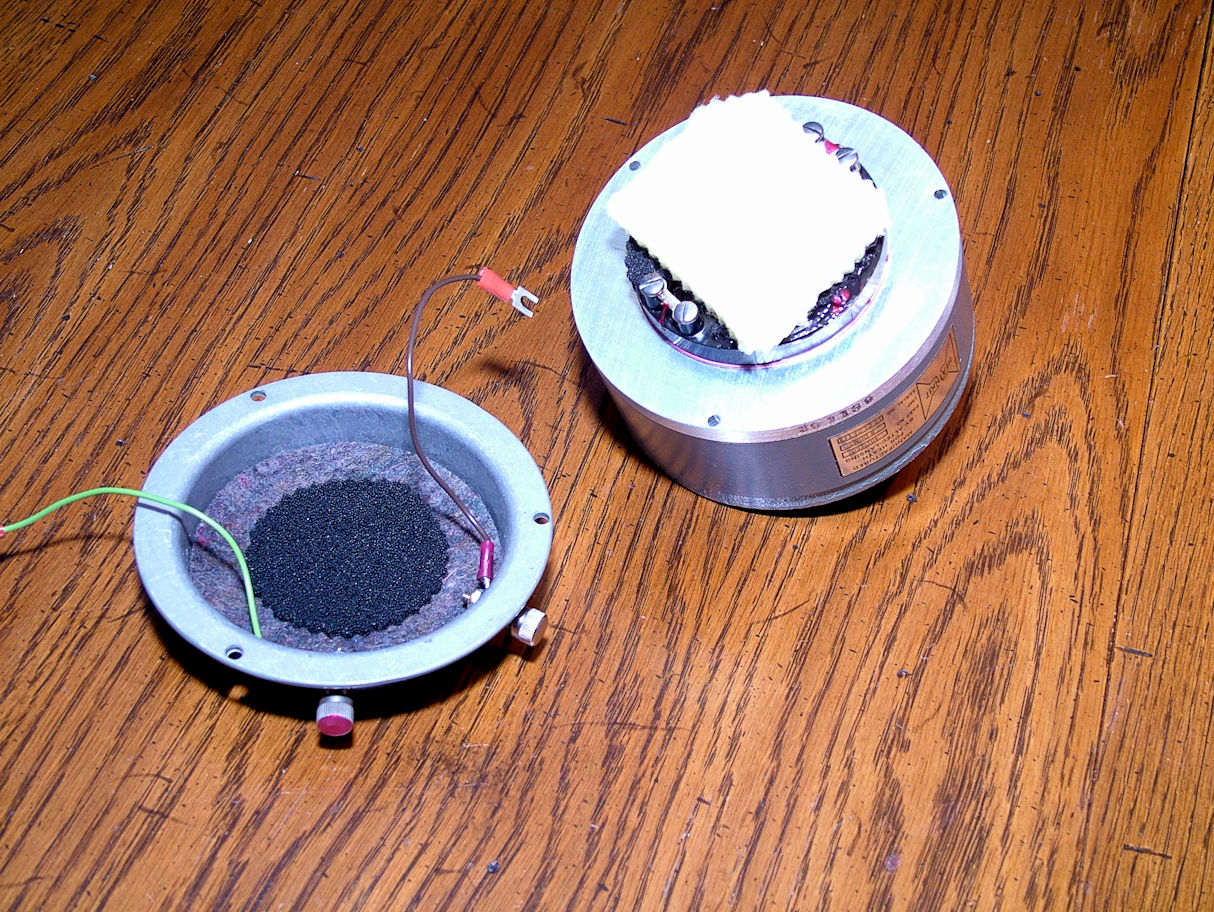

What I did with my Altec horn drivers is NOT something you buy as a finished product. It is a DIY scheme to tune the horn driver enclosure like a you would a big box.
What I did was not arbitrary -- it was the product of trials with different materials. Also, I drilled two 1/16-inch holes in the back of the covers to relieve cavity resonance -- the holes act like restricted vents to stop the cavity resonance.
I ended with a combination of the original felt in the back together with fine fiberglass and carbon impregnated foam. The carbon foam works well because is not reactive.
