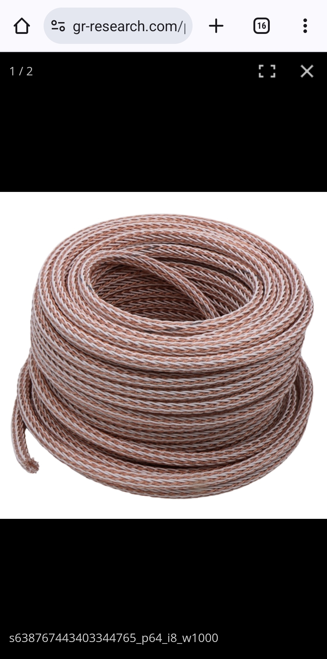

Both David M and I have excellent results using a braided speaker cable. It should provide superb resistance to RF interference. I bought my kit from GR Research, David bought his parts from either eBay or Amazon. He can fill you in. You won't be disappointed in the sound and it may eliminate your RF issue.
PM me if you'd like more info.
PostPosted: March 26th, 2024, 3:16 pm
16 or 24 strand

16 or 24 strand
That looks like the Belden CAT5 braided speaker cables I made 20+ years ago. I will post a picture when I find them.
Seriously, those will be difficult to use with compression drivers, they are too think.
I have two 30ft twisted WE16 cables. I will slice it into smaller sections and start using for now.
