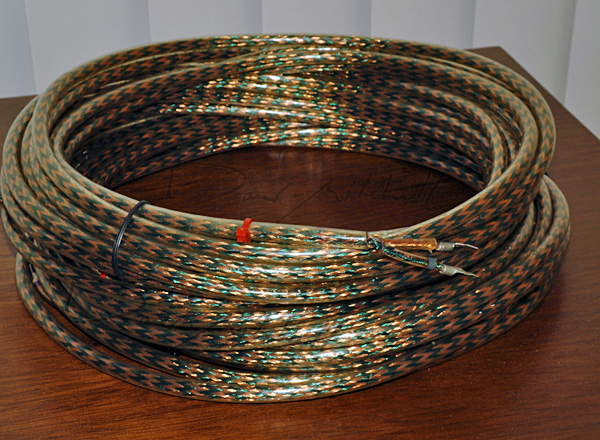

It is a Zobel network (aka. snubber). It serves to help amplifier stability when connected to speakers with cables that may create possible oscillation because of interaction with the amp's feedback.
And the Carvers have a boat load of feedback. Polk Audio sold snubbers like this with their Cobra Cables because of stability issues with that cable. The RC network was contained in a plastic enclosure that you connected to the speaker terminals.
