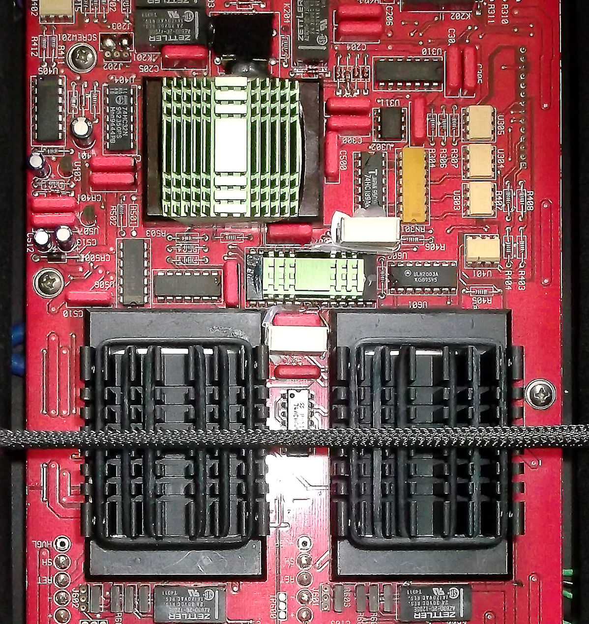

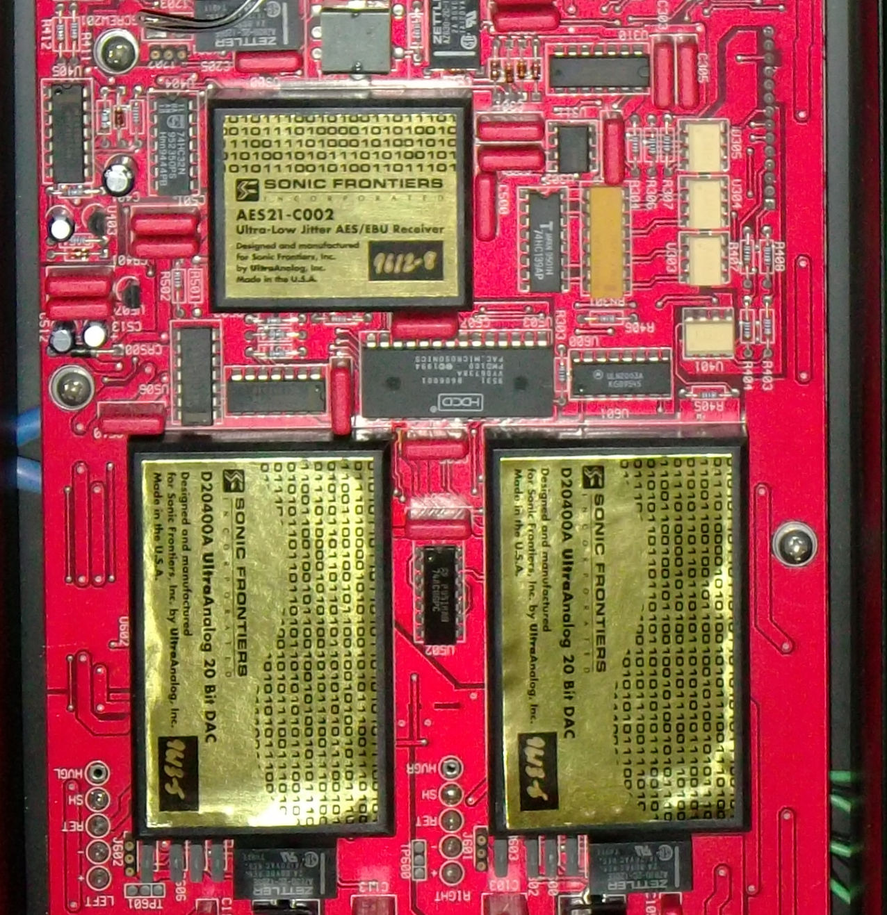

By all means. You have to have intimate contact between the surface you are mounting the heat sink on to assure good heat transfer. I've used thermal epoxy to good effect.
Here is a product that gets the job done:
https://www.ebay.com/itm/124519336627?h ... SwpNVf-IJw
To assure a long DAC service life, as but one example, I heat-sinked the Ultra-Analog modules and Microsonics PMD-100. I fired it up and let it "cook" for a couple of hours and the heat sinks were definitely getting the heat of the cores of those devices.
Since the DAC is well ventilated, because of the tube output stage, the heat from those devices gets up and out.

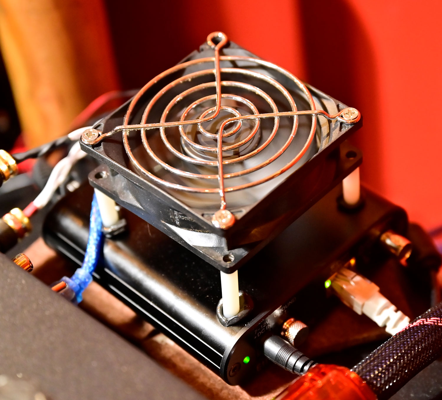

PostPosted: August 11th, 2021, 6:34 pm
I put a 12vdc computer fan next to the “hot” device and it lowered the surface temp from 118 to 85 degrees F
Now I have to listen to see if anything changes

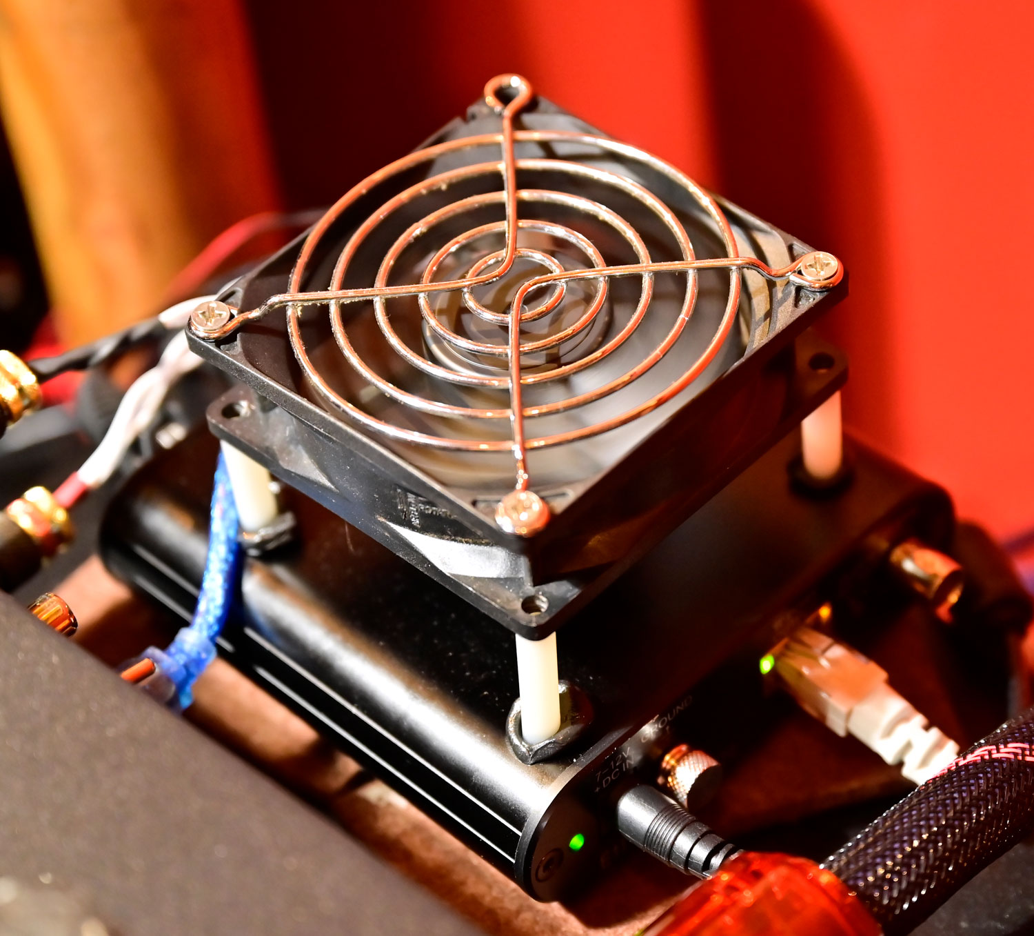

This is the almost final solution
Keeps the Uptone Etheregen very cool.
I isolated the unit from the casework and the unit is isolated from the richlite shelf
the etheregen has a standard switch on one side and a special port on the other for your music server/streamer on the other.
you can hear the unmistakenly positive difference from moving your streamer from the standard switch to the special switch port. Its hard to believe but its there.
Is it worth $600? only you can decide
