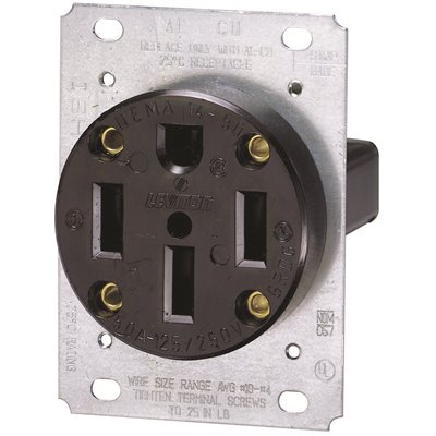

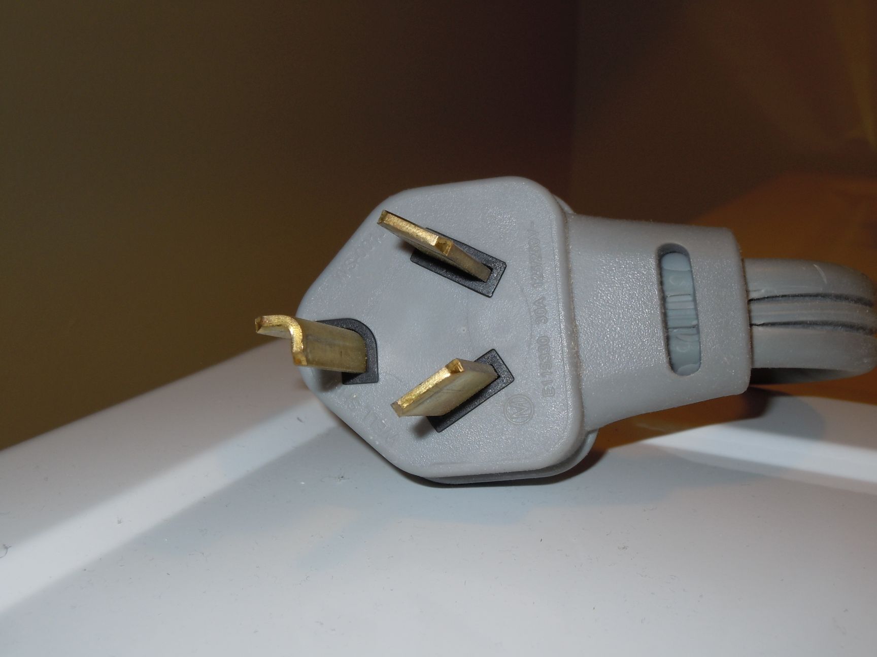

Stuart I totally agree with you on planning for future development. That is why I'm specifying a NEMA 14-50R receptacle in my garage for the electric car charger. It is a 4 wire connection even though many of the car chargers only have 3 wire plugs. Here are photos of the NEMA 10-30P plug on my current dryer which has largely been superseded and the newer NEMA 14-50R
I know you meant 14-30R, just being a dick. Hey, you'd do the same for me! :lol:
