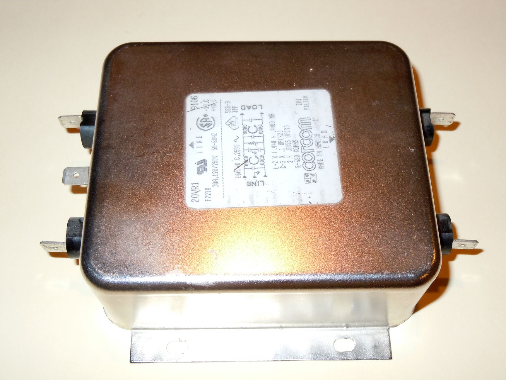

As far as using a balanced transformer for noise reduction, some of them will reduce noise to a minor degree, but a good noise filter will reduce the high frequency noise far more with less power reduction and for far less money. If you are worried about hot line to ground safety, an isolation transformer is the solution. If line noise is the primary concern, a noise filter Here ae a cpouple of links you might find interesting:
http://www.te.com/usa-en/products/emi-f ... lters.html
https://product.tdk.com/en/products/emc ... uct_08.pdf
https://www.onfilter.com/ac-power-line-emi-filters
I have sucessfully used the Corcom filters in power supplies that I have built. Here is a photo of a 20 amp version. Note that it hase two common mode chokes, four capacitors and a resistor inside the shielded case that is like a small brick. It will blow away any isolation transformer I have ever seen as far as noise but provides no additional safety for line to ground shocks.
