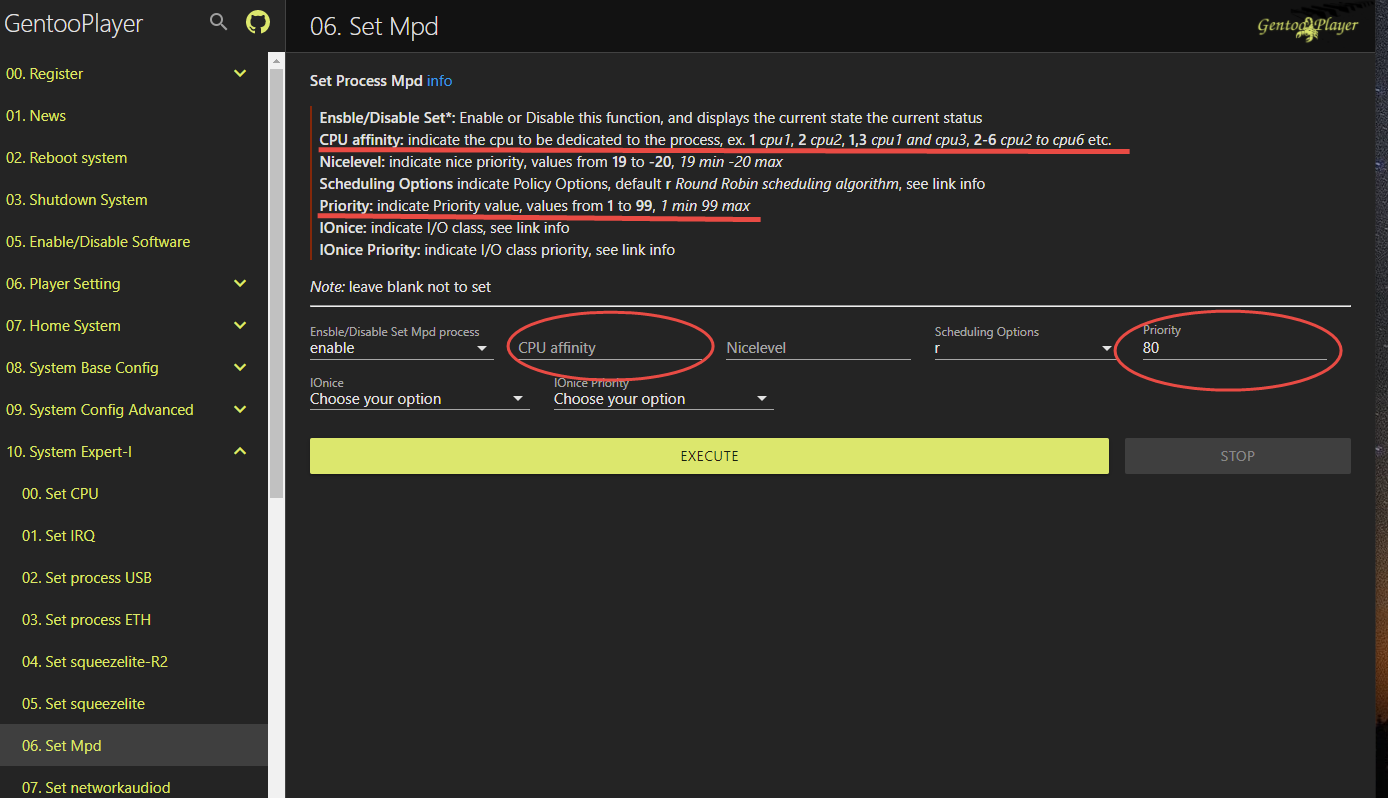

Grover,
If you NUC has only 2 cores, you can try setting the CPU affinity for MPD daemon and also a high priority value.

Grover,
The RPi3B module has four cores. I was able to set it to Profile 1, thanks.
