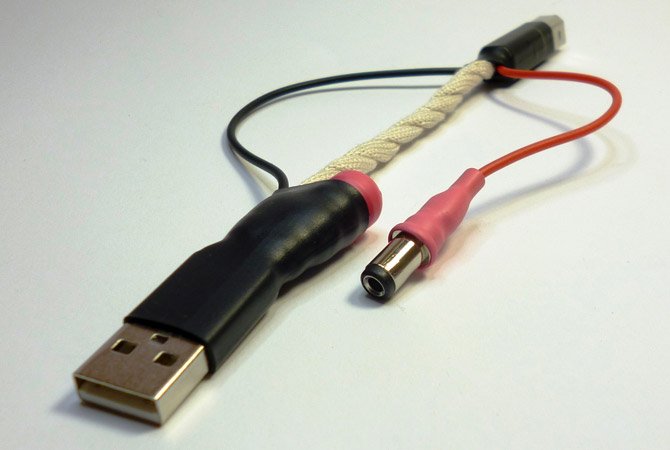

I bought the Elijah Audio cable. Listening to it again now.
ETA: ...and I remember why I don't like it. :-( Dry and compressed sounding.

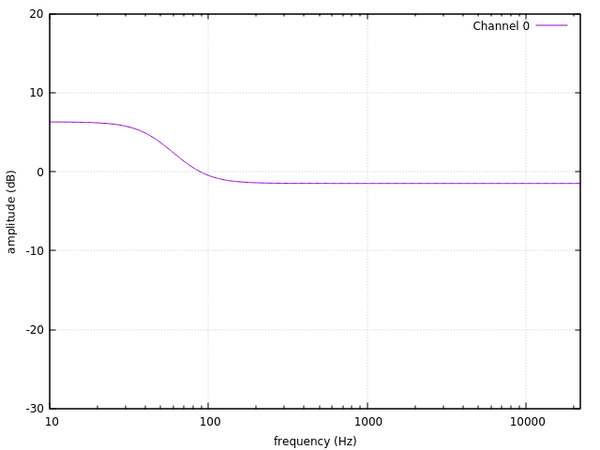

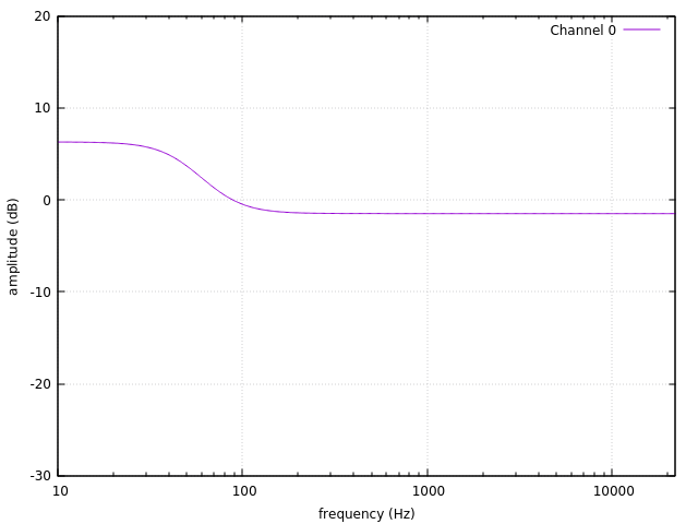

For linux users there is a project on github of interest -
https://github.com/bmc0/dsp/wiki/System-Wide-DSP-Guide
the documentation is not great but what I think it is doing is providing a simplified command line front end for alsa programming. Note that there is a plot option (via gnuplot) to plot the frequency transfer function of whatever dsp processing you implement. for example the command -
dsp -pn gain -1.5 lowshelf 60 0.7 +7.8 | gnuplot
produces the plot -
