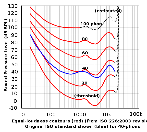

Look at the equal loudness curves and it will become clear why a rising top end may sound OK at low levels but will be offensive at higher levels. Remember loudness controls that used to be present on every integrated amp and receiver? Bass has an even greater change but excessive bass while objectionable will not cause as much pain.
