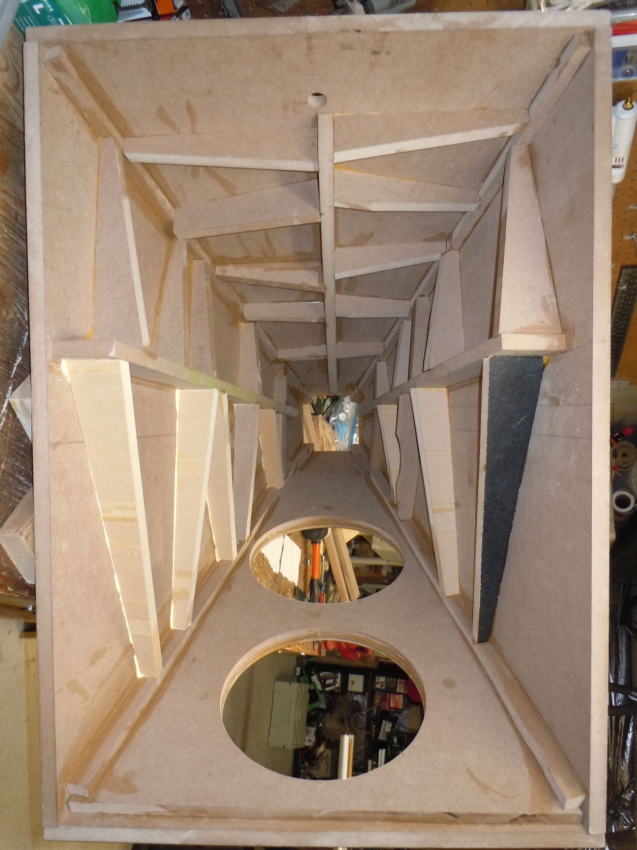

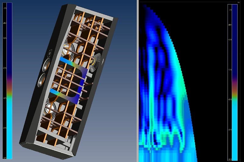

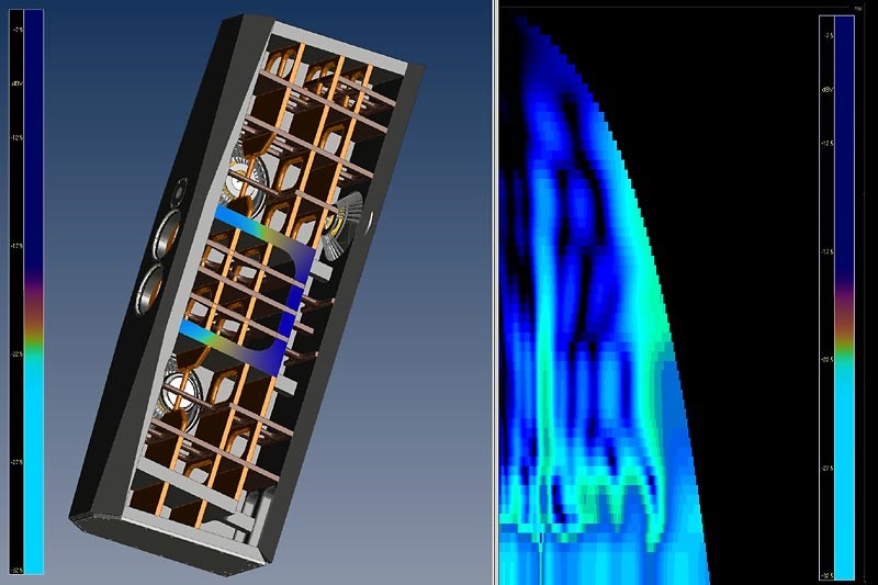

Using a constrained layer construction is a very good way to damp resonances as Walt says. However, it is more effective to prevent resonances before they start. Two ways to do that are to have the size and shape of the box such that you minimize internal standing waves at the frequencies that will be produced inside the box. The second way is to break up the surfaces of the box into various different sizes and shapes to prevent the walls from resonating at the frequencies produced. Many of the high end speakers go to great lengths to do this. Here is a statement from the German manufacturer Tidal:
But building our cabinets from TIRADUR and TIRALIT is just one aspect. Another one, at least as same important, is how it is designed even to the smallest details.
Our deliberately positioned and deadened supports, CAD simulated bracings and chambers avoid the swinging of the exterior walls and yet perfectly house all inner parts, such as they do control and air flow of the sonic and air compression just to name a few.
I'm including a photo of the bracing in one of their speakers. Also is a photo of my attempt to break up the sections of the truncated pyramid I will be using for the bass section of the eggs. Note that the sizes qand shapes of rthe walls are broken up by the random spacing and angles of the attached ribs. Not in that photo is the cross braces to provide cancellation of expanding and contracting forces on the two large side walls.

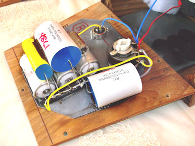

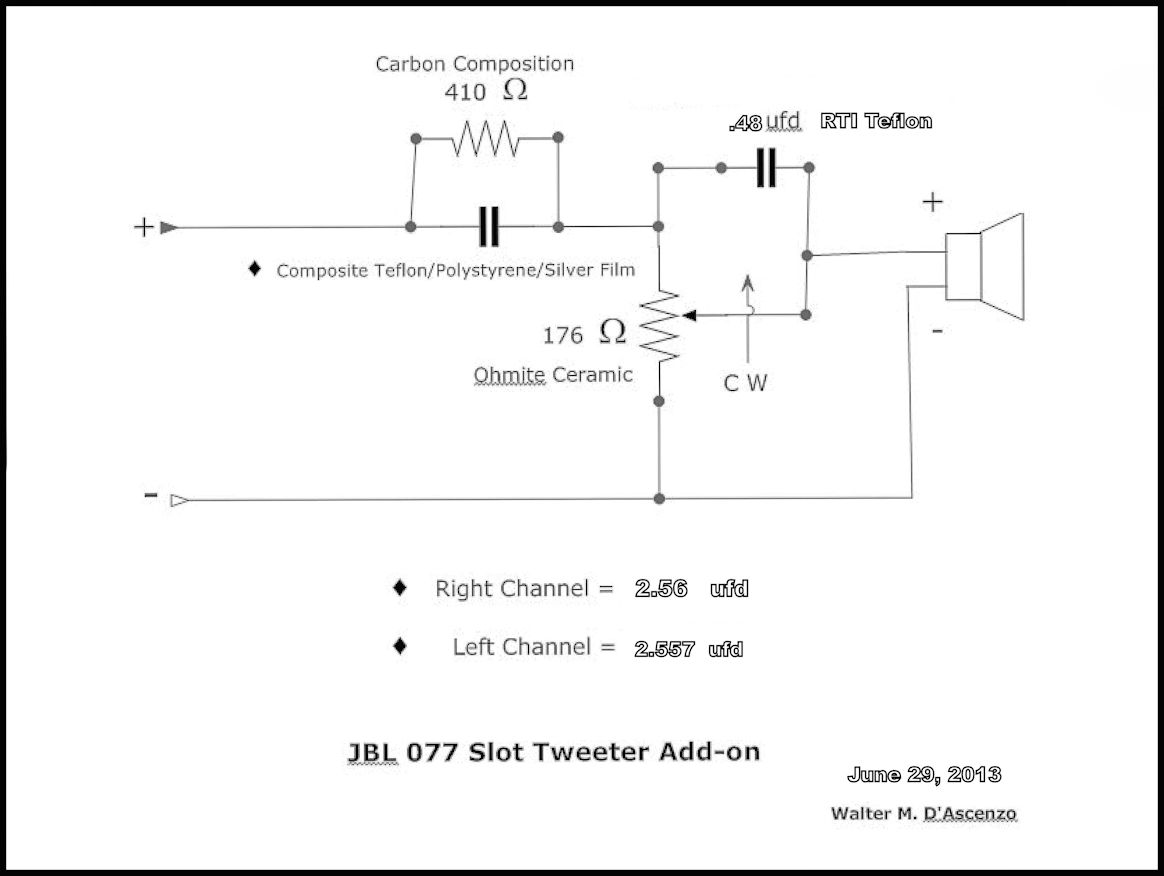

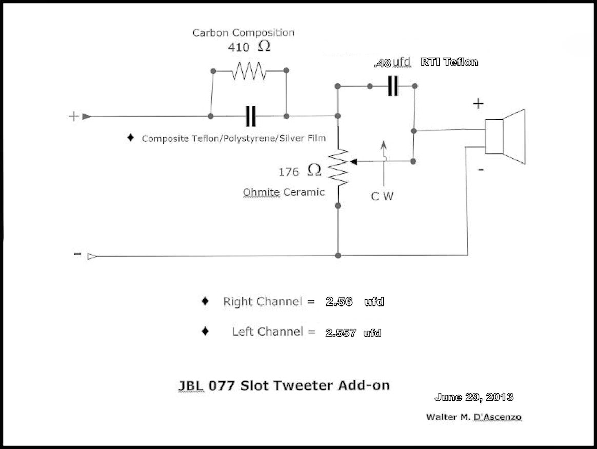

GaryB wrote:
SoundMods wrote:Here are two photos of one channel -- front and rear views. These photos do not tell the tale however. Just what you see when listening to music.
Walt,
That's a nice looking system. Can I ask what tweeters you're using in those pyramid shaped boxes? They look like they could be JBL 2405s. I'm curious to know where you cross them over and at what slope. I've always had trouble integrating super tweeters in horn systems but I've gotten best results with steeper slope crossovers. But often I just skip it and let the compression drivers naturally fall off or perhaps give them a gradual boost in the crossover.
Thanks in advance.
---Gary
They're 077s. Just 6-db/octave and I used a capacitor decade and my RTA to dial in the crossover value. When the Altec horns and JBLs met in the middle then I went about dialing them in terms of overall sound quality. If you'll notice in the picture they are time aligned with the big horns. The cool thing about the add-on tweeters was that I got the expected extension but they had greater impact on the quality of the mid-range. The mids seemed to open up more with greater transparency. Nice!
