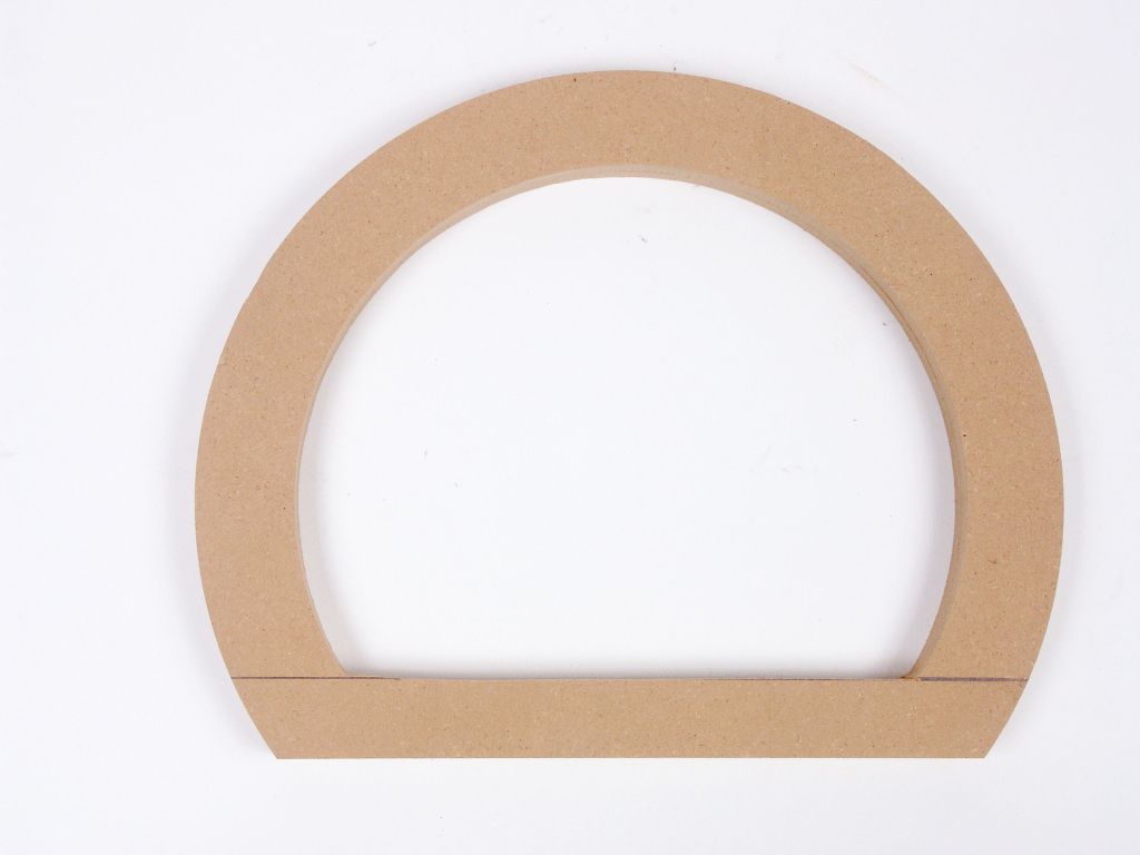

The reason I'm not farming it out to an NC router is that it will be for a magazine article to show people how to do it if youdon't have access to advanced machinery.

This is not going to be a horn but two direct radiating drivers in an egg shaped enclosure. I'm including a photo of the egg portion of the old Mach 17 speaker that was the inspiration. Even with CNC machining you would still have to do two haves because the inside is hollow. I'll have a write up in AudioXpress later this year of the whole project. It is the most involved woodworking project I have ever done. Definitely not a novice project. I'm also including a photo of one of the "D" sections that stack up to make the egg.
