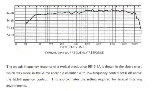

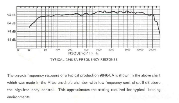

You are right, 511Bs are not designed for home use but they can be adopted with an attenuator network. Altec did adopt the sectoral horns in several models of studio monitors. Here is the frequency response chart of my speakers 9648-8a.
http://www.lansingheritage.org/html/altec/specs/pro-speakers/9846-8a.htm

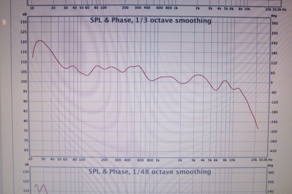

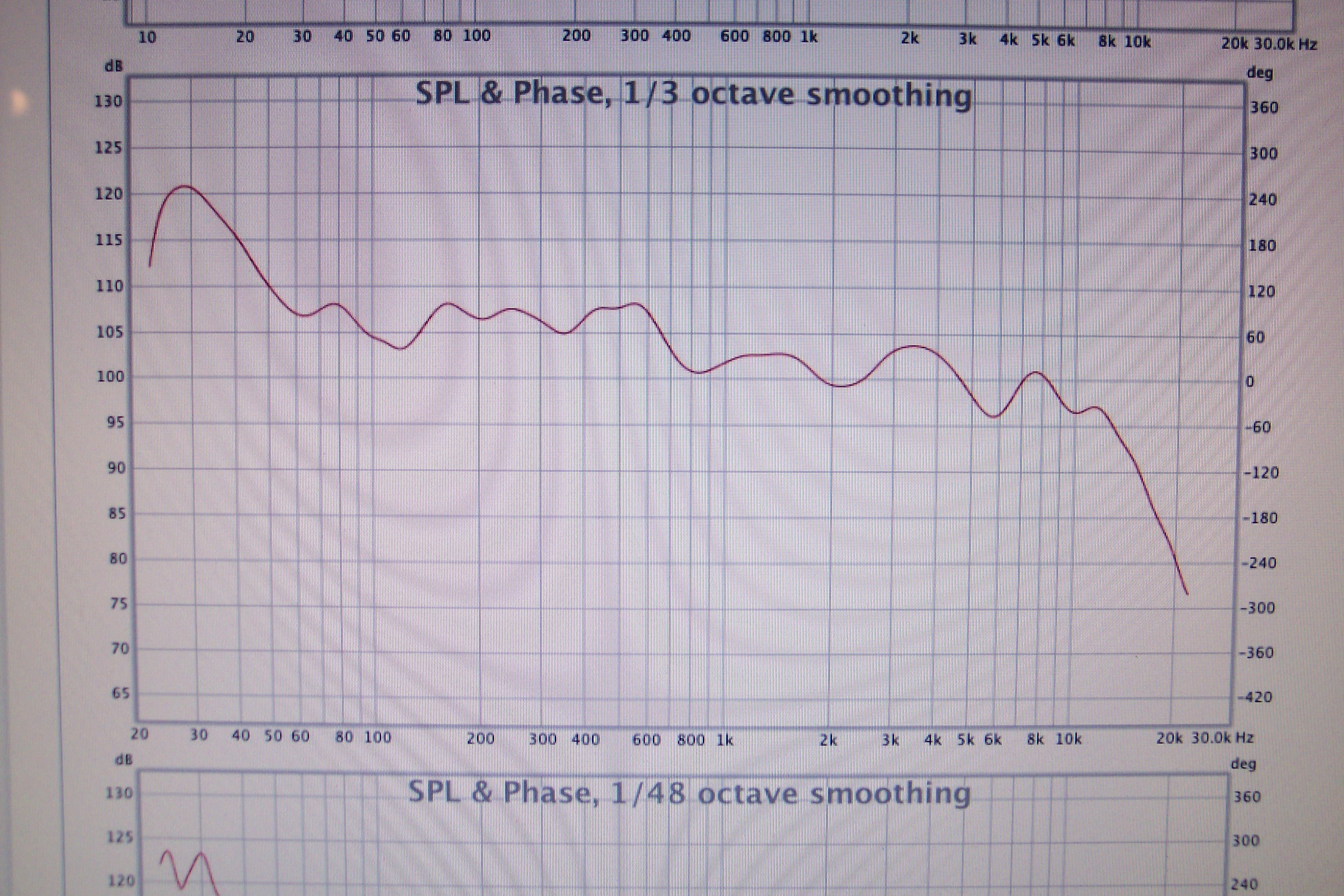

PostPosted: May 29th, 2017, 5:18 pm
Posts: 1185
Altec A-5 with jean Higara crossover
Subjective impressions Vs response curve (ignore low freq, guy is using horn loaded subwoofer):
Quote:
With the Hiraga crossover circuit and top performing capacitors, the overall sound has a directness, immediacy, timbre, authority, nuance, ease and musicality that engage the listener, and don't let go. Further, these speakers are capable of producing a big sound stage with great width, depth, nuance, localization of instruments and voices and a great sense of space. The Altec Lansing people knew what they were doing.
full bodied, rich, directly engaging, punchy, present, immediate,smooth, sweet, musical, articulate, and nuanced, with a big sound stage, pin point localization of instruments, and lots of space. The sound stage lies well behind the loudspeakers.
Quote:
Looking at the smoothed frequency response plot below, and noticing the shelving of frequencies above the 500 Hz. crossover point, one might suspect that raising the tweeter level about 3 dB would give a better result. It certainly would provide a flatter measurement. However the system sounds best with the tweeter set where it is.
http://www.vtaf.com/id107.html
