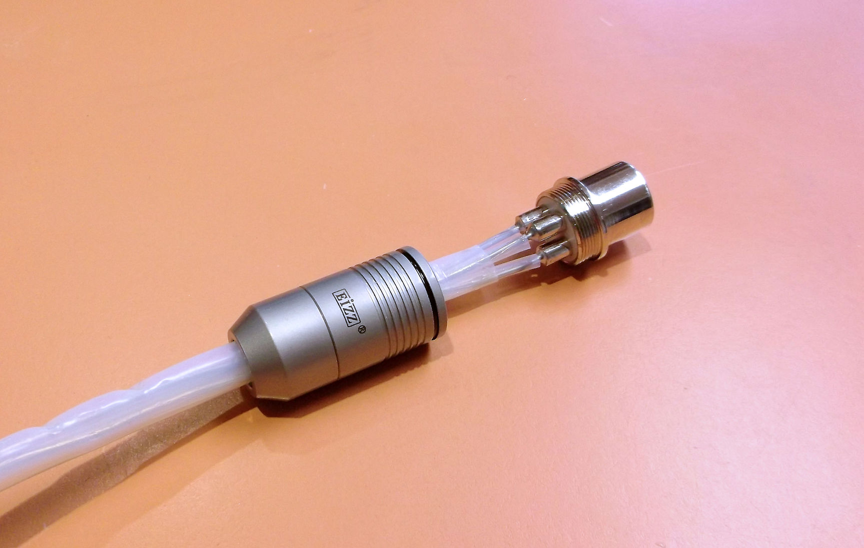

In terms of audio interconnects -- I went over to dark side at one point and loomed my system with Audioquest cables. Coffee, Fire, WEL Signature cables that had cold-welded connections and battery-bias on the dielectric. I had an idea for my own interconnects made from dead scratch. Not re-terminated mil-spec or industrial stuff but from scratch -- including the conductors, dielectric, and jackets and terminated with 37/63 Eutectic solder. It started out as an experiment, but turned out so well that I sold off my hi-end stuff. It just never lived up to to the science hype. I even tried the Stealth cable made with very thin Electum (a gold/silver alloy that occurs naturally) conductors suspended in a Teflon matrix. They did not make the final cut either. I made a .5-meter AES/EBU digital interconnect, a .75-meter analog interconnect -- DAC to per-amp, and a 1-meter analog interconnect -- pre-amp to power amps. They were a royal pain-in-ass to fabricate, but well worth the effort.
Anything can work well if properly executed. I once worked with a tech that came to us (SHL Systemhouse) from General Electric Aerospace. Before he could be certified to work on their stuff he had to attend an in-house course for soldering. A 6-week, 5-days per week studying nothing but soldering. Soldering is not as simple as some believe.
DIY ROCKS! :thumbup: Soldering ROCKS! :thumbup:
