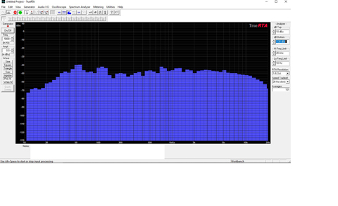

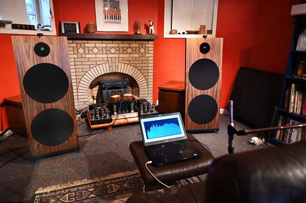

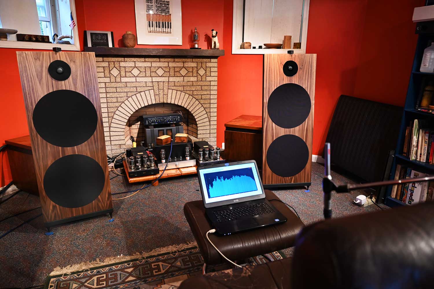

May 28th, 2020, 9:38 am
Room set up
Pink noise realRTA
