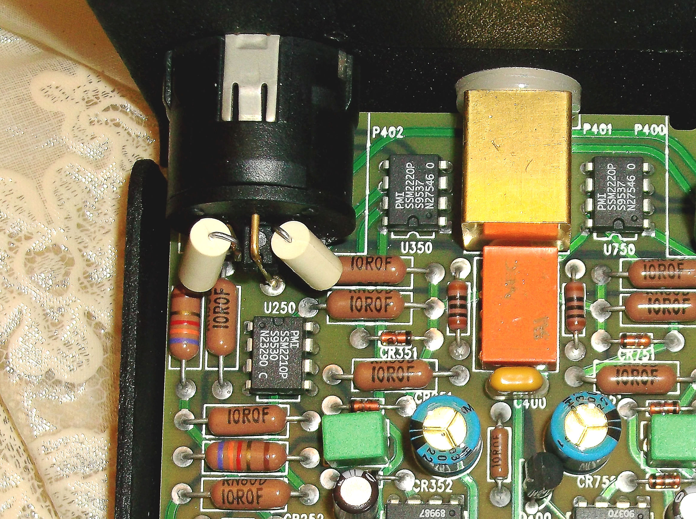

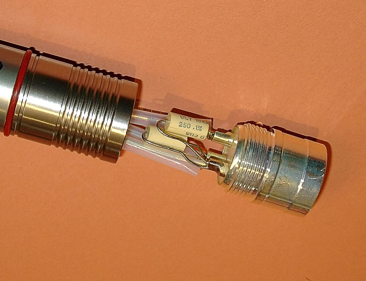

I forgot to include photos. Sometimes implementation of an idea is not as easy as it sounds. The adapters were not a big deal. The 36S DAC had no room on the PC boards to insert the 250-ohm bobbins at the summing point of the differential amplifiers. The XLR output connectors provided the placement needed to pull it off.

Precision WW resistors come in very small packages, down to the size of 1/4 or 1/8W resistors, if you decide to build that thing in.
Putting it in an XLR shell is a good solution though.

They are really not classified as wire-wound resistors as most people know them to be. They are quite different from wire-wounds whether non-inductive or not.
They are classified as Bobbin resistors because of the back-to-back copper bobbins. They especially measure better than the best non-inductive WWs with self-inductance in the low uH range. Then -- being fabricated with copper wire as opposed to the typical WW Nichrome wire they serve the music in ways the Vishay guys can only dream about.
As far as building the Bobbins into my BAT pre-amp -- that would be cool if there was a way to do it. To make it permanent I would want switched resistance selections kind of like a MC phono stage. Unfortunately, the BAT has 10# of crap in a 5# case. It would take some serious butchering to pull it off. So -- high quality XLRs get the job done. At least it's a permanent DAC improvement.
