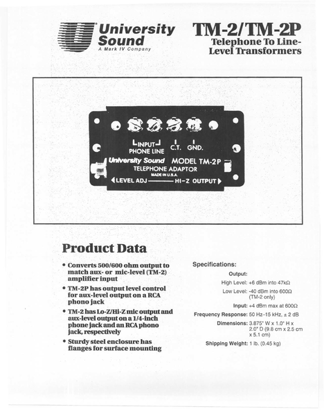

Posts: 308

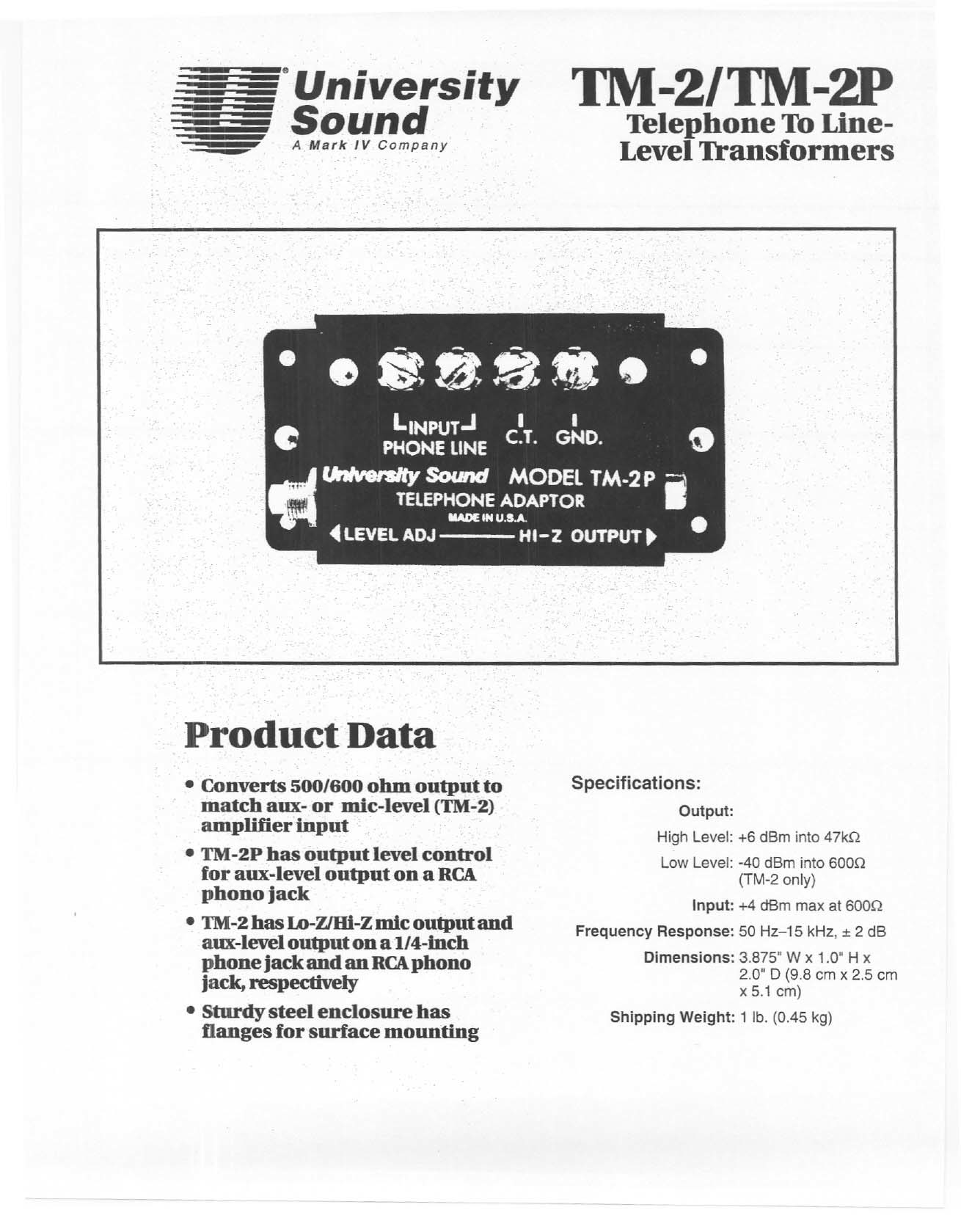

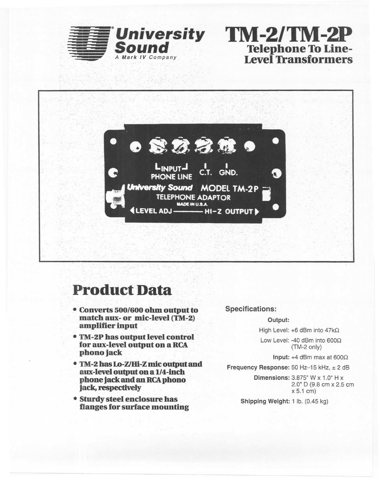

Could it be the baby mama to this? See attached....
Stromberg Carlson, one is labeled 45753, the other is labeled 45752-000 and TM-2 on a second line.

Posts: 1735
I don't think so... The ratios aren't right. 600:47K is 8.85:1, the transformers I have definitely have more s/u than the Altec 15095s, and they're 10:1...
