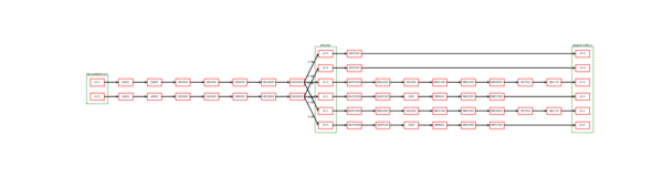

It turns out that Camilla is easy to program. I have generated the yml file for my cbt36k speakers and have done some prelimiary testing (not on the cbt36k's). Here is the filter pipeline for the cbt36k's -
Filter types (my naming where the number is the center frequency in Hz to distinguish between the filters):
LS - Low Shelf
HS - High Shelf
PAR - Parametric
LRLF - Linkwitz-Riley Low Pass
LRHF - Linkwitz-Riley High Pass
I have attached the yml file for this pipeline (I find I cannot attach a yml file. Where do I find what file extensions are allowed?). See the yml file to see how filter is defined.
