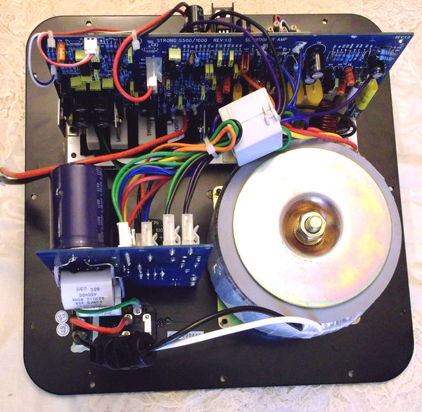

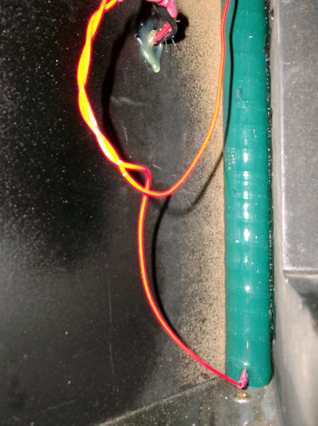

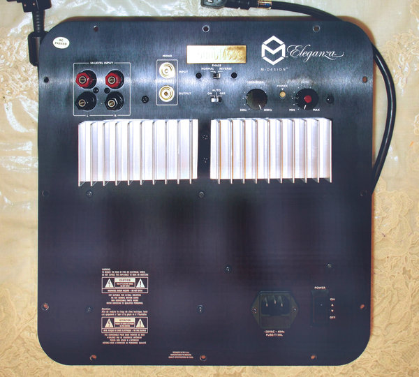

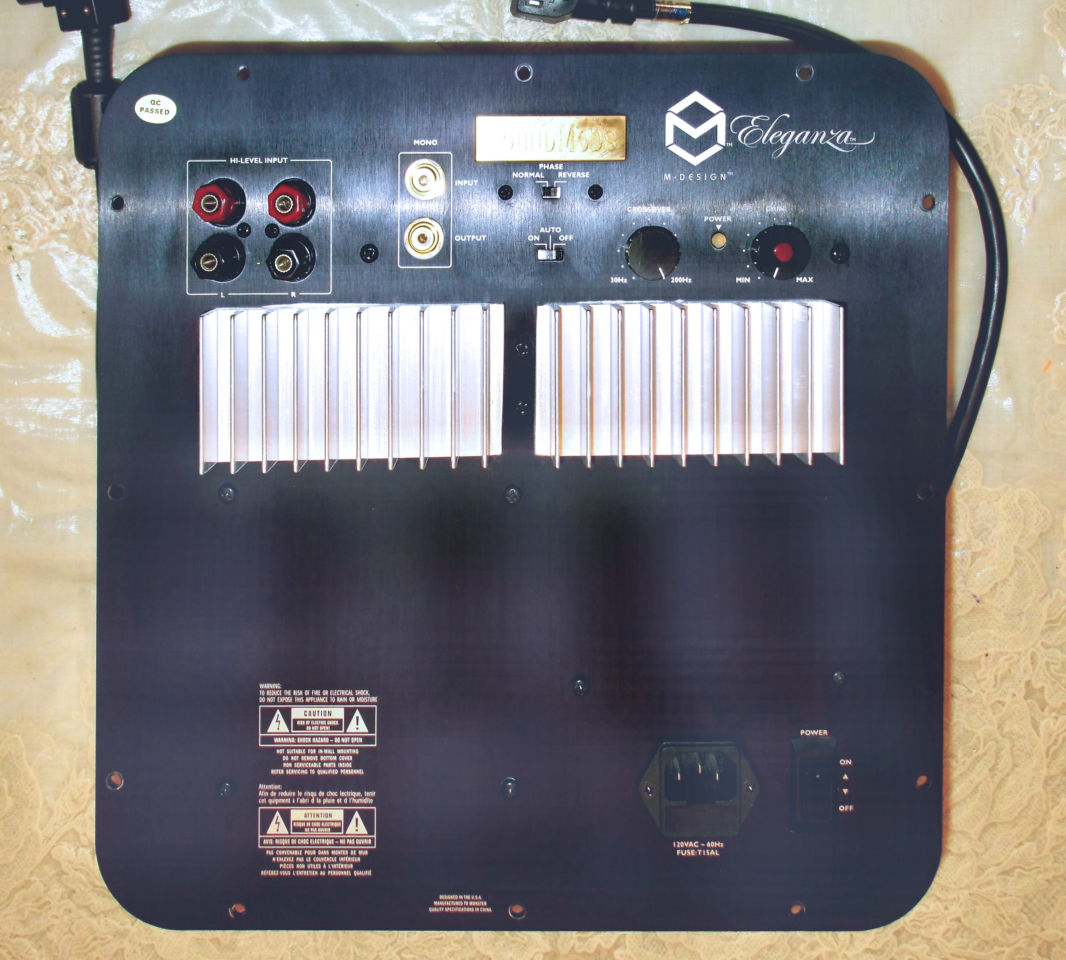

As it turns out -- I found that the older Dayton amps. did not like to drive impedance's below 4-ohms and they didn't have enough heat removal in terms of external heat sinks.
I believe their current products should drop in to your subs with no problems. In my case I added a 1-ohm resistor in series with my sub and added heat sinks. It kicks ass and takes names.

I see those film bypass caps in there, Walt......you can't fool us. :wtf:

Busted! ;)
