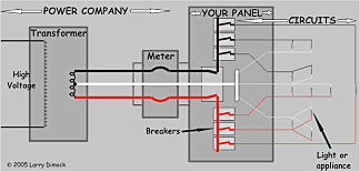

A point of information -- a different outlet is not a different circuit -- it is typically only a different circuit-breaker protected feed off of the same circuit.
Now if he can try to see what receptacles are on which 240-volt pole they are on (the left side of the panel-board vs. the right side) that may help. At least if one amp. is on one pole and the other on the other that puts the amps at opposite ends of the service-entrance transformer. A speculation at best -- but what the hell -- it may be worth a try.

Residential breaker panels don't put the two phases of the 240V line on opposite sides, they put them on alternating slots in the panel so that two adjacent slots can be used with a two-pole breaker for 240V loads....
That's right -- but we're talking about single-pole that's derived from one pole referenced to neutral. 2-pole breakers for 240-volt service will connect to both poles. Granted the single-pole protected feeds alternate as you drop down the panel from top to bottom - one pole to the other, but one can choose (with a bit of effort) one feed on one side and one feed on the other side and hope that the alternate receptacles are near enough each other for the trial.
