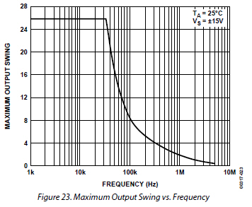

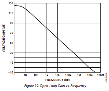

You can use the OP27 for both stages but give up some minor amount of distortion at the highest frrequencies. Whether or not that would be audible is questionable but since both devicces have the same noise specs and price why not use the OP37 in the SUT stage? I'm including the gain vs frequency and output swing vs frequency curves for both. The OP27 curves are in this message and the OP37 curves in another because we can only atach three files to each message.

Here are the OP37 curves.
