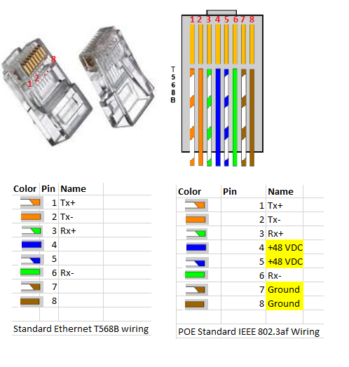

POE goes over pins 4,5,7,8
I do not think the suggested Ethernet surge protectors would have helped Roscoe.
The spike that killed his equipment probably came over the other conductors
Re: Down time...
September 12th, 2023, 10:56 am
