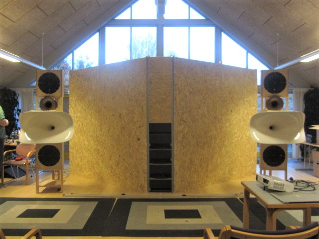

Finally, given that it is a round horn, it may be a L'Cleach horn, quite popular in hifi circles. Jean Michel worked out the math for optimized terminations of the horn mouth to the free air. Generally, this is a critical point for horns. Poor termination leads to a plethora of mid-to-high order modes caused by reflections back from the mouth to the walls of the horn and the driver, visible in the horrible HF waterfall performance of the Altec 511 I posted earlier, for example. This is how the real (acoustic) ringing of horns is brought on. Major time smear and dispersion anomalies ensure.
The L'Cleach termination adds a lot of material to the edges of the mouth. Here's a pic of an Iwata profile horn with JMLC termination that we set up at ETF in Denmark last week. That I believe is a 500hz horn, but could be 300.

In any case, there may be very good reasons to use a 3' horn at 1200hz crossover but I think it could be done with less drama. Many pro 1200hz horns are like 8" wide!
