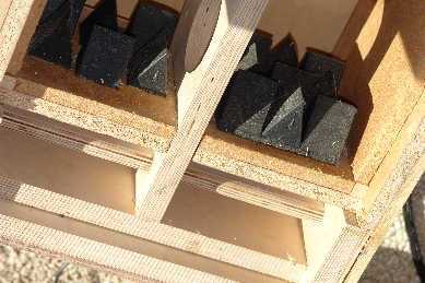

Tom's Eggs got me thinking about eliminating the parallel surfaces in the cabinet to reduce resonances. But that would be impossible to do without significantly reducing the volume. Came across this website which talks about using Anechoic Chamber type rubber wedges. Want to try out wedges and light acoustimass type of stuffing. Could not find the rubber wedges online. Anechoic wedges are too big and too expensive.
http://www.tnt-audio.com/clinica/speaker_design_pt3_getstuffed_e.html

Looking for ideas of making the wedges easily without breaking the bank. Thinking of 1"x1" base and 2" tall wedges. One idea is to use sculpting foam. Any other ideas?

Don't even think about it, Shashi. Besides eating up volume, foam rubber is very reactive. You will not get the end result you desire. Also, polydacron is reactive as well. Wool and/or fiberglass is what you want.

The wedges help in two was as far as I understand. By diffusing the sound waves they a) delay the arrival of the reflected waves back to the cone effectively making it seem like a larger enclosure, b) the waves will be reflected within the cabinet several times and only a small fraction of them at much lower intensity arrive back at the cone, again making it seem like the cone is in a larger cabinet.
I want to glue the wedges to the all internal walls starting at the back wall and then add the wool stuffing over them. What ever waves pass thru the wool stuffing, are scattered instead of bouncing straight back to the cone.

Here is where things get confusing for the novice. As Tom pointed out you can only go so far with a sealed box. For Edger Villchur to get down to 42-Hz. before it started to roll off in the bookshelf size box (AR-1) he used a woofer that had a free-air resonance of 5-Hz. My system has a vented box that I changed to what I call a "half-ass" transmission line. I mass loaded my woofers to get a free air of 15-Hz. I get output flat to 31-Hz. by virtue of the vent reinforcement and the longer path from the back of the woofer to the vent. The roll-off beyond 31-Hz. is so sharp it kind of "rains on the parade" of deep-bass performance. Or put another way -- Mother Nature (physics) does it her way or no way.
The acoustic fill is a "game." You cheat Mother Nature into "thinking" it's a bigger box to get the box resonance down. That process is where the sound off of the back of the woofer is converted to heat by absorption. To optimize that absorption you not only need to perform trials with different densities to dial it in but also use material that is not reactive. Meaning that it won't push back (create undesirable resonances).
Then there is the enclosure. The stiffer the better. You can brace it like Tom has demonstrated or use constrained-layer damping on the outside to save interior volume.
There is no quick fix. Fitting the box with anechoic wedges will not change the resonant behavior of the box other than pushing the box resonance up rather than down and causing unforeseen problems with the overall playback quality.

This might give you some ideas:
https://www.bing.com/images/search?q=So ... ORM=IRIBIP
They are solid, not foam!
I have heard of people putting this type of diffuser on the back panel inside the speaker, although I don't really think these things work with low frequencies as well as they do with midrange frequencies.
