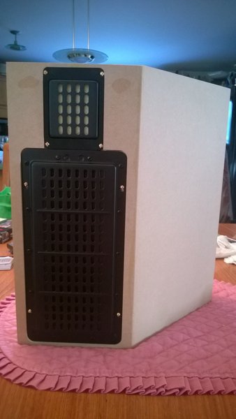

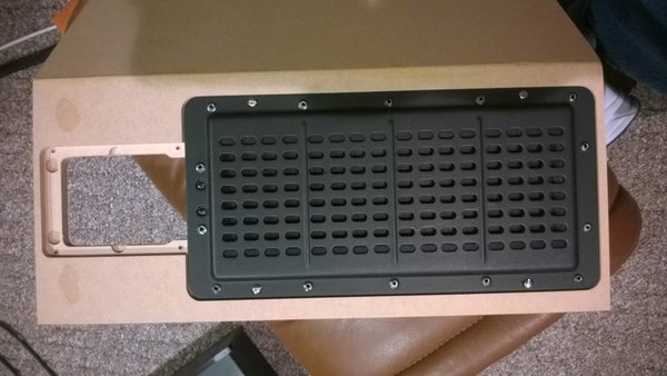

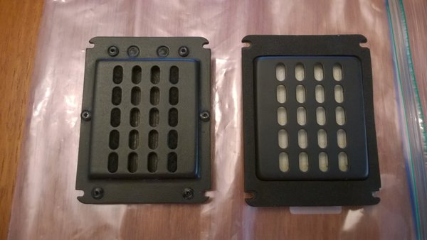

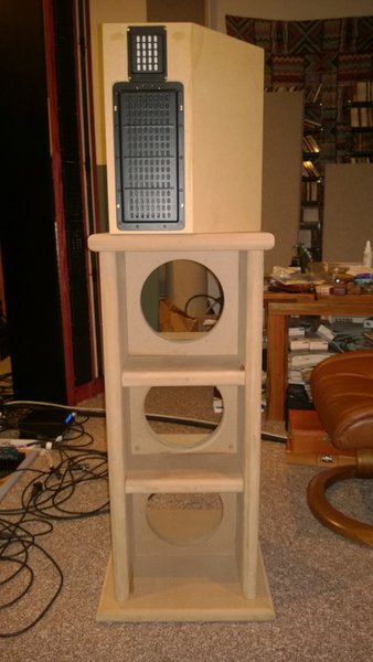

Here are some pictures of the small open baffle planar speaker with a 3x8" servo sub array as stands.
This is one of my test baffles for the planars. The GR Neo3 and BG Neo10 are going to be installed for testing. Since there are new and old production Neo3's and Neo10's trying both to see if they are the same. The tweeters will be different, but the mids should be the same.

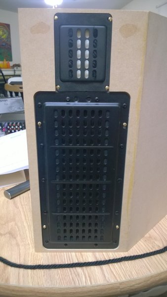

The Monolith test baffle with the new GR Neo3 and BG Neo10 installed. Next for some wiring and checkout.

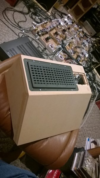

Posts: 943

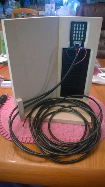

The planar mid and tweeter are wired and ready for testing. The 14awg polyolefin insulated wiring has been very easy to work with for the drivers.
Now to connect up to the Parasound A23 and see if we let out any magic smoke. If not, measurements.
Next is wire up the two 3x8" servo sub arrays and HX300 amps.

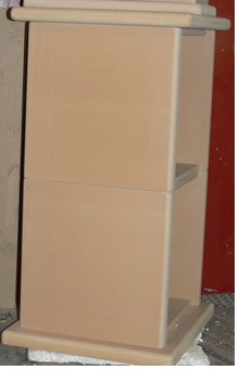

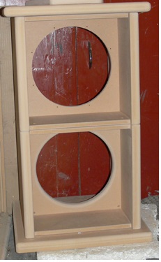

Pictures of the modular 2x12 open baffle H-Frames servo sub cabinets dry fitted before packing and shipment to me for glue-up and speaker install.
Connectors and wire are here, so will be doing this after CAF2017 this week.

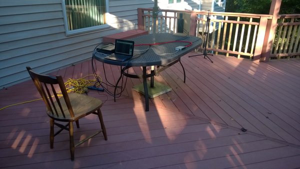

The weather was good today, so did measurement tests outside with the moded GR Neo3 and new production BG Neo10 on my test baffle.
These were far field gated time measurements on tweeter center axis using Pocket CLIO and calibrated mic.
Now to build a digital crossover and see what happens.
