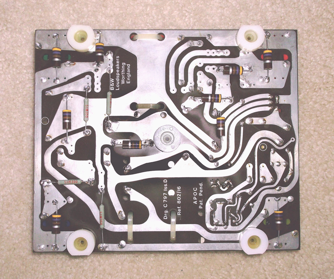

Attached are the photos of the upgraded crossovers. You’ll note that all but two capacitors were exclusively polycarbonates (ear-tested for the project) with hermetic Teflon bypass caps in the tweeter networks and WIMA polypropylene used as much reduced value shunt in the mid-range networks. You will note the small form factor Electronic Concepts caps designed for Mil-spec switch-mode power supplies and glass hermetic polycarbonate and Teflon caps designed for only God knows what. And my favorite tweak is the use of clamping resistors on each every capacitor and inductor to assure that those resonant reactance’s do not have snow-ball’s chance in hell of enabling those resonances.

I also had to coach him to add restrictive vent holes in his mid-range modules to relieve the cavity resonance. His comment after the drilling:
“Here's my take, and hoping it's not a placebo effect, it's akin to taking the lid off a jar containing sound. The result is a completely balanced sound field. Hard to believe two quarter-inch holes could make that much of a difference. I'm thinking about my skull next!”

Hi Chris! Whenever you have a capacitor and coil in series or parallel you end up with a reactance that acts like a "tuned" circuit that resonates. These resonances drove me crazy some 20-years ago when I was dialing in a pair of speakers. When I did the math, the combinations created the very issues that I believed were mechanical. WTF?! So going back to basic electronics theory I decided to try to prevent those resonances from occurring. It worked. When Dave Wilson and I first discussed the damping resistor scheme he poo-pooed it. Then two weeks later I get a call. He put one his crossovers on the the bench, installed resistors, and he remarked how the ringing issues he was trying to get rid of stopped. He used signal pulses and a scope to watch the results. He gifted me with his Wilson

Actually, you are talking about a first order 6-db/octave crossover. Second order (12-db/octave) has a high-pass capacitor with a shunt inductor, and a low-pass inductor with a shunt capacitor. Just talking about a two-way speaker right now but in the case of the high-pass and low-pass sections you have a series resonant circuit in action in both the high-pass and low-pass sections. Further -- even with a first order crossover it is easy to forget the speaker voice-coil inductance.

Second, I'm curious if you have any rules of thumb for the clamping resistors. I would imagine that one just takes the impedance of the cap or inductor at the crossover frequency and multiplies it by ~100x and that would take care of it. From the pictures, it looks like you use 470 ohms a lot with the occasional 5K ohm thrown in there.

My original testing about 30-years ago (when I figured out what was going on) I determined an ideal 350-ohms across capacitors and 500-ohms across inductors.
Since then I found that it is not critical but you do not want to go lower than 350-ohms across caps or lower than 450-ohms across inductors. There were no 5-Kohm resistors used in the B&W. The gray silicon wire-wounds were actually 350-ohms. The "5" was part of the part number.
