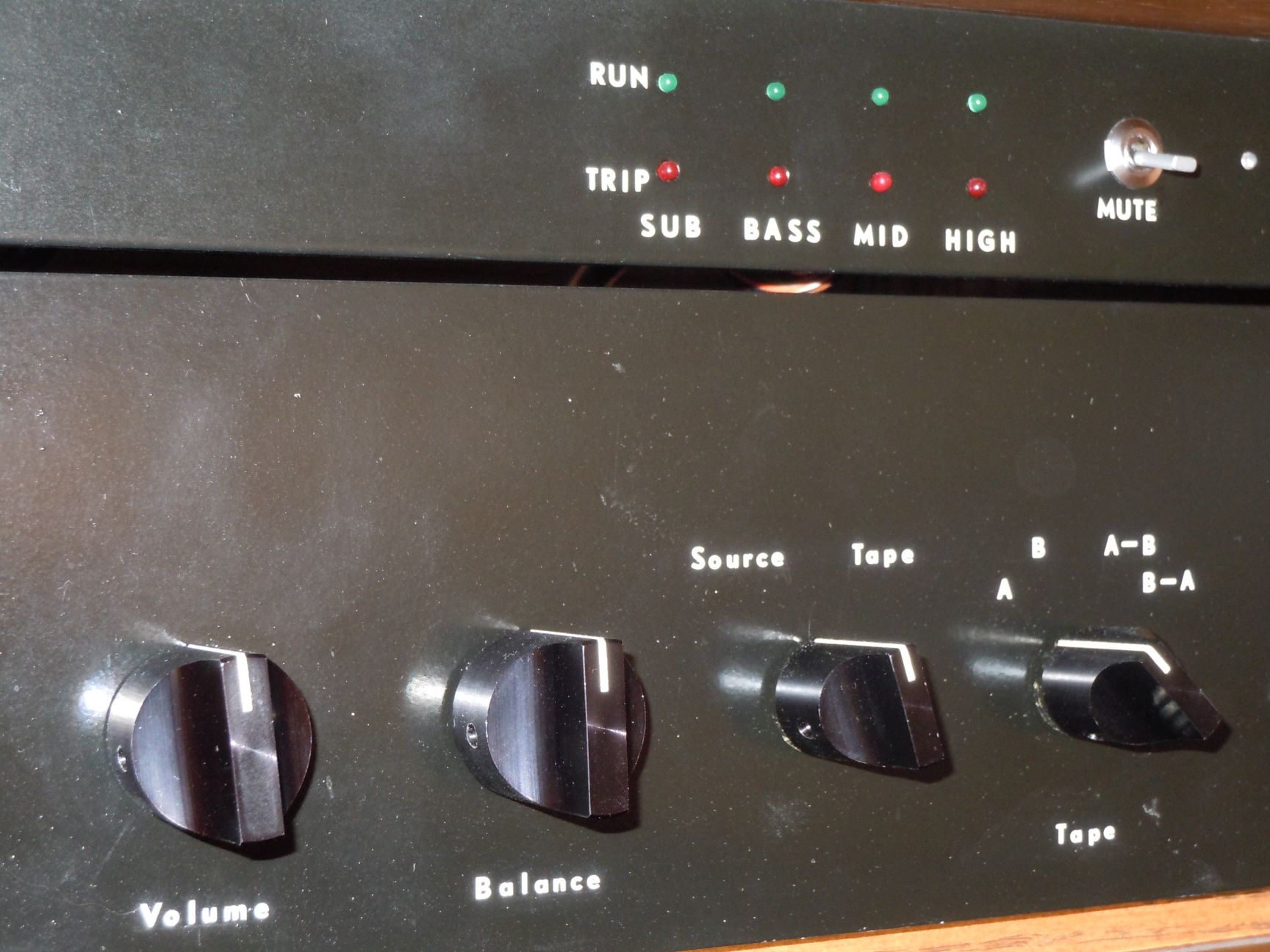

PostPosted: December 10th, 2016, 2:23 pm
Thanks for the link on the dry transfer type. I'm going to order some. I also found another source:
http://www.pcbsupplies.com/dry-transfer-lettering/
Here is a photo of how I have used the white lettering in the past. It's a good low cost option.
