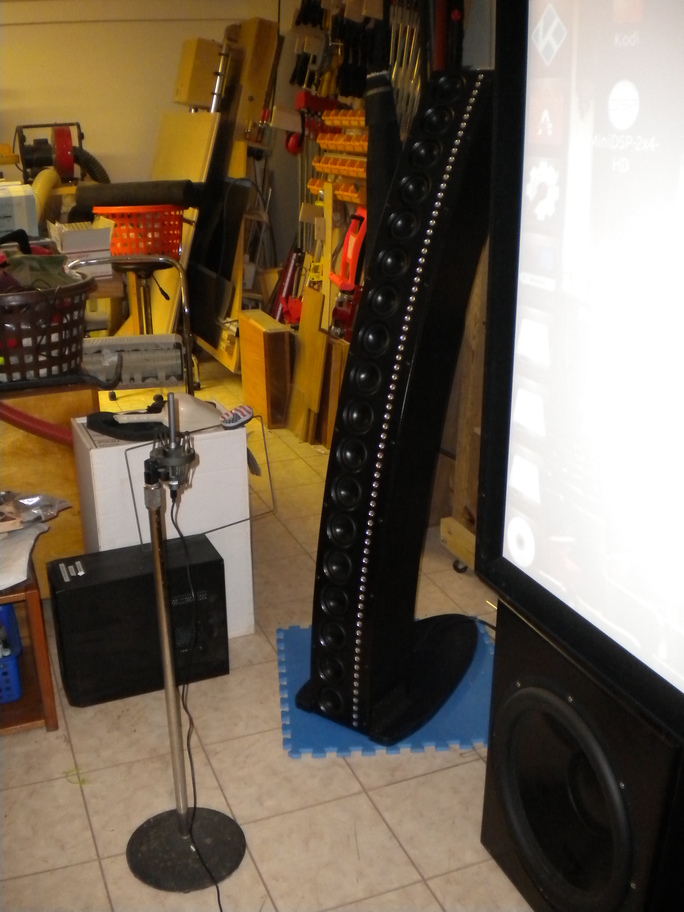

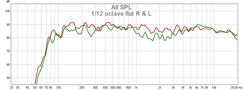

Finally have cbt36k together and working. Measured near field response (measurement location suggested by Don Keele) of left and right speakers with miniDSP configured for "flat" output response. 1/12 octave filter on measured data. Measurements made with miniDSP Umik-1 usb mic and REW software. cbt driven by 4-channel emotiva XPA gen3 amp. Subwoofer is off.

Not a bad room response. Curious upper mid range lower highs ther is a broad hole. I'm sure that correctable with the DSP
PostPosted: March 4th, 2017, 5:35 pm
I sent the curves to Don Keele. I waiting to see what he suggests.

Don Keele's suggestions which I will try -
Hi Alan,
Thanks for the curves! They don’t look to bad except for the differences between 1 - 4 kHz. I would suspect that the differences are due to left-right differences in room setup and environment and not speaker differences. To check this, just re-measure the left speaker in place and then simple swap the left and right speakers and measure the right speaker in the left’s position and see what happens.
Also here’s something else to try. Measure again an overall curve of the left speaker in the left position and then flip the polarity of the HF and then measure again (I hope you can just reverse the wires at the amplifier because you can’t do it at the speaker end with the Speakon connector or reverse polarity in miniDSP!).
With polarity reversed you should get a decent response null at crossover. If not, you can twiddle with HF delay (was 0.17 ms) to make the null sharper. This ensures that the LF and HF responses are fully in phase at crossover (a good thing!).
Also measure respectively the LF and HF responses (turn amp channel down or mute in miniDSP?). This will show the separate crossover LF and HF curves.
Thanks for taking these measurements!
Best Regards,
Don Keele
