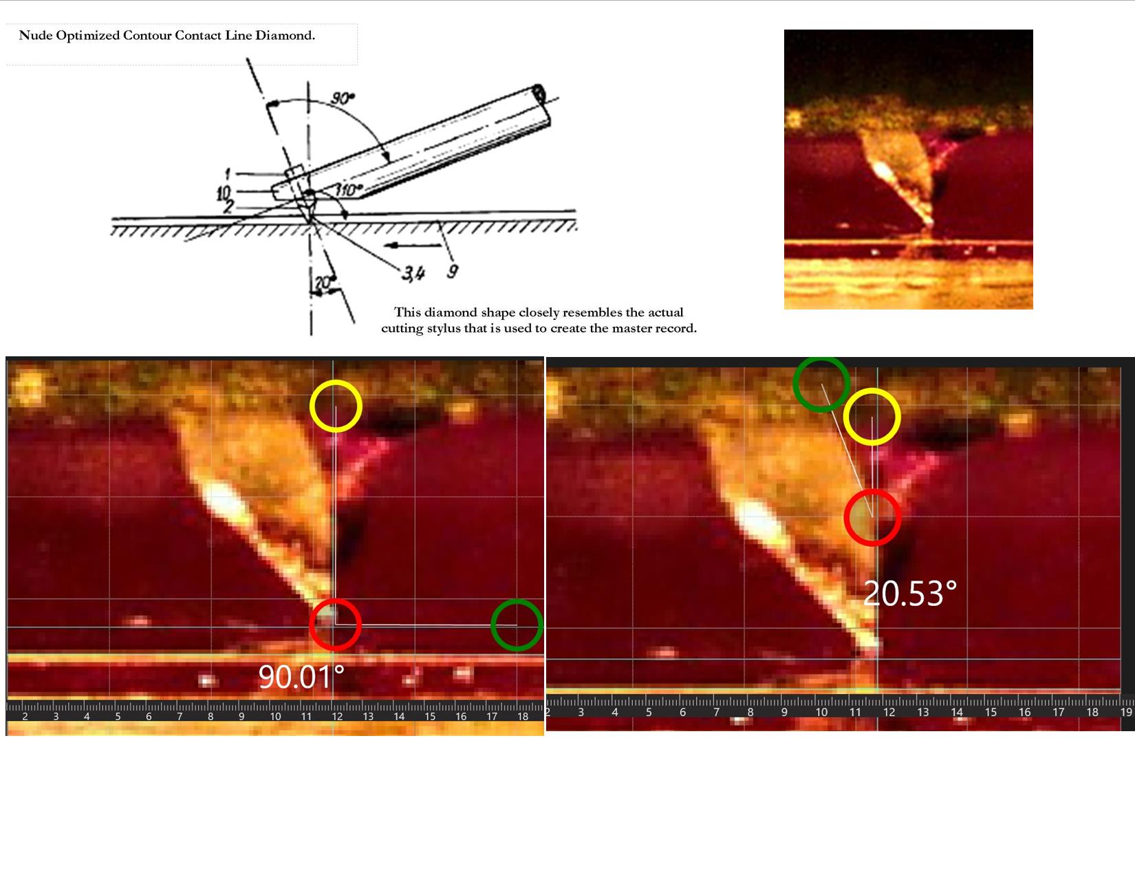

I first set VTA/SRA by listening. A very tedious process and I feel very imprecise. I found the differences I was hearing very subtle. My Stylus is a Peter Ledermann retyped Alpha Genesis 1000.
The diagram in upper left is from Peter Ledermann wbsite. Upper right is stylus down on mirror with 1.75gr weight.
Lower left is showing 90 degree ref and lower right is measuring the 20 degree angle shown in the diagram
So I might be close, who the hell knows but it was fun
