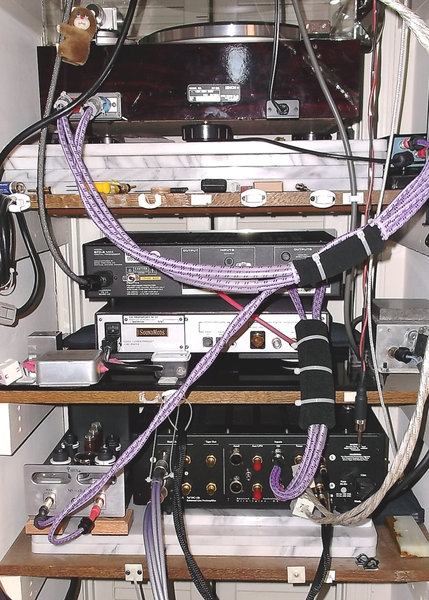

Extreme care, a thermal stripper, and very sharp single-edged razor blade gets the job done. Cardas silver RCAs work well with the Phaseflex. Shot gunning for a balanced line (XLR) is another issue entirely. I used gutted gender changers because of the available diameter of the barrel that can just barely take the twin cables.
http://www.ebay.com/itm/3-Pin-XLR-Male- ... Swr81UUZf~
And of course you finish with adhesive lined thick shrink tubing. Maybe my picture -- when you click on it to blow it up -- can illustrate the final appearance of the terminations.
