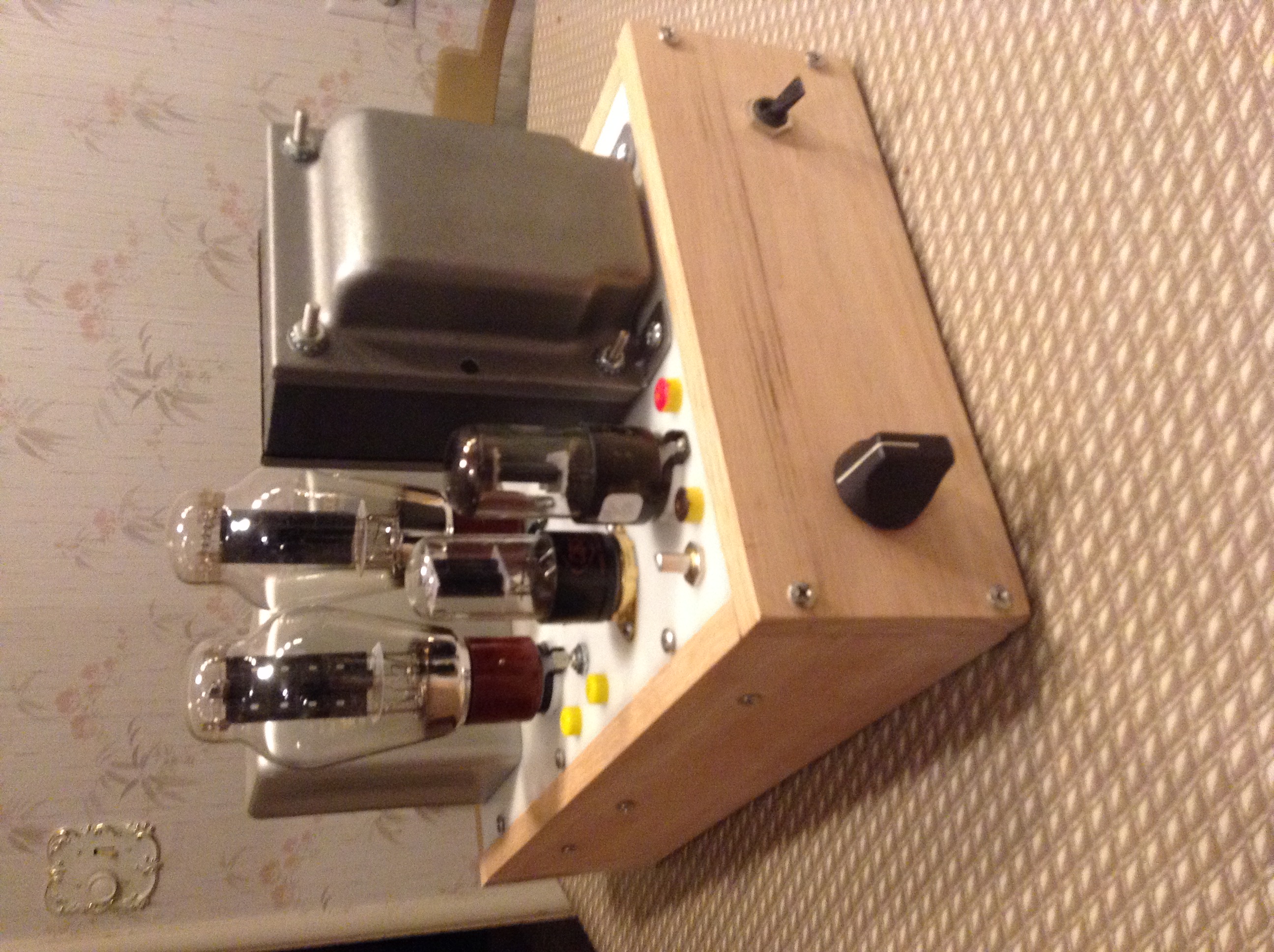

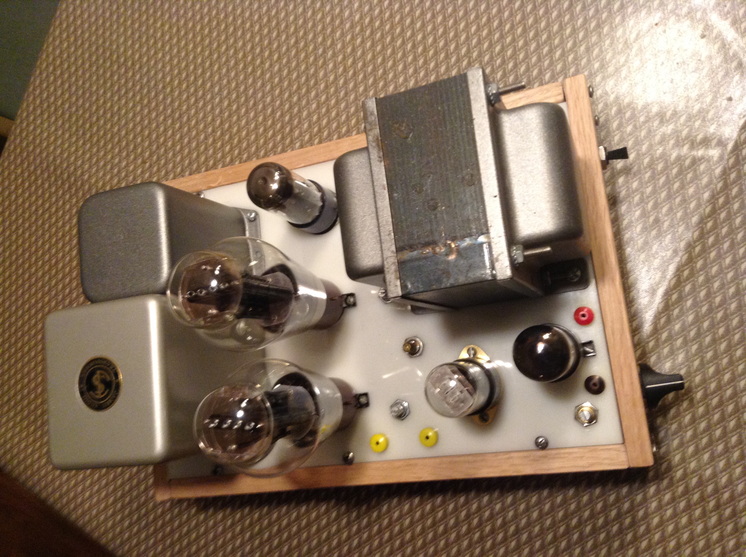

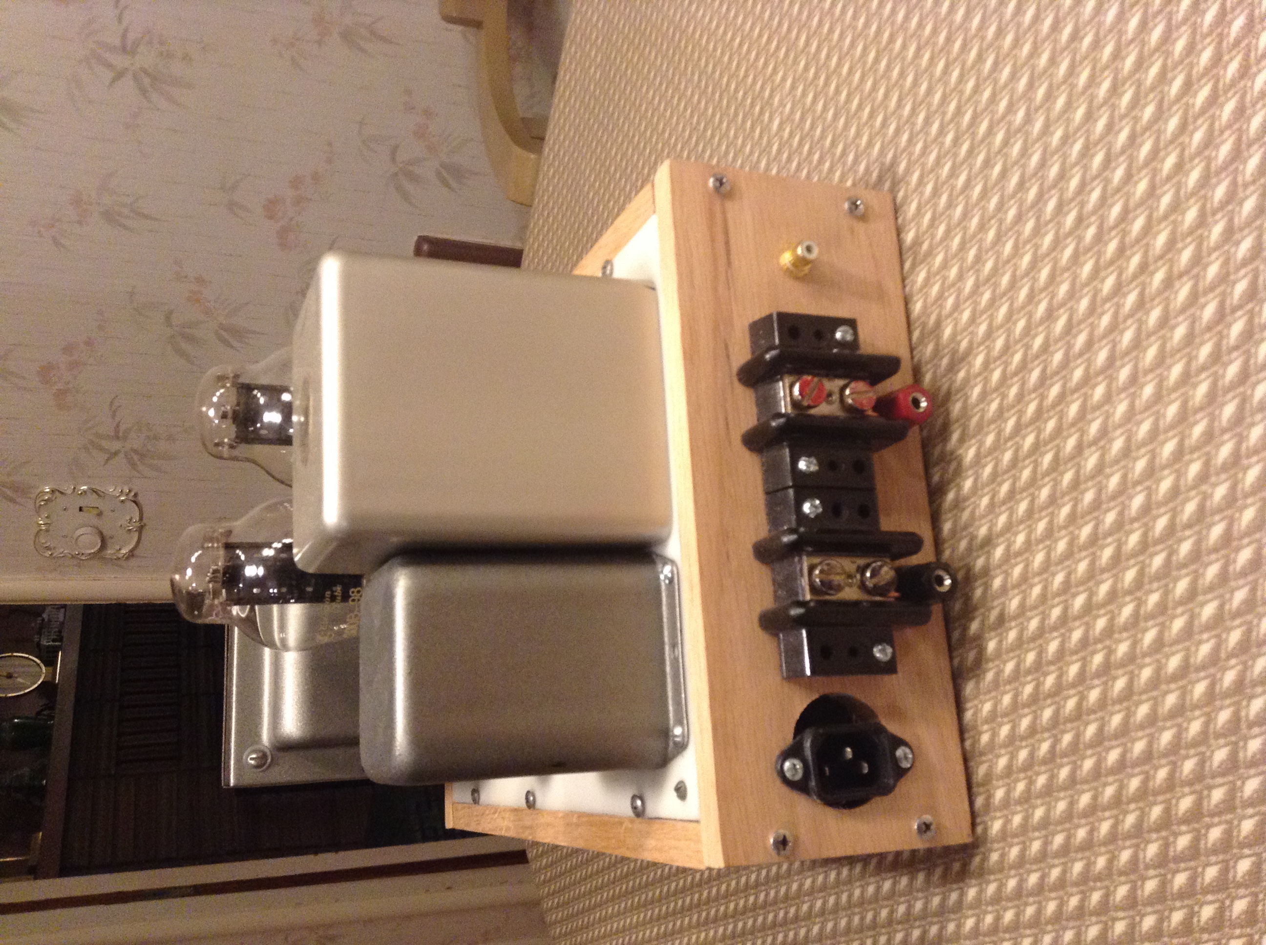

Well, here they are, the little guys I was building for my friend Jim. Fifteen glorious watts. :-). The layout is based on a Heath WM5, and in fact I was going to use the same chassis, but after getting them built I couldn't deal with the metal, and so I tore them down and redid them with Delrin and oak. They sound pretty good. The circuit is very basic--6J5 direct coupled to 6SN7 long-0tail phase splitter. Cathode bias with the Heath balance pot for the output tubes preserved. 5AR4 rectifier. James 6.6K outputs, Angela power trannies (if I were to do I again I'd order some Edcors). The Heath chokes also survived to serve duty. The 6J5 plate voltage is adjusted by a pot on the cathode. There's precious little headroom for the phase-splitter/driver so the voltages have to spot on. I'd include a shot of my patented poinht-to-point wiring but it won't let me and besides, you'd throw up. Take a good loook because one of you may be asked to repair them down the road. :-).

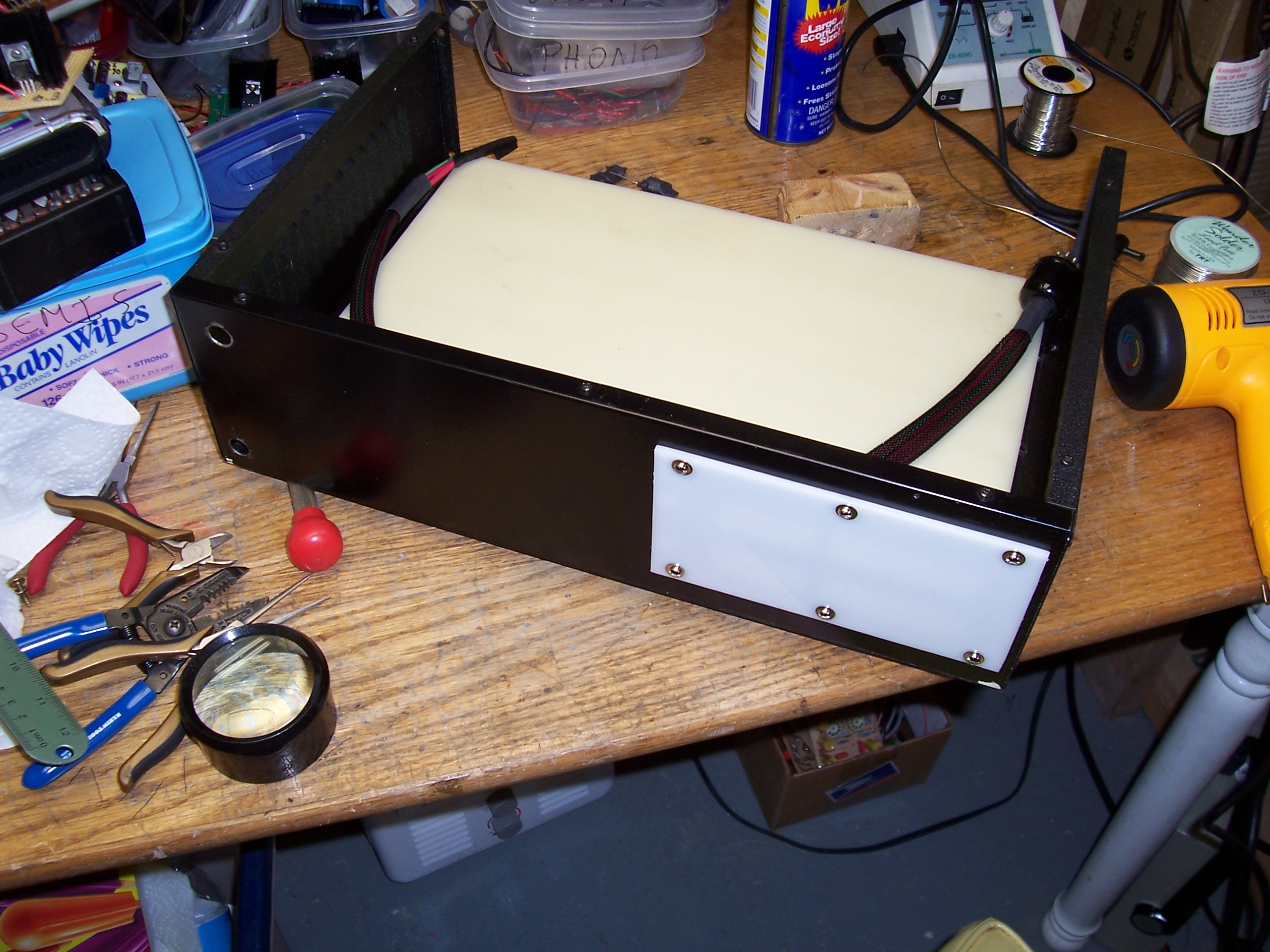

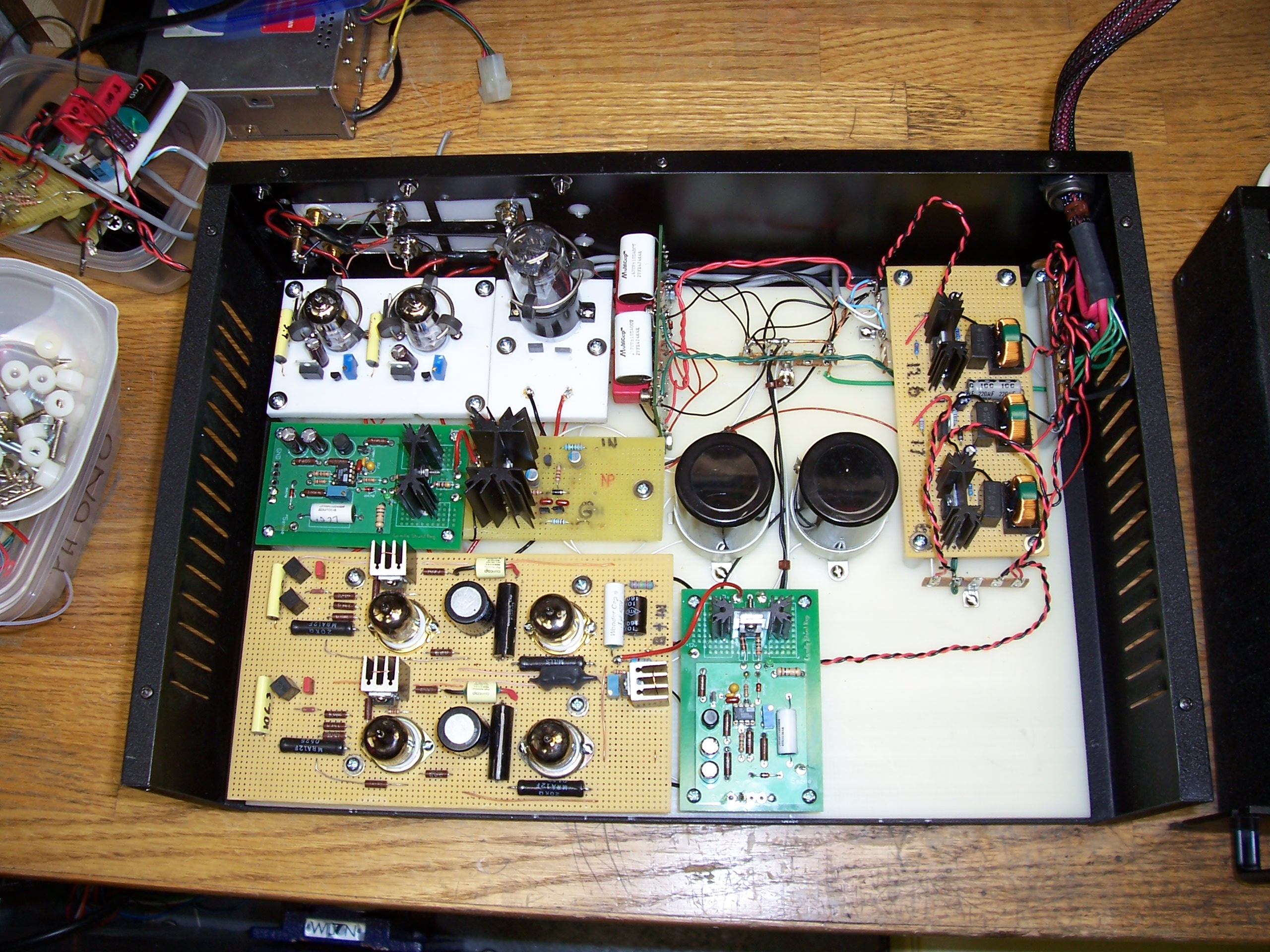

A couple of pictures attached of my phono stage in a junk box, but with a ~0.75" piece of Delrin in the bottom and 0.25" Delrin as a mounting plate for the jacks.
