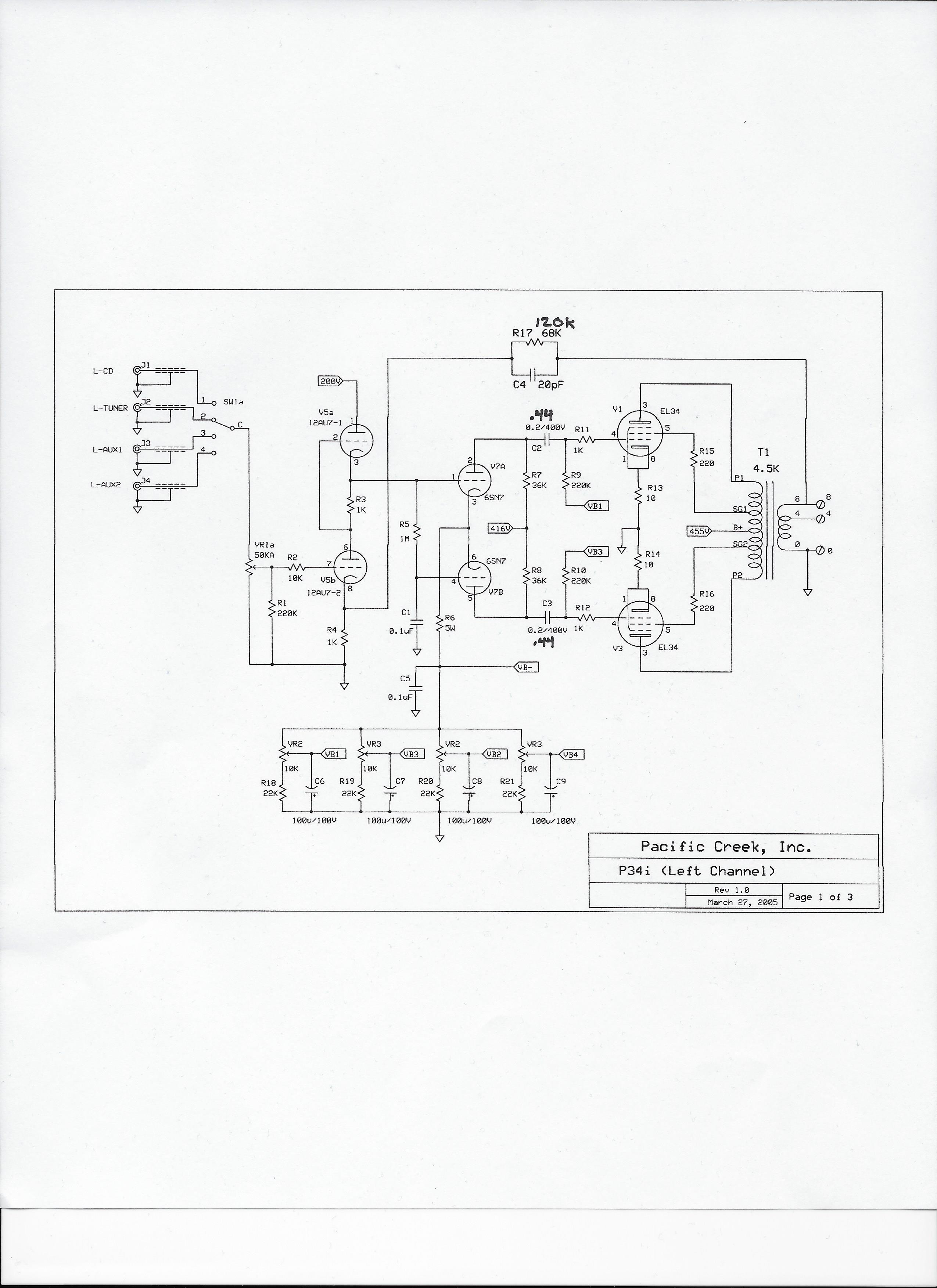

Hey All,
I was just curious what determines the exiting voltage at my speaker terminals on my EL34 Ultra Linear tube amp.
Are there any relatively easy mods that I can use to experiment with the voltage going to my speakers?
I was just puzzled why crossover caps come with 250V and 600V ratings, when it appears to me that most audio equipment doesn't produce that kind of voltage. Or does it, and I have just never seen that?
Wouldn't a change in voltage going to my speakers create a change in sound quality in some meaningful way?
Thanks,
Chris

PostPosted: October 12th, 2015, 8:01 pm
Hi Chris!
Pardon me for saying this, but you really should dig into some books on the subject. That said, what you are measuring is nothing more than voltage drop across the 10-ohm cathode resistors which represents 30-ma cathode current. You might try 38-ma for better sound. Your schematic shows that the plate voltage is 455-vdc. The primary circuit of your amp., which is typical, is a high impedance, high voltage circuit and the high voltage audio signal needs to be converted to a lower voltage and higher current signal for your speakers use plus the transformer blocks the high voltage DC from you speakers. Another thought. i have no clue why we call them tubes. The British call them valves and that better describes what tubes do.
PostPosted: October 12th, 2015, 8:02 pm
So, if you have eight ohm speakers and you are putting sixty ways into them, then 60 x 8 = 480. The square root of which is 21.9. So you are putting 21.9 volts RMS into your speakers. Peak to peak voltage is 2.828 times that value or about 62 volts. That is the voltage the caps must withstand.
