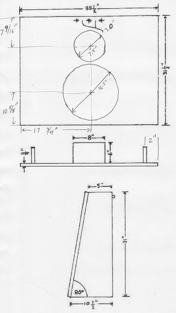

OK, so it's been way too long, but I've finally got the rest of the info one would need to build these together.... The baffle plans are based on a design I found on Joseph Esmilla's website, which doesn't seem to be there anymore. However, it's been archived, so the original information that inspired me to come up with these can be found here: http://jelabsarch.blogspot.com/search/l ... n%20Baffle A good basic explanation of open baffles can be found here: http://jelabsarch.blogspot.com/search/l ... n%20Baffle

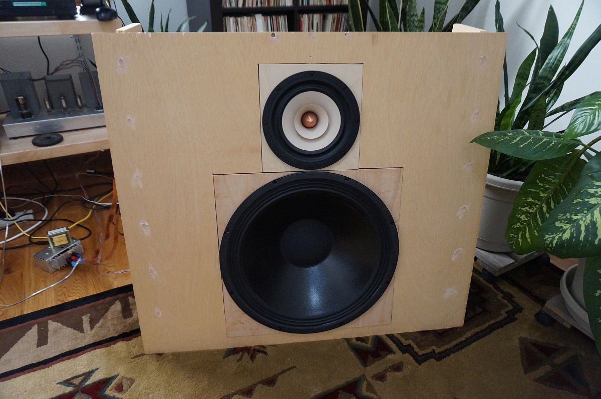

My baffles are the same size & basic design as the ones Joseph published, with some added mass loading and some handles added as they get heavy....

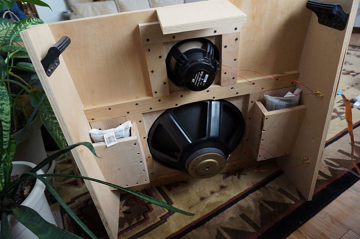

Here's a couple pics and a drawing:
If you're going to build these, and don't plan on doing a lot of experimentation, I'd just build the main panel as a single piece, I made mine modular to make it easy to swap out drivers of different sizes/mount patterns. The bracing on the back might still be a good idea, as it'll stiffen up the panel a bit. I didn't add the pockets on the back for the lead shot to the drawing, but they're constructed from 3/4" plywood like the rest of the design, with inside dimensions of 3"x5.5"x8.5". Use the best void-free 3/4" plywood you can find. If your woodworking skills are better than mine, you might consider using biscuit joints to mount the sides and the top baffle so there's no screw holes to deal with on the front. Another option would be to glue/screw everything together, and then smooth out the panel and apply a veneer. As shown in the picture, the top panel is mounted flush with the top on the baffle, that's not really shown in the drawing.

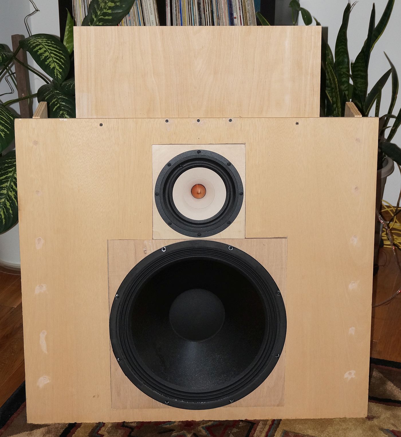

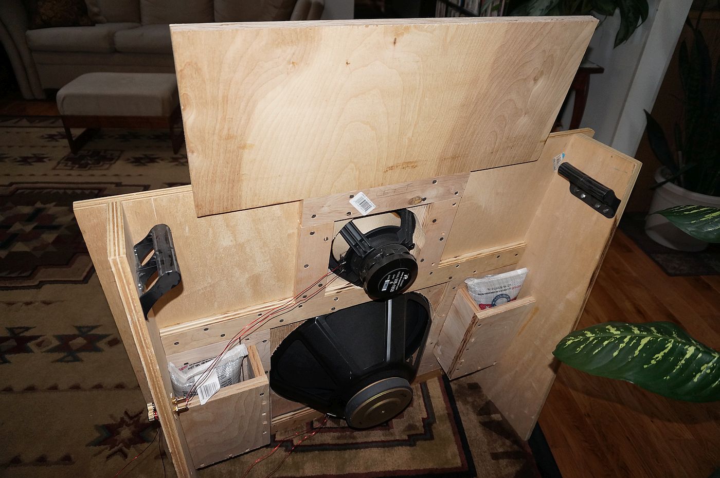

After listening to these for a while, and using some test tones, it's become apparent that there's a bit of a suck-out between about 110Hz & 225Hz due to the close proximity of the full-range driver to the top of the baffle. Sometimes solutions come in very simple packages:
The added piece of plywood is 10"x24", centered over the full-range driver, with 8.5" above the top of the original baffle. This moves the baffle-induced LF roll-off of the full-range driver down by more than an octave, and is a huge improvement. I'm currently working on new baffles that will be slightly larger, with the full-range driver offset to the side and lower on the baffle to create the same effect.

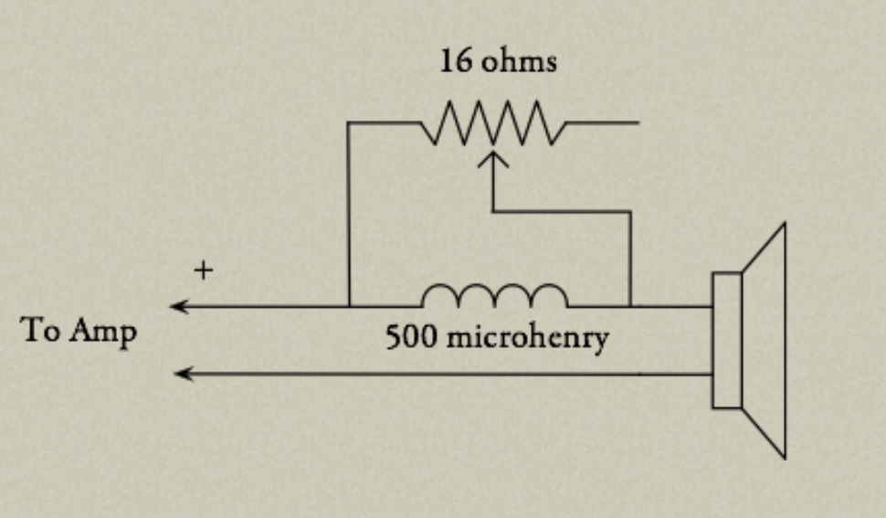

here is an article about tamming the rising top in on TB full range driver
http://www.transcendentsound.com/Full_Range.html
PostPosted: April 27th, 2016, 11:03 am
Posts: 1733
That's for the 1772, which has a significantly hotter high-end than the 1808s that I'm using....
