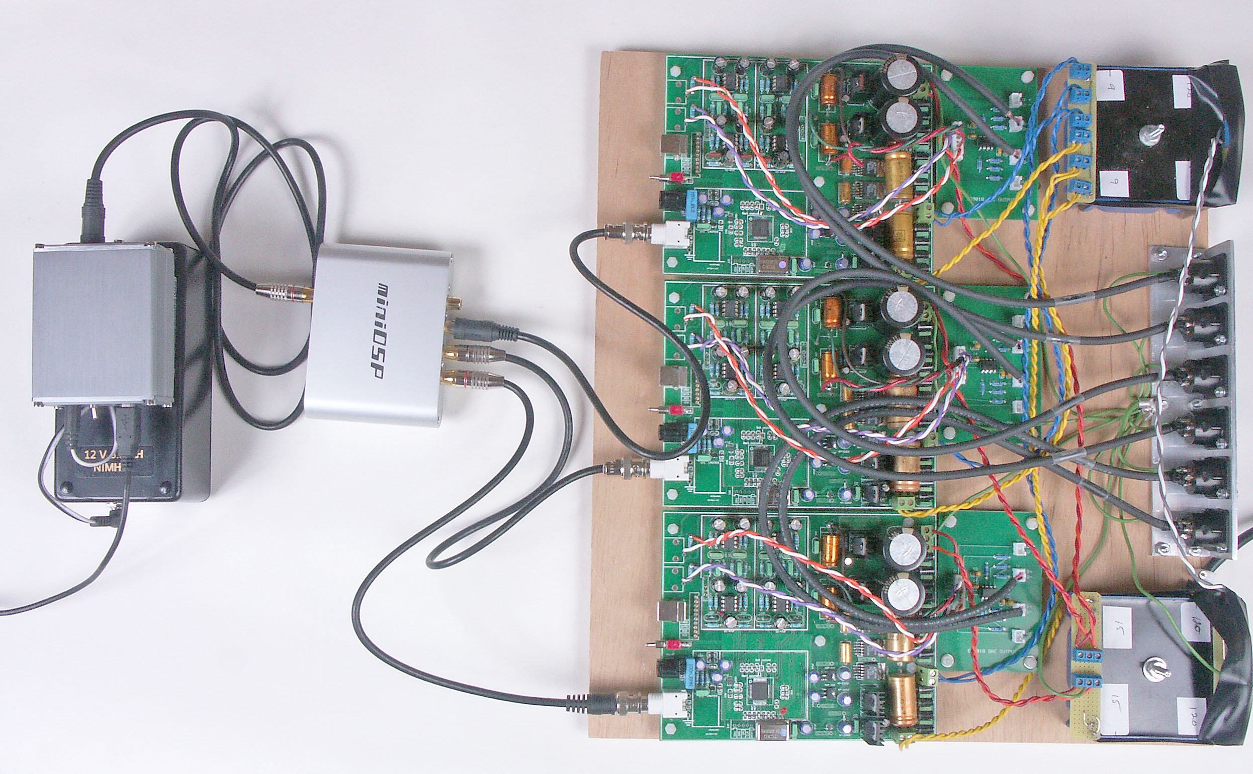

I started working on a digital project but got sidetracked with my VFET SET amp. Here is a photo of the breadboard. The signal starts with my laptop using FOOBAR as a player. Output goes to a USB to SPDIF converter using a CM6631 CHIP. The Windows driver is the one used by Emotiva for their XDA-2 USB to SPDIF unit. The SPDIF output is fed to a nanoDSP crossover/processor. The three nanoDSP outputs go to three DACs using ES9018 chips.
Problems so far include a DC offset using the balanced outputs of the DACs because they are primarily used for unbalanced. I had to build a board to provide balanced output for my amps that had no offset. You can see the three boards between the DACs and the XLR jacks.
Ocassionally there are glitches where the nano either mutes or has ticks like a vinyl record. Don't want to lose the charm of vinyl. I downloaded new firmware for the nano which should solve the problem ( yes and the check is in the mail) but have not had the time to try it. Right now I'm putting together my test system in the basement to begin working on the project again. When it works the sound is glorious. I'll get the bugs out but thankfully I have no hair to pull out.

Very cool, Tom. I want to know how this turns out!
