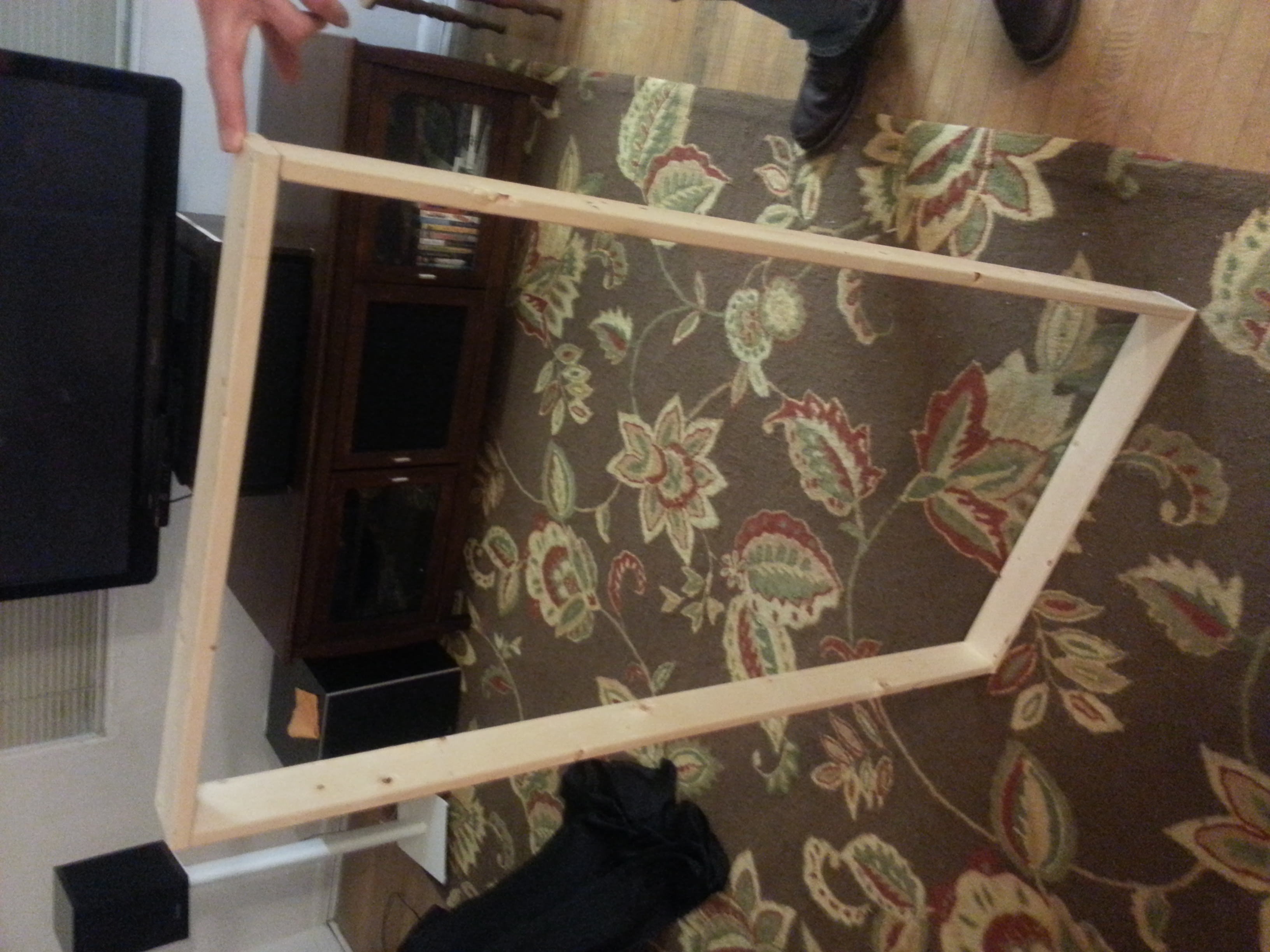

The build process is to first cut the appropriate lengths of furring strips to build frames that will go around the insulation. Glue and screw these pieces together.

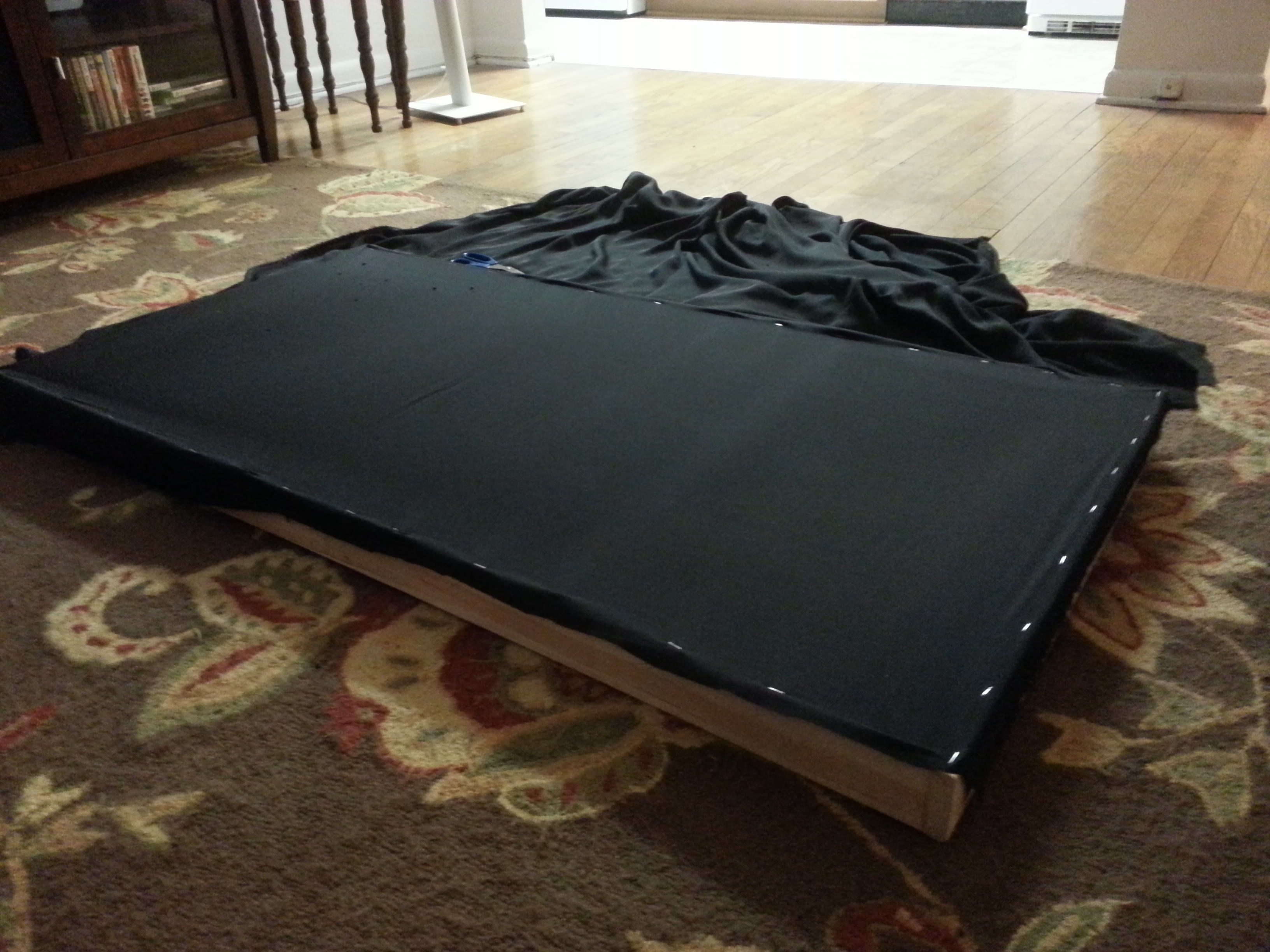

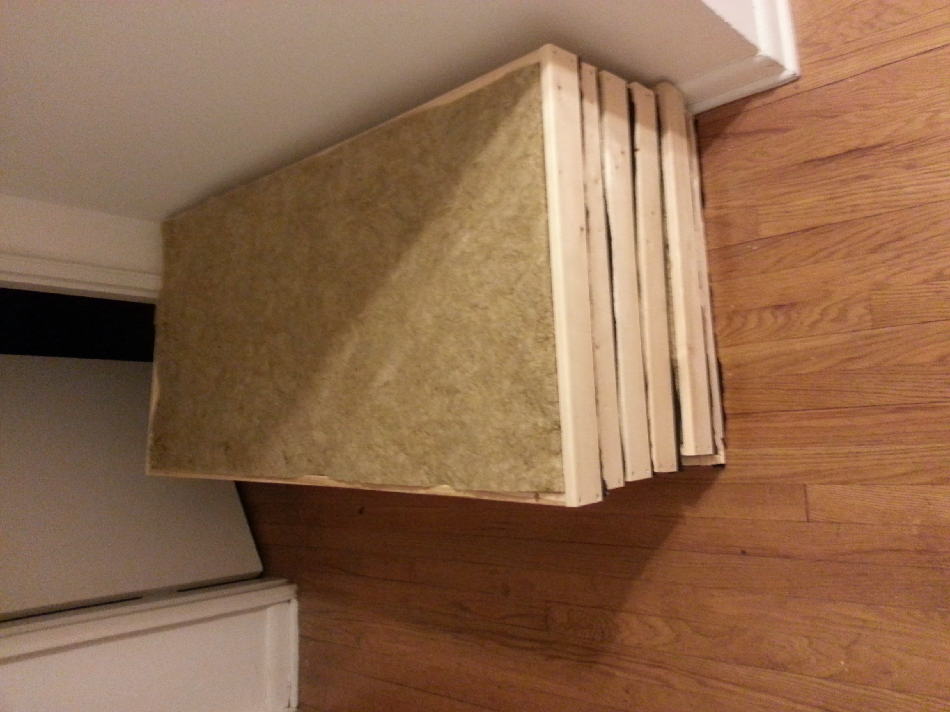

With the frame built, attach fabric to the back using staples. Trim the excess after stapling.

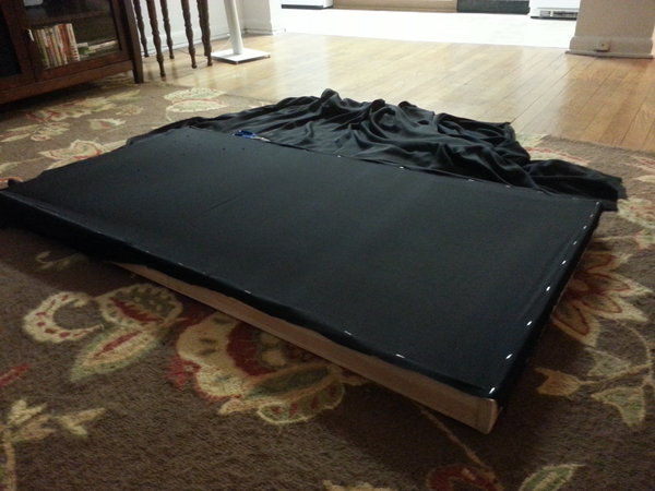

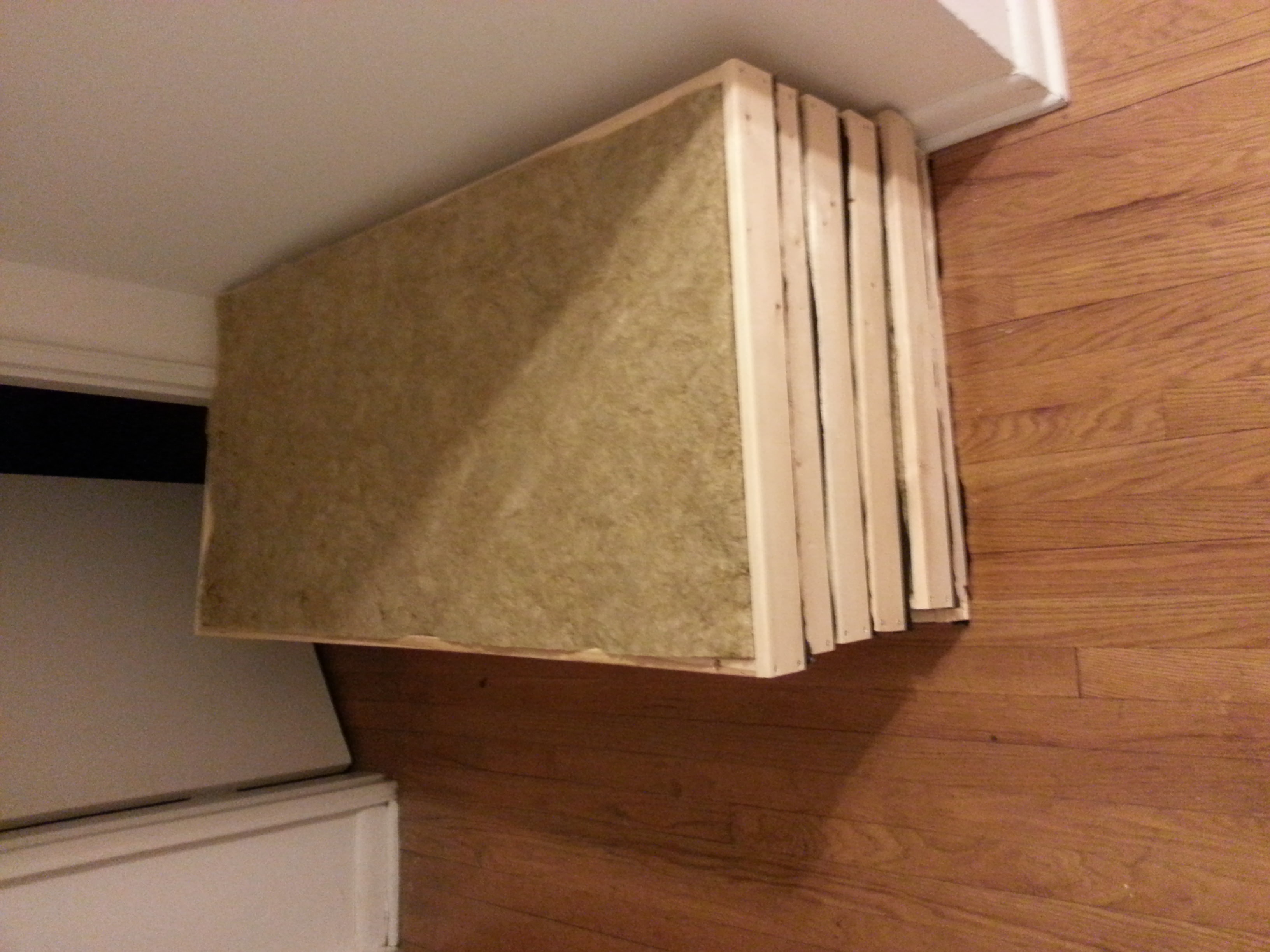

Spray glue into the back fabric to keep the insulation from slumping (depending on insulation used, you may be able to skip this step) and fit the insulation into the frame.

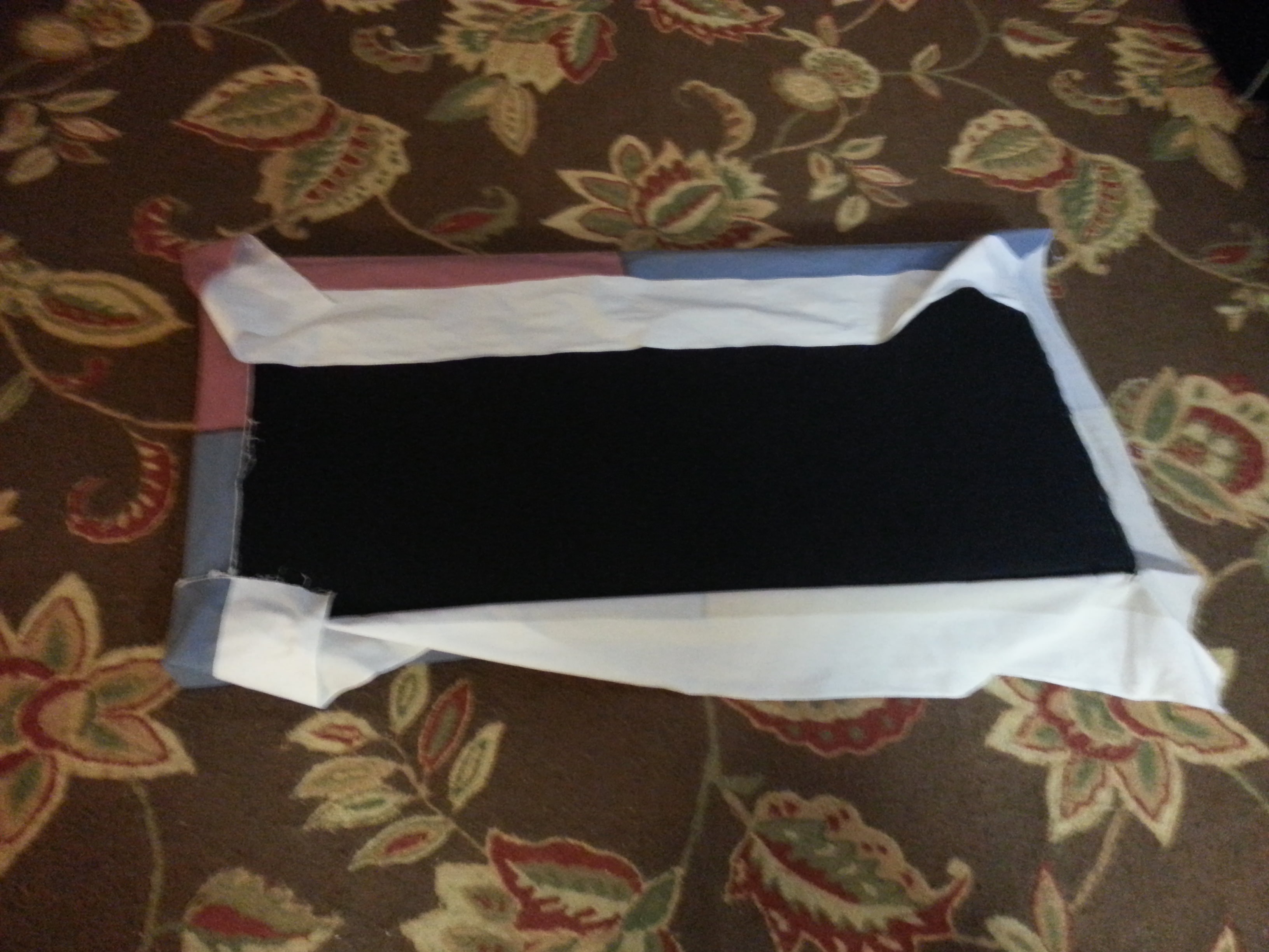

Place your chosen fabric for the front on the floor upside down with the panel on top of it. Wrap the sides around and staple down.

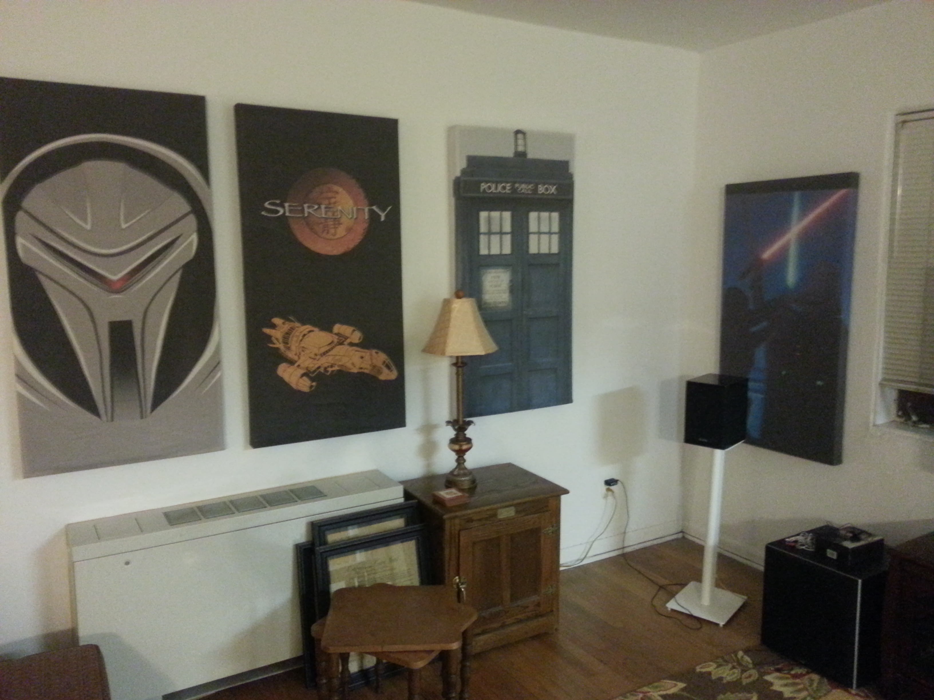

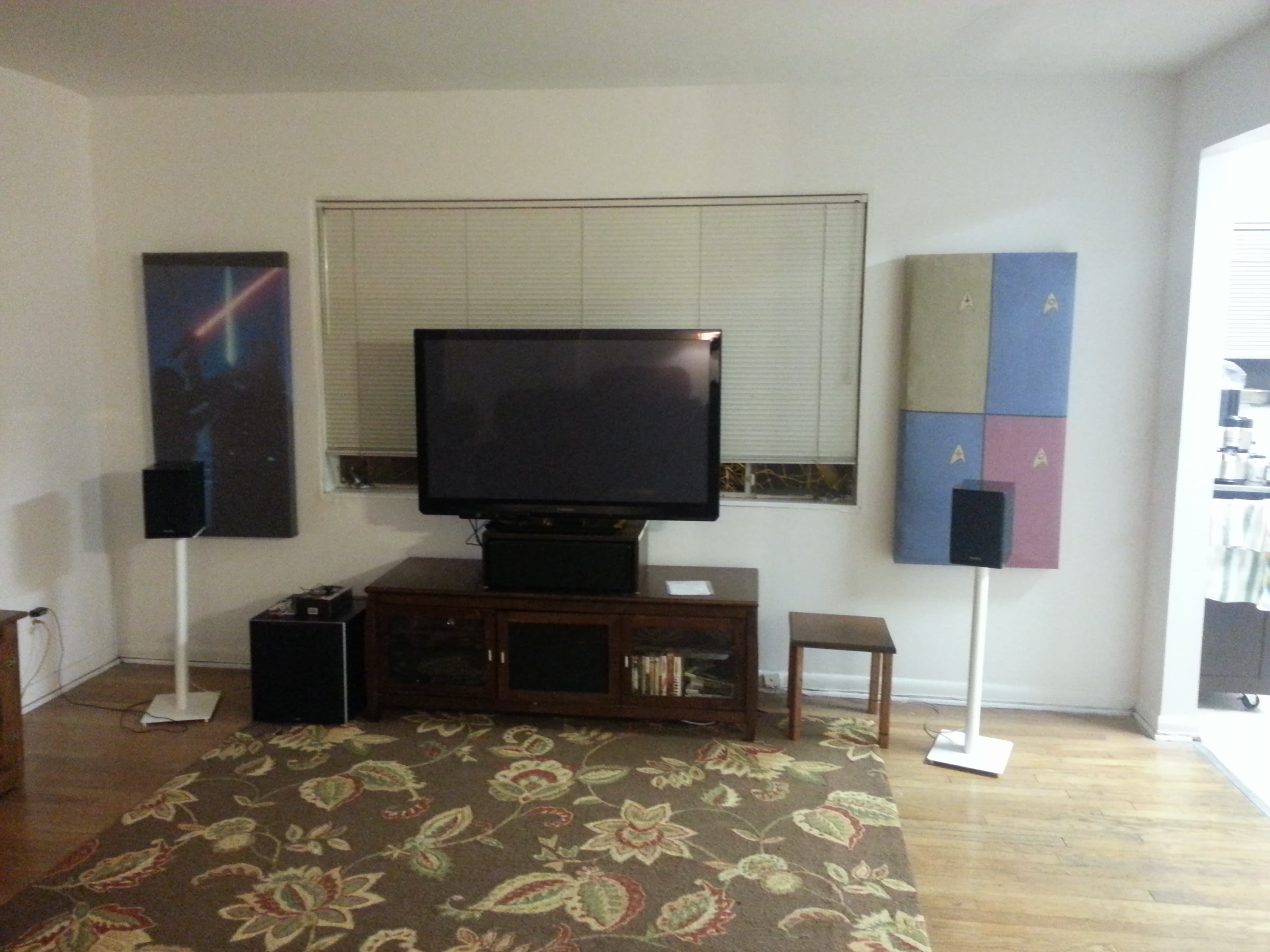

The final step is to screw in some eyes to the back about 1/4 to 1/3 distance from the top and stretch picture wire between them. Determine placement, hang, and enjoy better sound. Here's the way mine looked when first built with a different room arrangement before getting married. That's right, I was allowed to keep these up in the apartment after getting married.
