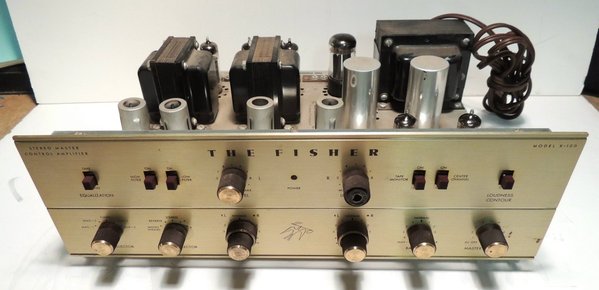

the el cheapo has been discussed many times on AA, from what I have heard its supposed to be a killer little amp, I believe that Eli Duttman had something to do with it. You can get the schematic and do a p-p scatter project, but being new I would just go for the board and eliminate the probabilities of miswiring, especially for someone new at this. Go on AA and research it, a lot of good and knowledgeable folks there.
I just picked this little jewel up for $300, working, probably right up your alley...
That's a really cool looking amp. Where did you pick that up?
