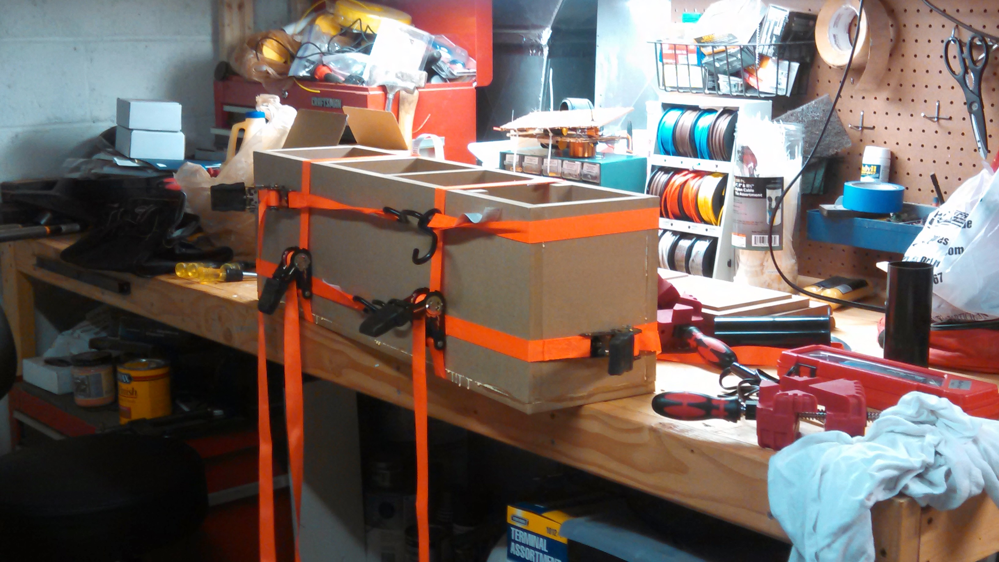

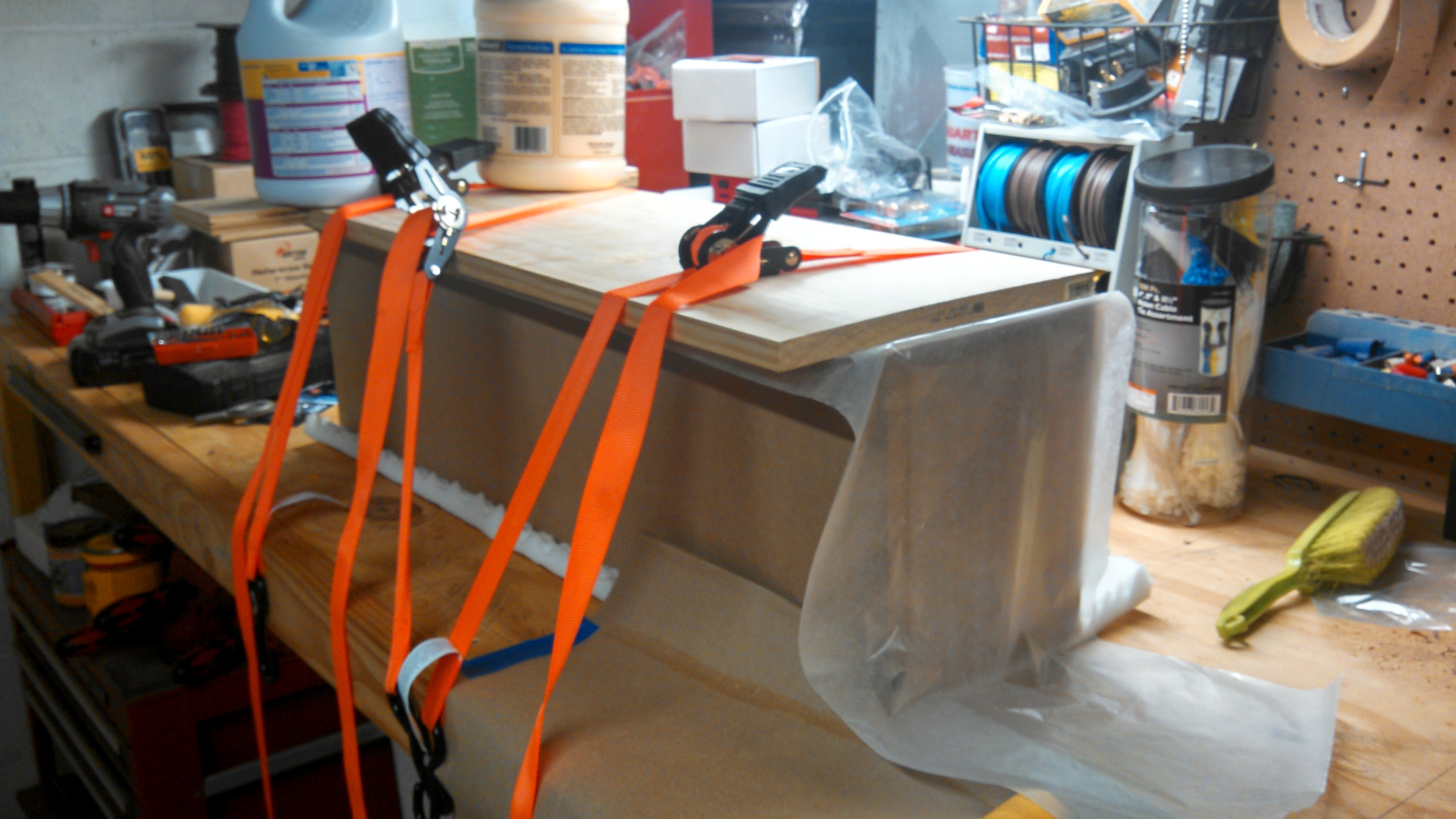

Got the cabs glued together per Eric's instructions. No fasteners of any kind were used as all cuts were CNC and dado so the fit was snug. Clamping was a learning experience. I had bought a bunch of clamps that none worked perfectly and then decided ratchet straps and cushions worked much better.

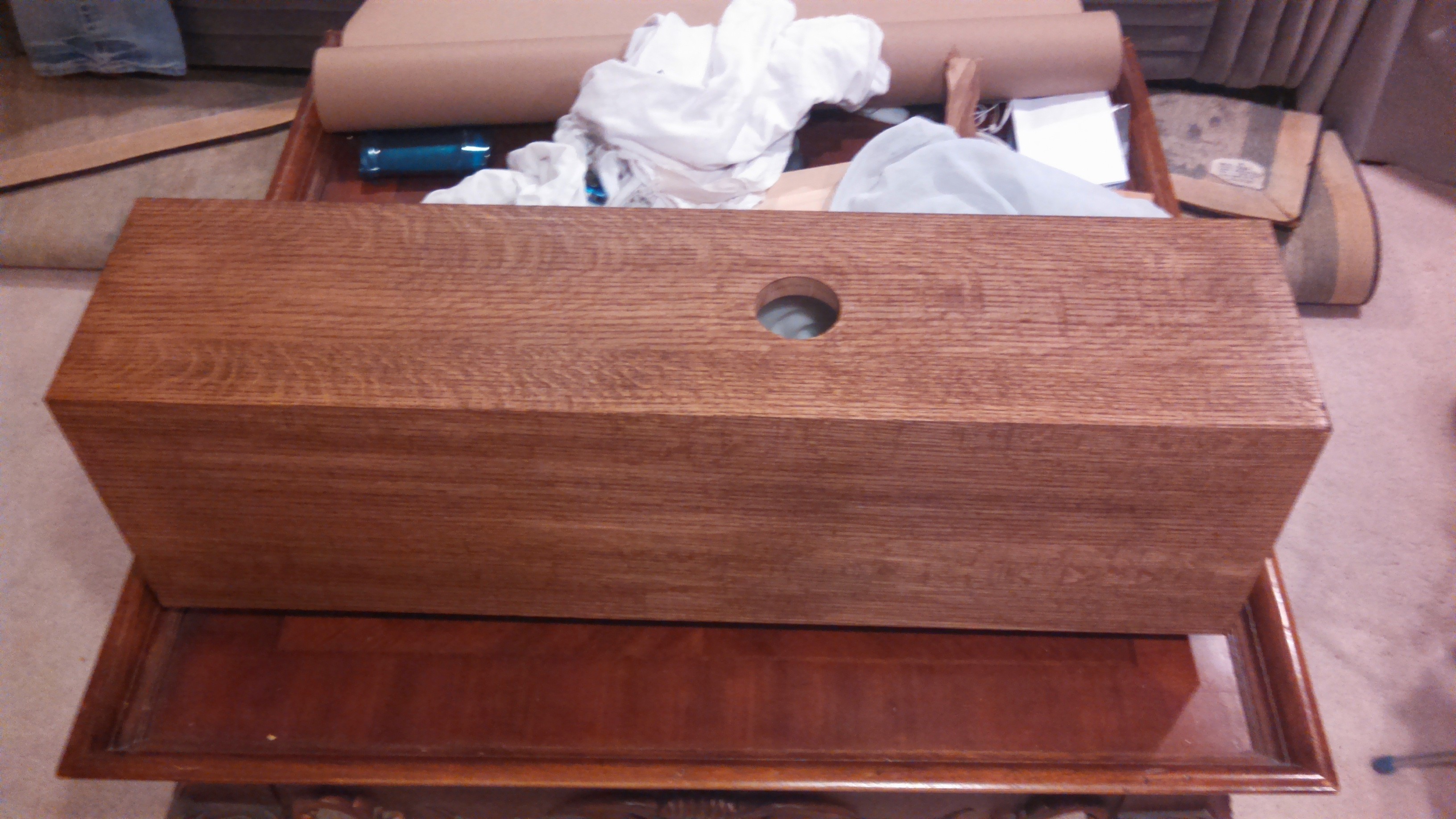

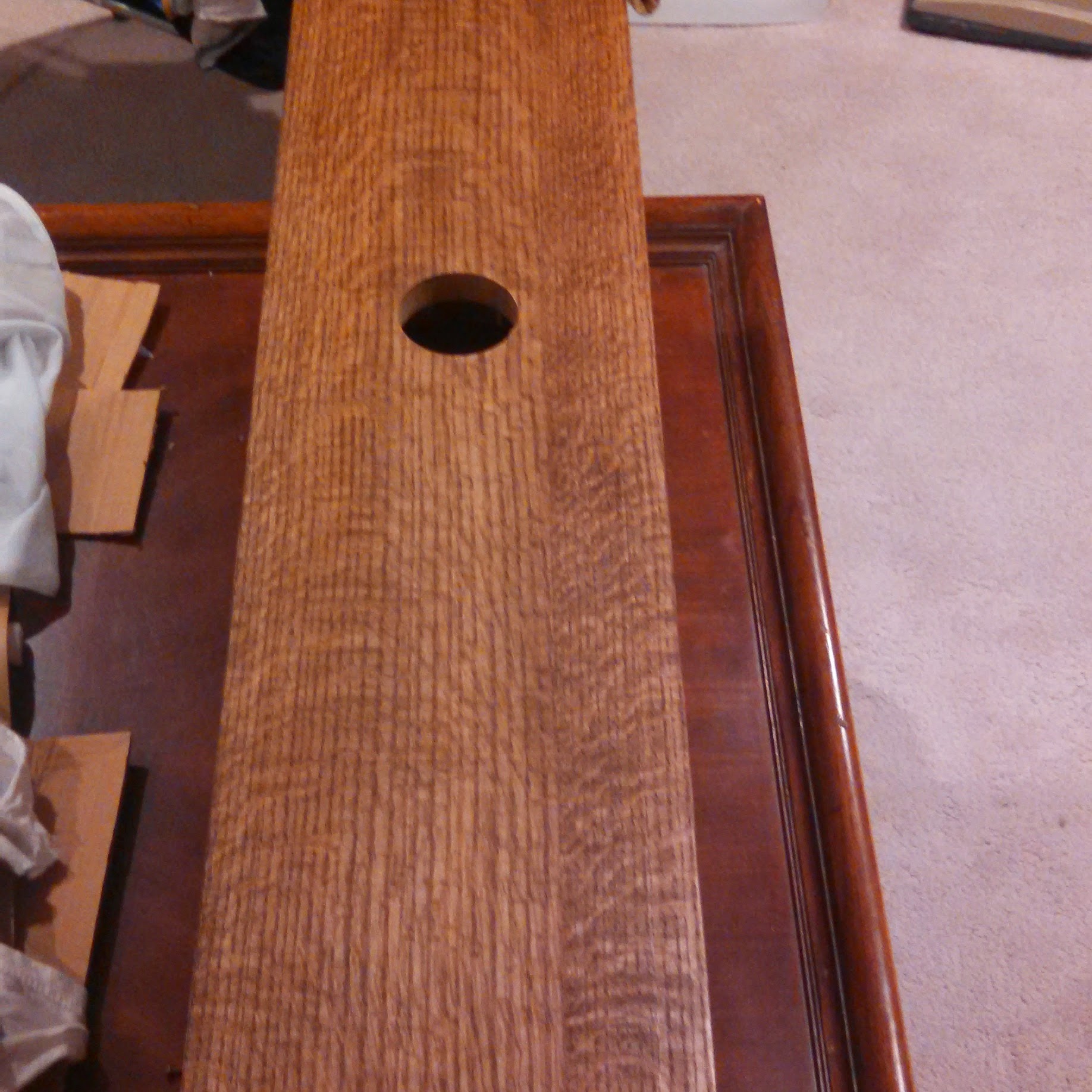

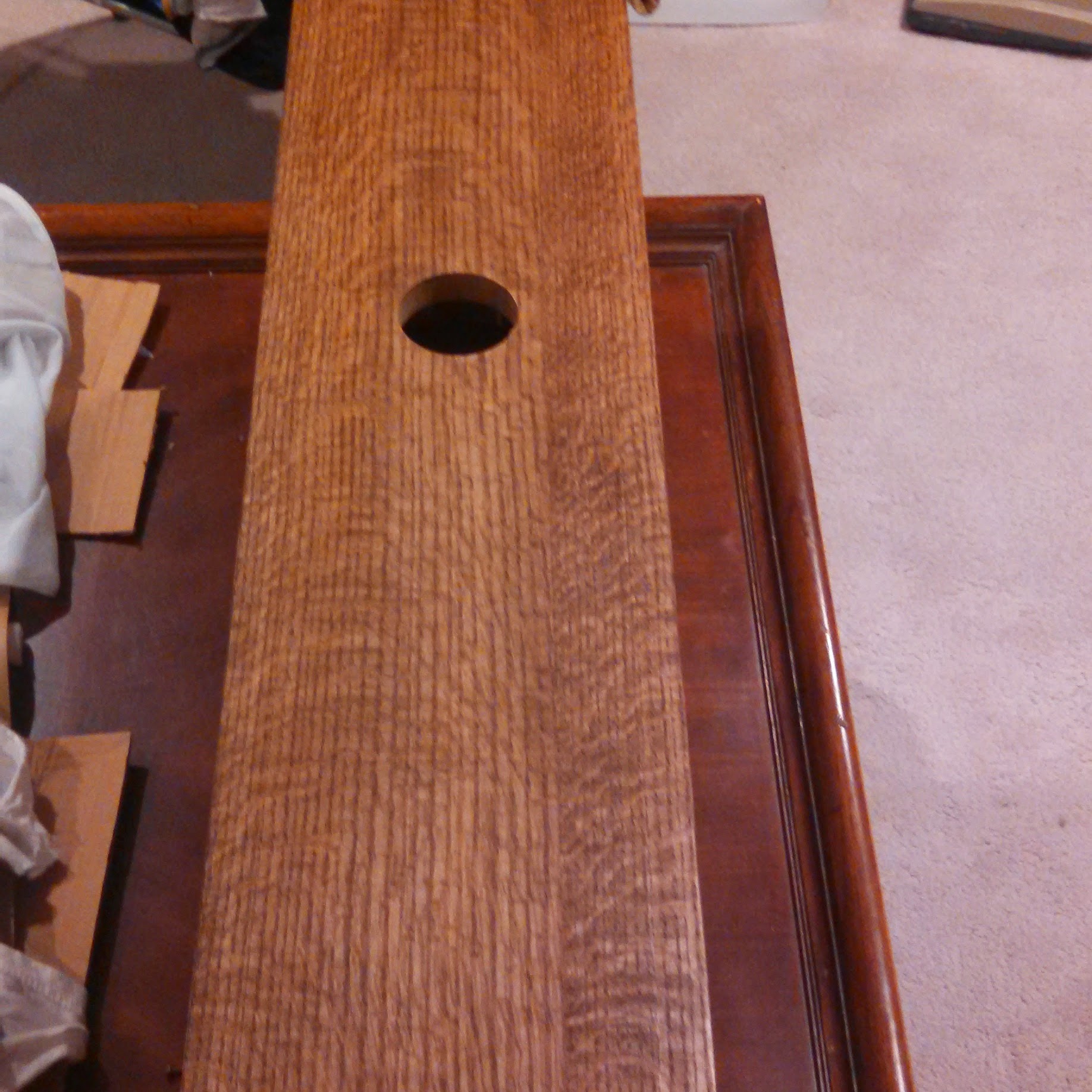

Decided if I was going to get my feet wet- I might as well do the best job I could. All the furniture in the house- save for a couple of things are all antique oak. Some mission era- some more primative- but nearly all oak. Thought a nice quartersawn oak would fit the bill so I ordered a sheet of Paperbacked slip match quartersawn with heavy flake. Was a bit nervous as I had never veneered anything but followed the instructions and took my time. Overall I was incredibly pleased with how it turned out.

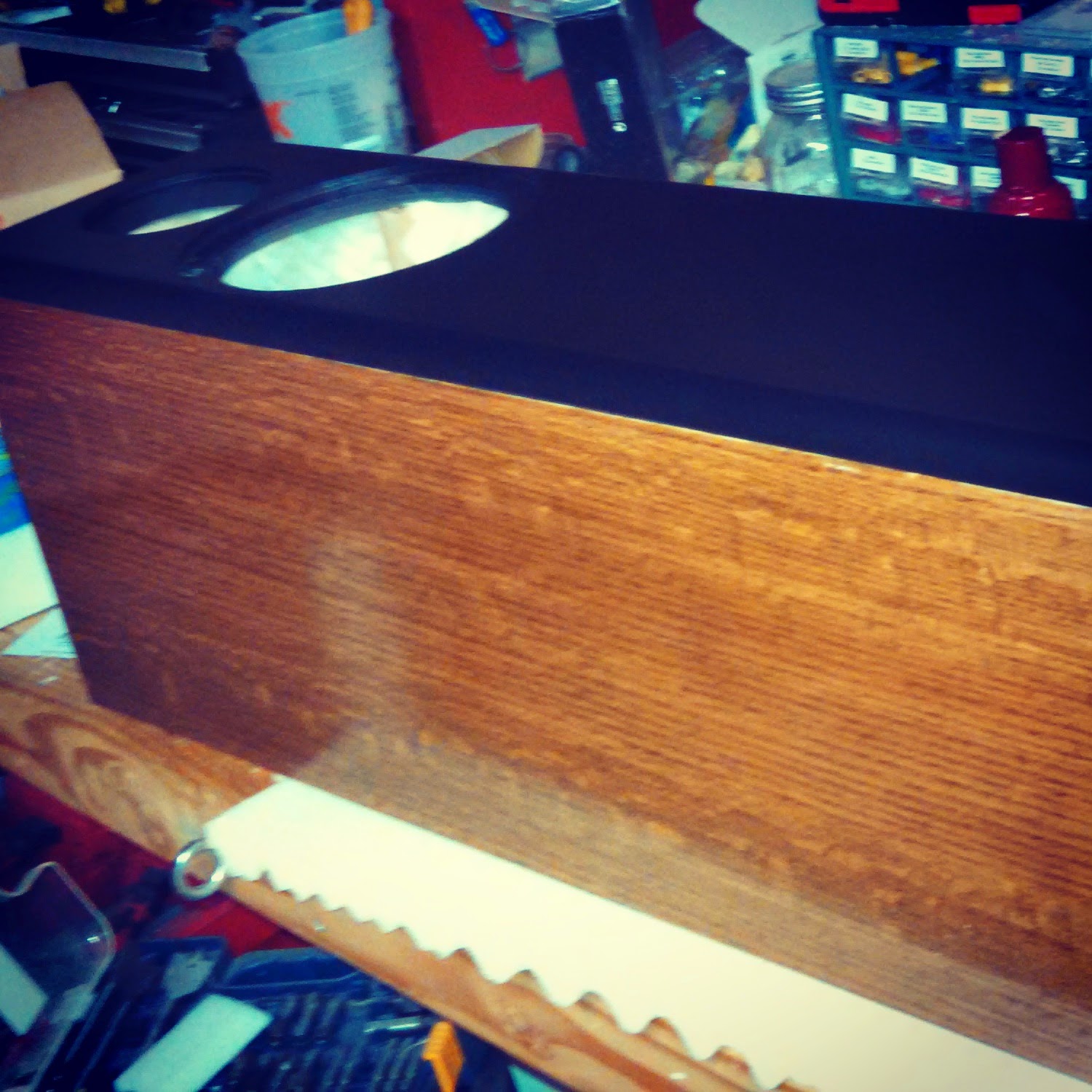

Decided on special walnut to get me closer to the color I was looking for. Couple of coats of stain, and then went on to poly. This is where I would do things differently next time. I had some helmsman left over from other projects and decided to use it. It has a good UV protectant in it so I figured no problem. Well spar urethane is a pain in the @#$, and caused a lot of headaches. Ended up with 2 undiluted coats- 5 thinned coats, and then wetsanded with 800. 1000. 1500, cut and buff on top of that. They are as slick as an antique crisscraft now - still see some imperfections and some buildup near edges. I did not realize Helmsman is designed to remain softer- and that made things complicated. All in all though- and from the normal listening distance- I think they look awesome.
Had the baffles painted by a shop after I realized the difficulty in getting a quality matte black finish. There's a story in itself.

- Another picture of the veneer- stain in progress. Think this was with only one coat.

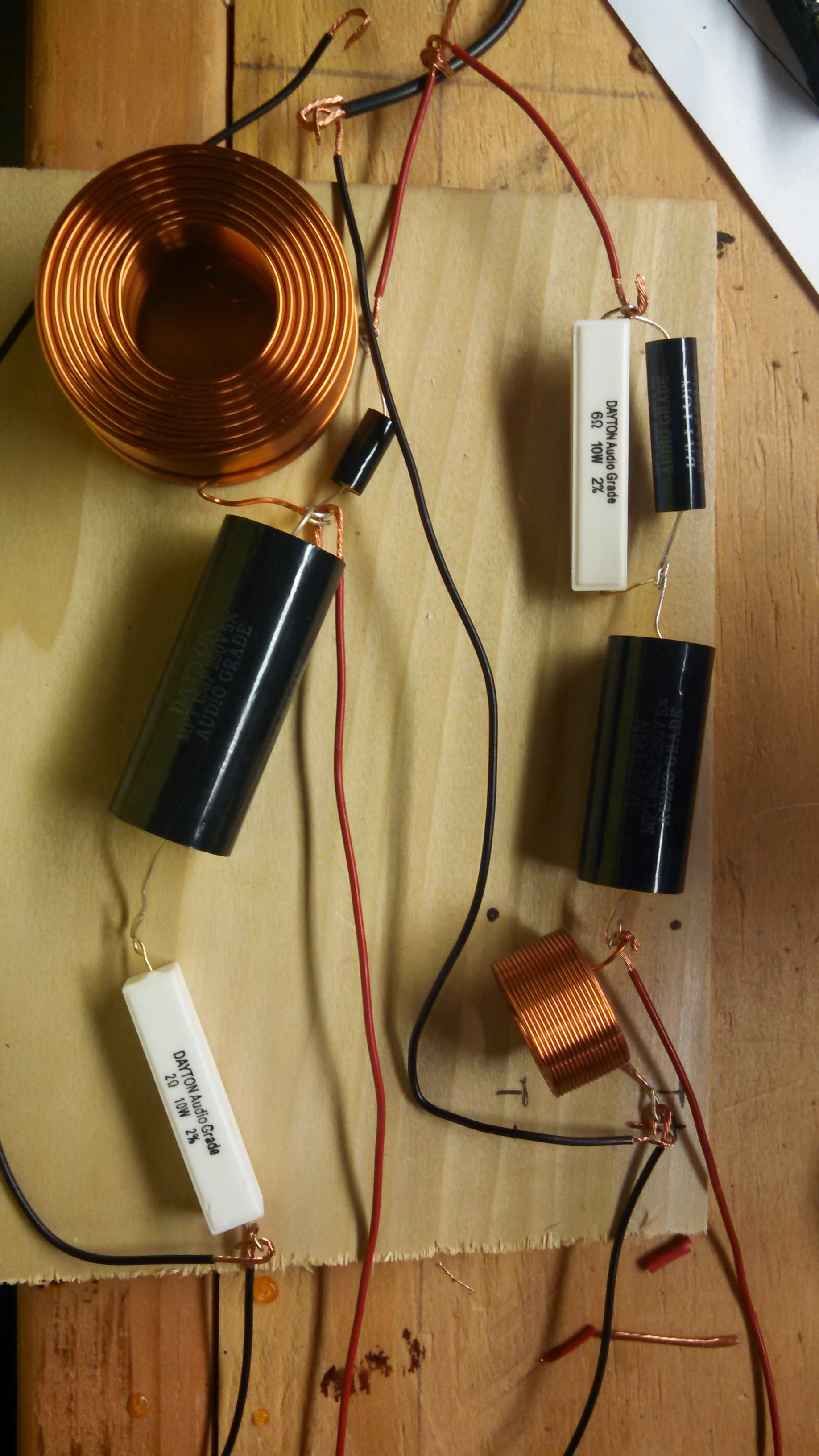

Picture of the crossover. Took me having to completely disassemble the first one I made. Tried to do the connections on underside for a more professional look, but getting the connections right doing that was very difficult for me. Then it dawned on my that this would be on the inside of the cab so why care about its look? It was great duh moment

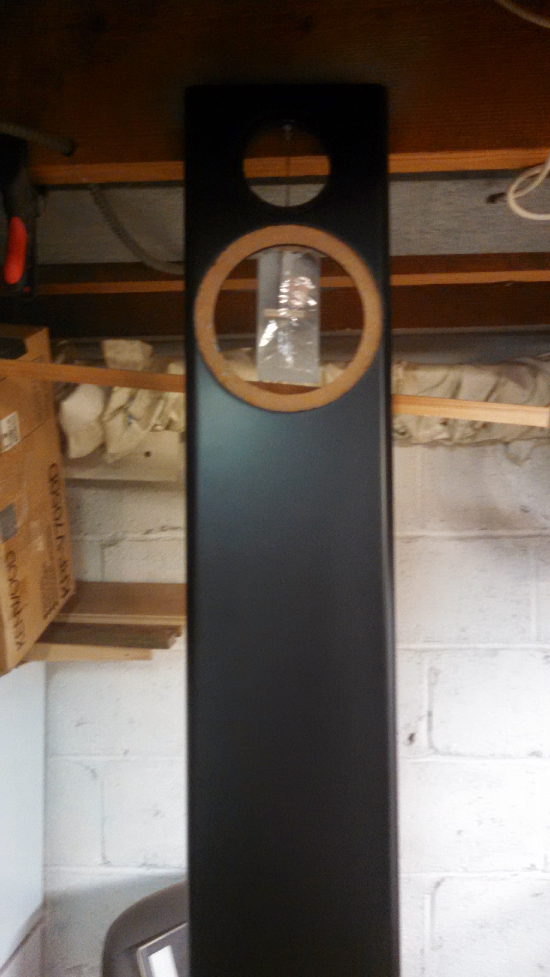

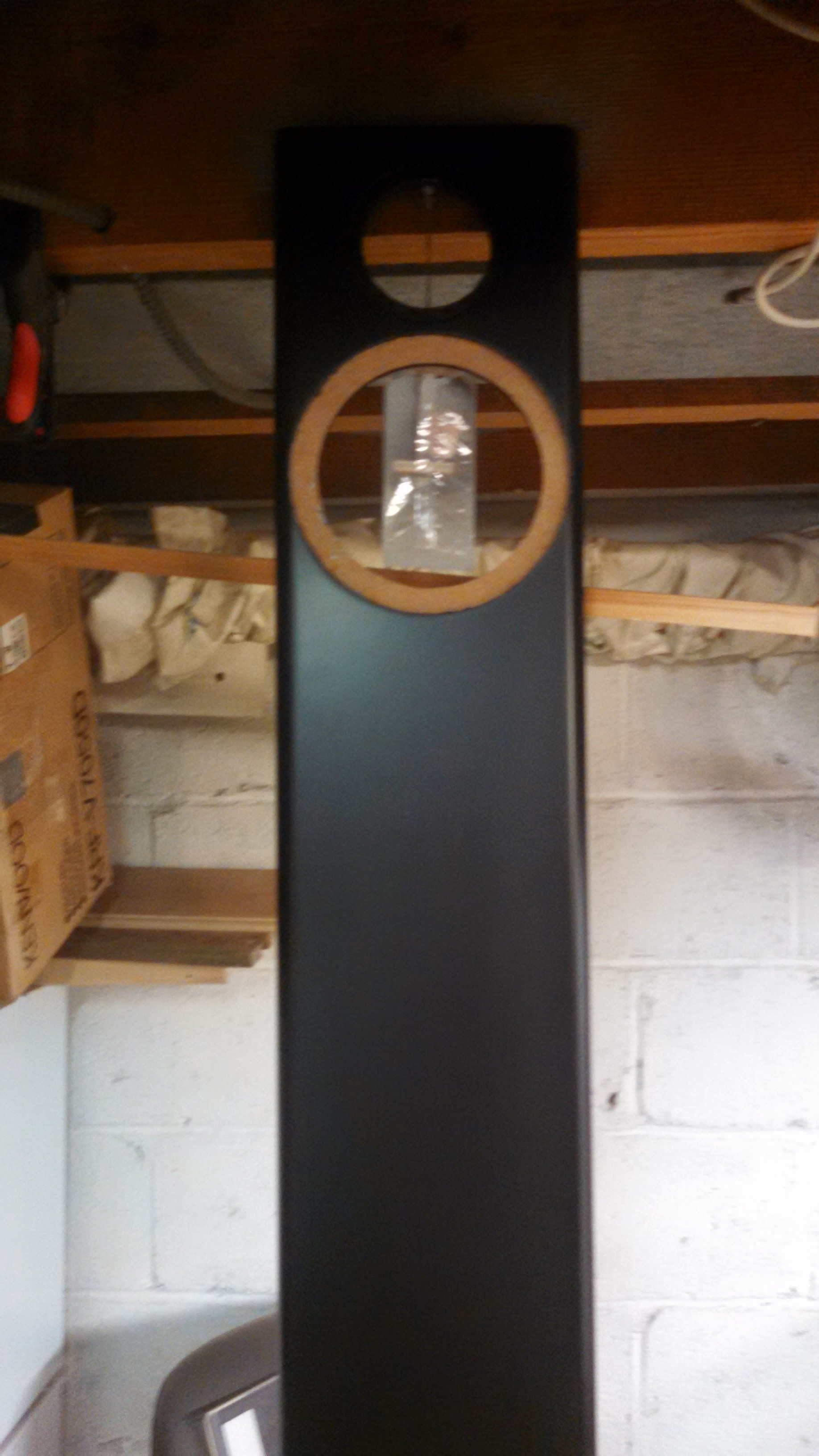

The painted front baffle- They built too much paint on the recess so I had to chisel down to get the depth I needed. This is one that I am gluing on tonight. I ordered some black india ink to dye the MDF ring so I don't see bare MDF around the woofer.

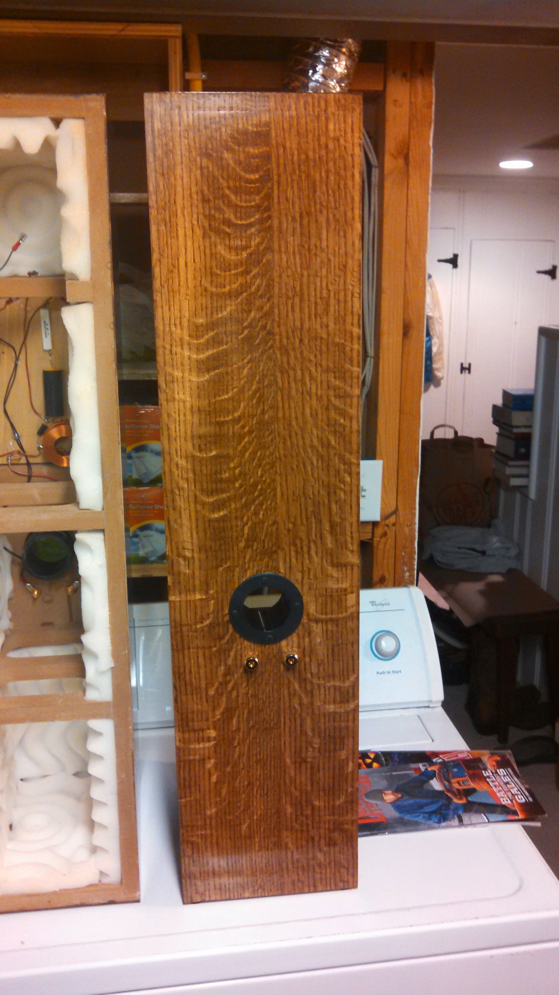

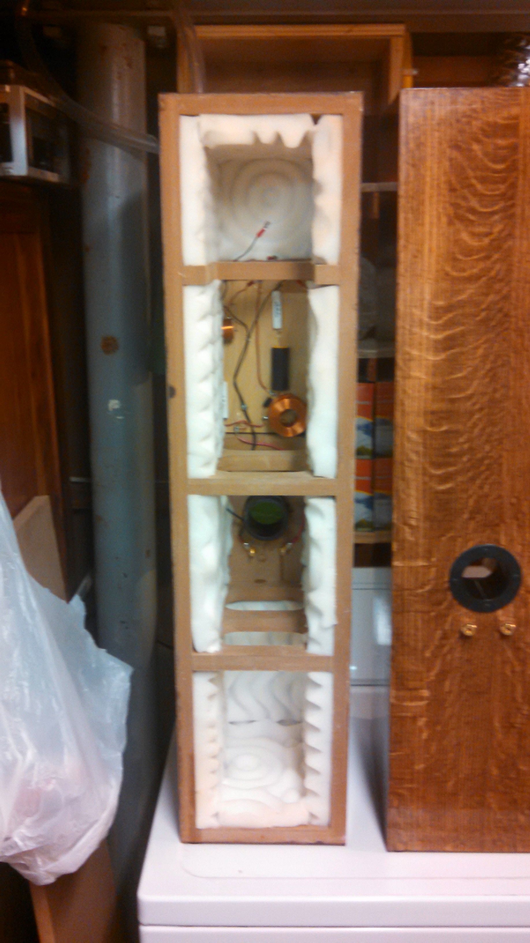

The complete veneered cab, with dampener, port and posts installed.
Another pic of the back

This last picture was just before installing the drivers. Took my time drilling the holes and tested thoroughly on scrap MDF before screwing in. Also ran the screw threads on a bar of soap before installing per a tip I was given. Think it made a difference as even when 1/8 inch from the edge on the tweeter- I got no cracking of any kind. Was nerve racking for sure.

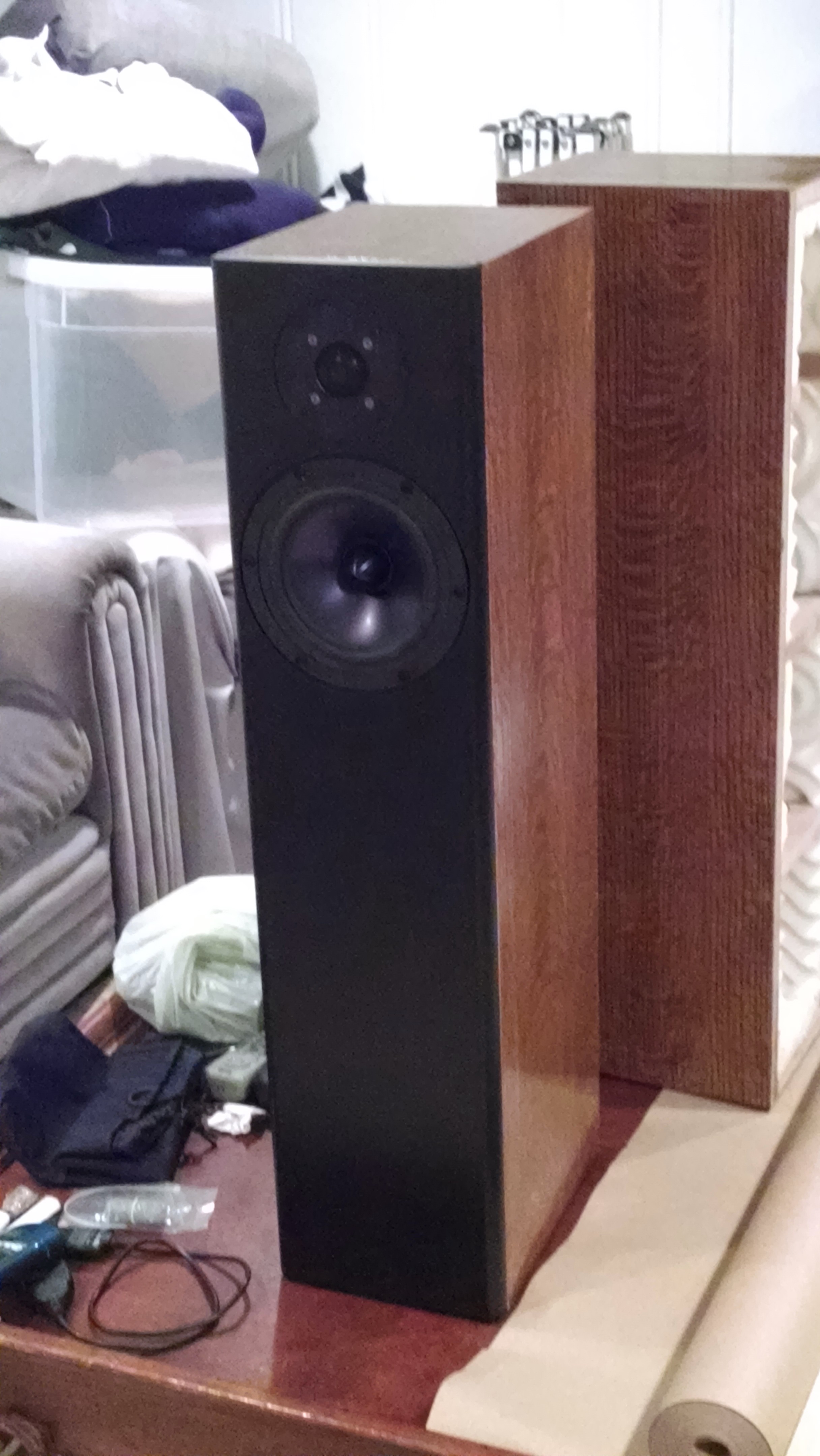

And last but not least- the pic of the completed speaker I finished last night. Not the greatest of pics, got a new phone and didn't know the settings just yet, but will take a better one tonight. Pretty floored with how it turned out and sounded. Not to the same level as a Salk speaker by any stretch of the imagination. But sound wise I would put it up against a Totem any day of the week.
