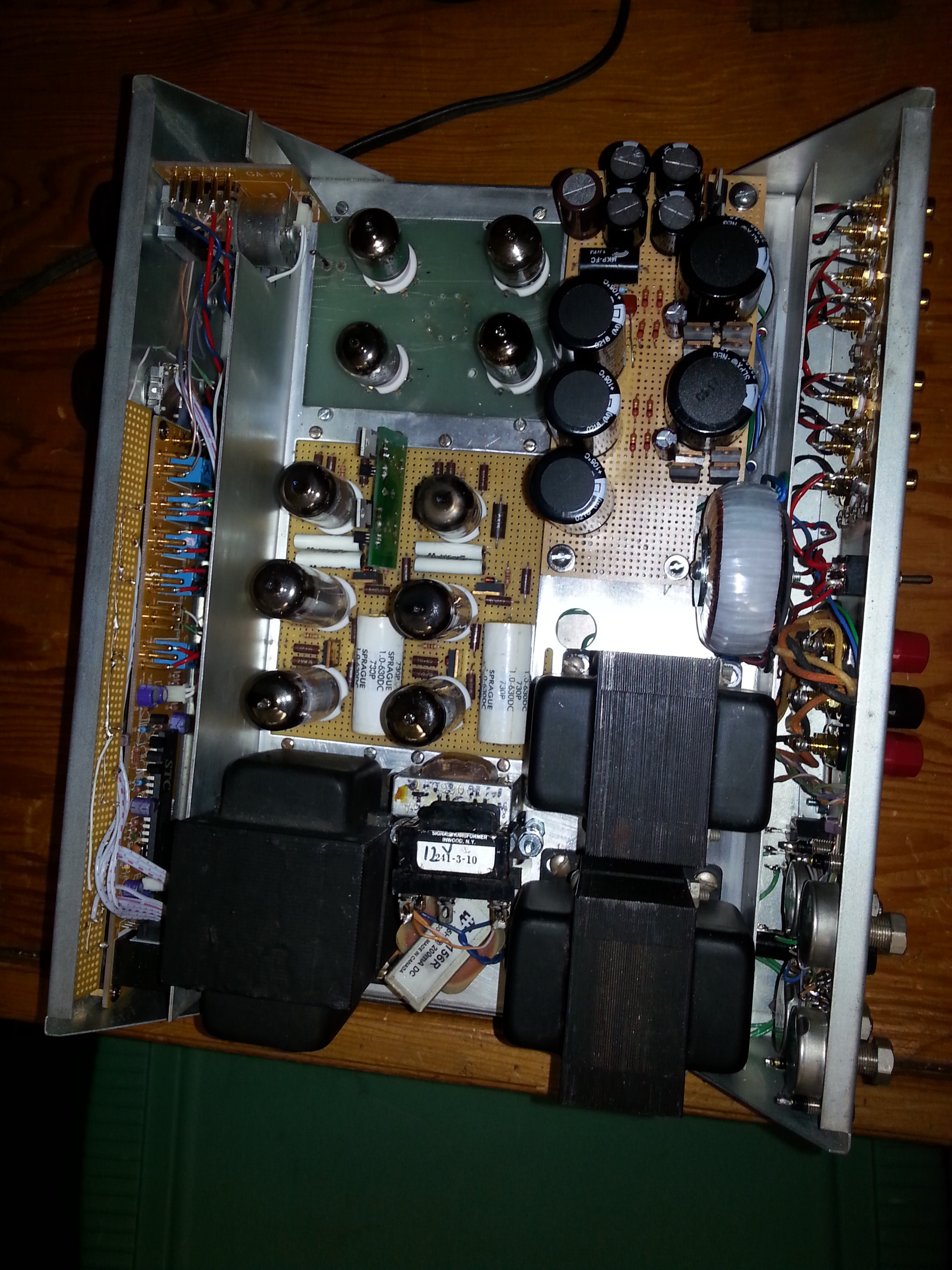

I do remember, and please correct me if I'm wrong (that's rhetorical, I know you will :) ) but isn't the major source of distortion in an SE amp the output stage? If so, and if minimizing distortion (pleasant though some forms may be) is a goal in amp design (yes, not to the extent that other problems arise, such as TIM, or pinching with excessive global NFB), then wouldn't it make sense to try out a technique that most probably would reduce the distortion?
I was convinced of the need for a very low source impedance when driving an output grid (or RIAA network, for that matter) when I heard David McGown's PowerDrive equipped amps. They were quite remarkable and without any discernible SS sonic artifacts. Whether it's avoiding blocking distortion, unloading the driver, or something else, IT WORKS!
Just a thought....
Slick
BTW, my SCA35 with 6HB6 outputs and PowerDrive is only missing a phono stage, cover and cosmetics. At the next meet, I'd like to have you give it a listen.

I would like to hear that amp, I am restoring an SCA35 using Dave Gillespie's EFB circuit for the power supply...

I think I see Guy's CCS PC board in there.....
