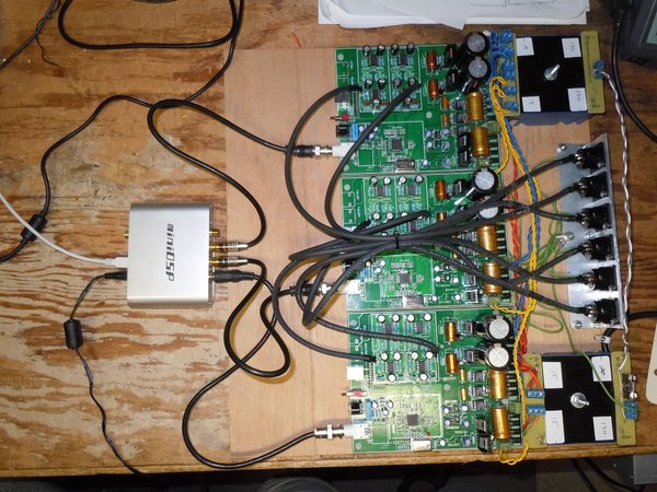

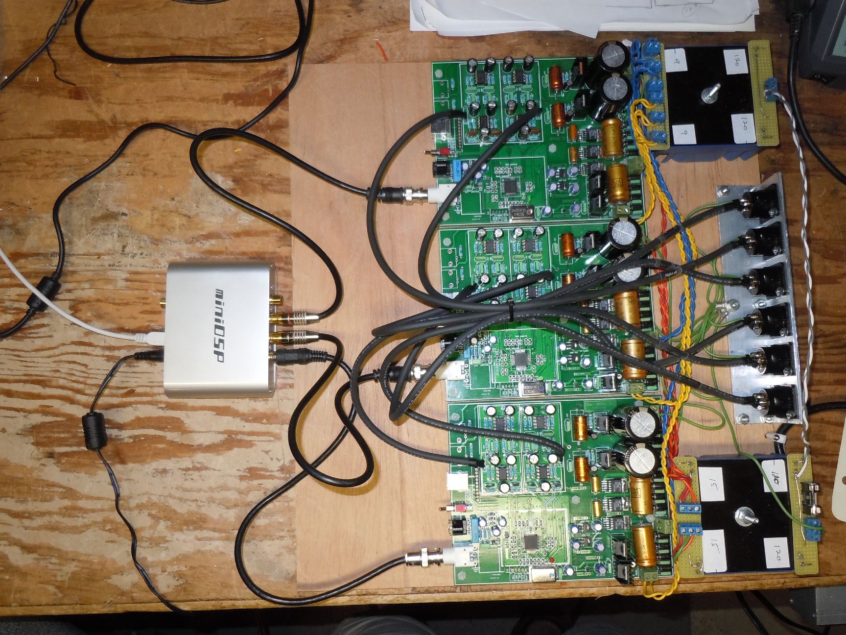

I'm starting a project to determine the effects of various sample rate and bit depth files including resampling. Currently I only have some Behringer digital equipment so I'm creating another digital path for comparison to see what effects the hardware might have.
I'm encluding a photo of the breadboard of the DSP section that uses a nanoDSP board from miniDSP and three DACs that use the ES9018 chip. At some point I'll also be using different source material from a Bryston BDP2 player, Bluray discs through an Essence HDACC converter and a Benchmark ADC1 A to D converter. If I can twist Roscoe's arm I may get him to provide a fanless PC as a file server as well.

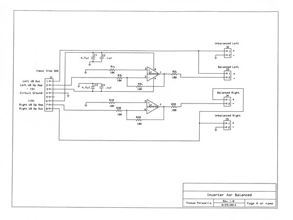

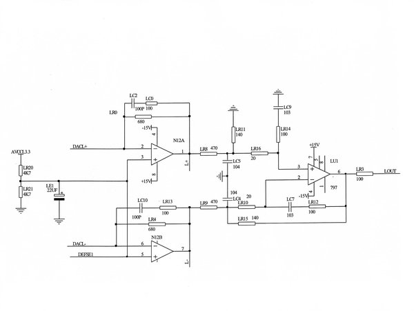

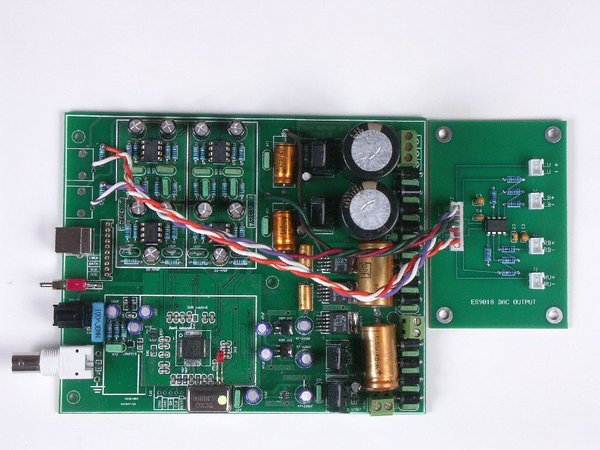

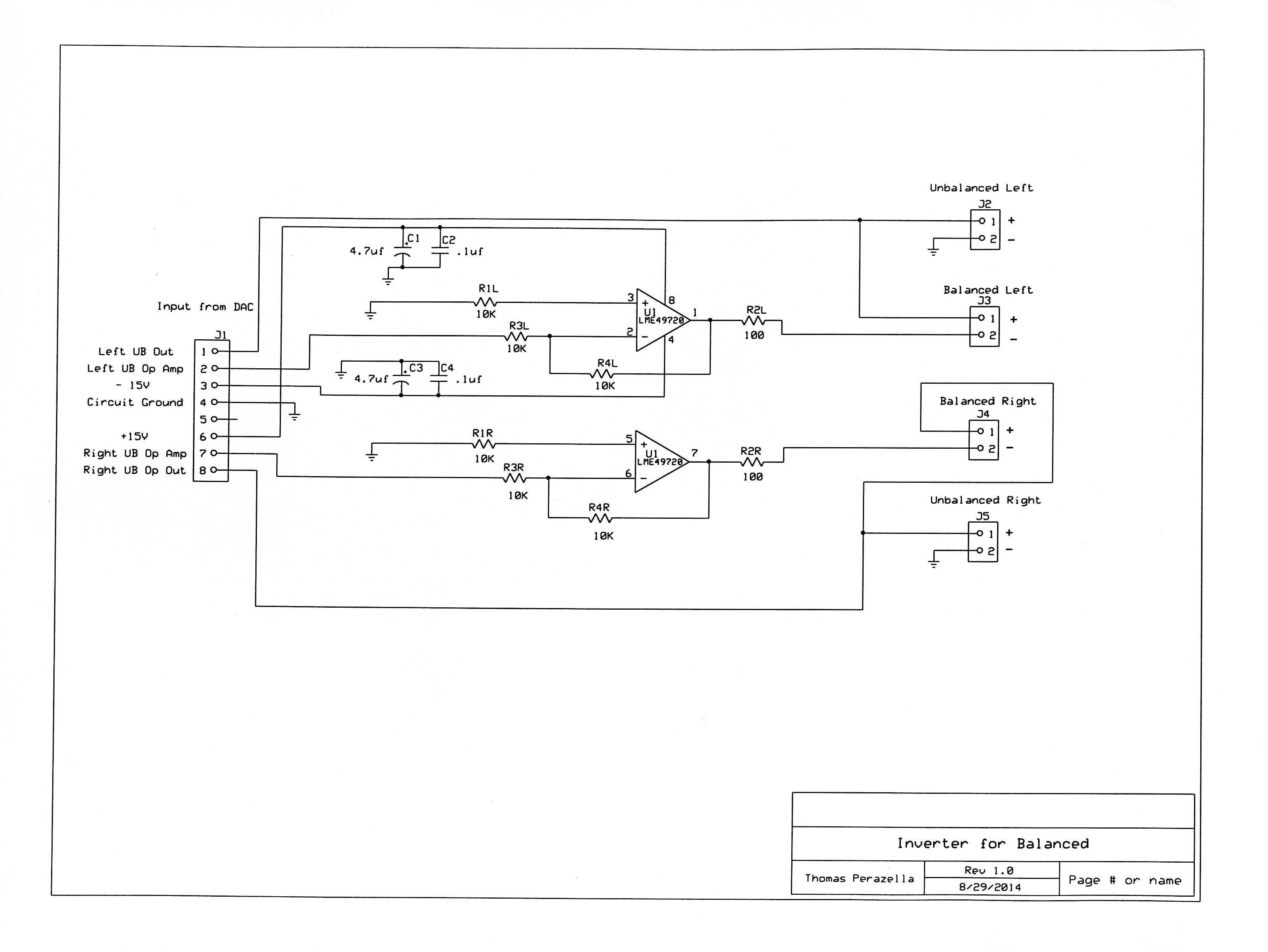

As I started testing the balanced outputs of the DAC I found that they have a +1.65 volt offset. That is done to bias the output of the ES9018 to half the 3.3 volt supply voltage. The manufacturer sent me a schematic of an output board using large blocking capacitors as a method to remove the offset but I did not want to put 12 large capacitors into the mix (triamped with balanced = 12 caps needed). David came up with a very clever way to adjust the bias out with voltage from the -15V supply but I did not want to reduce the drive level or worry about resistor precision or trimmers.
I built a board to pass through the unbalanced output of the DAC which does not have that offset and also provide an inverter circuit to provide the inverse signal to drive the balanced outputs with no offset. Here is a photo of the board atatched to the DAC and also schematics of the output section fo the DAC and the inverter. I could also have used a THAT1606 balanced line driver to produce the output from the unbalanced outputs that had no offset but I wanted to use the same device I used in the DAC so I went with the inverter using the LME49720 Op Amp.
