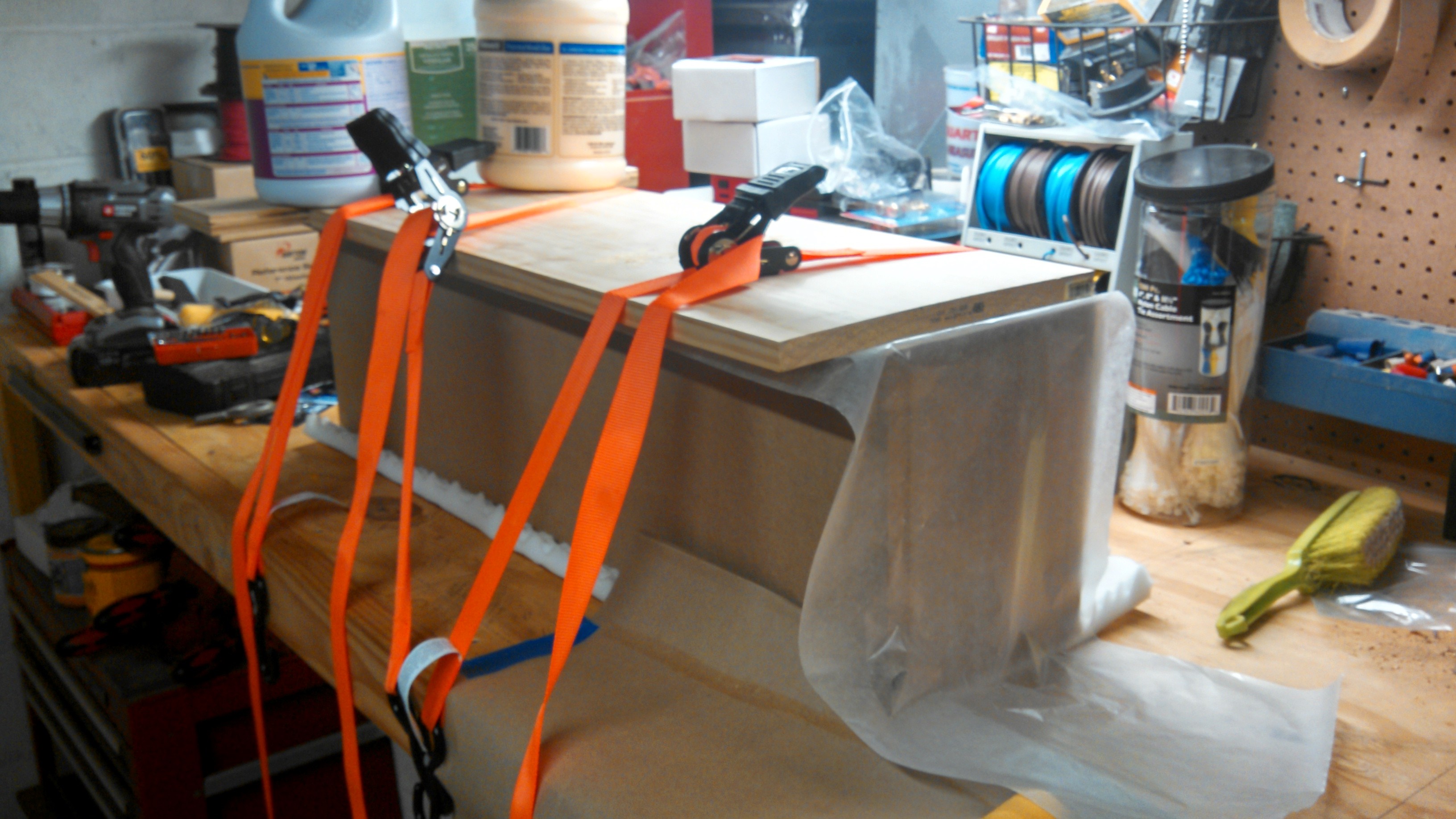

Got the cabs glued together per Eric's instructions. No fasteners of any kind were used as all cuts were CNC and dado so the fit was snug. Clamping was a learning experience. I had bought a bunch of clamps that none worked perfectly and then decided ratchet straps and cushions worked much better.

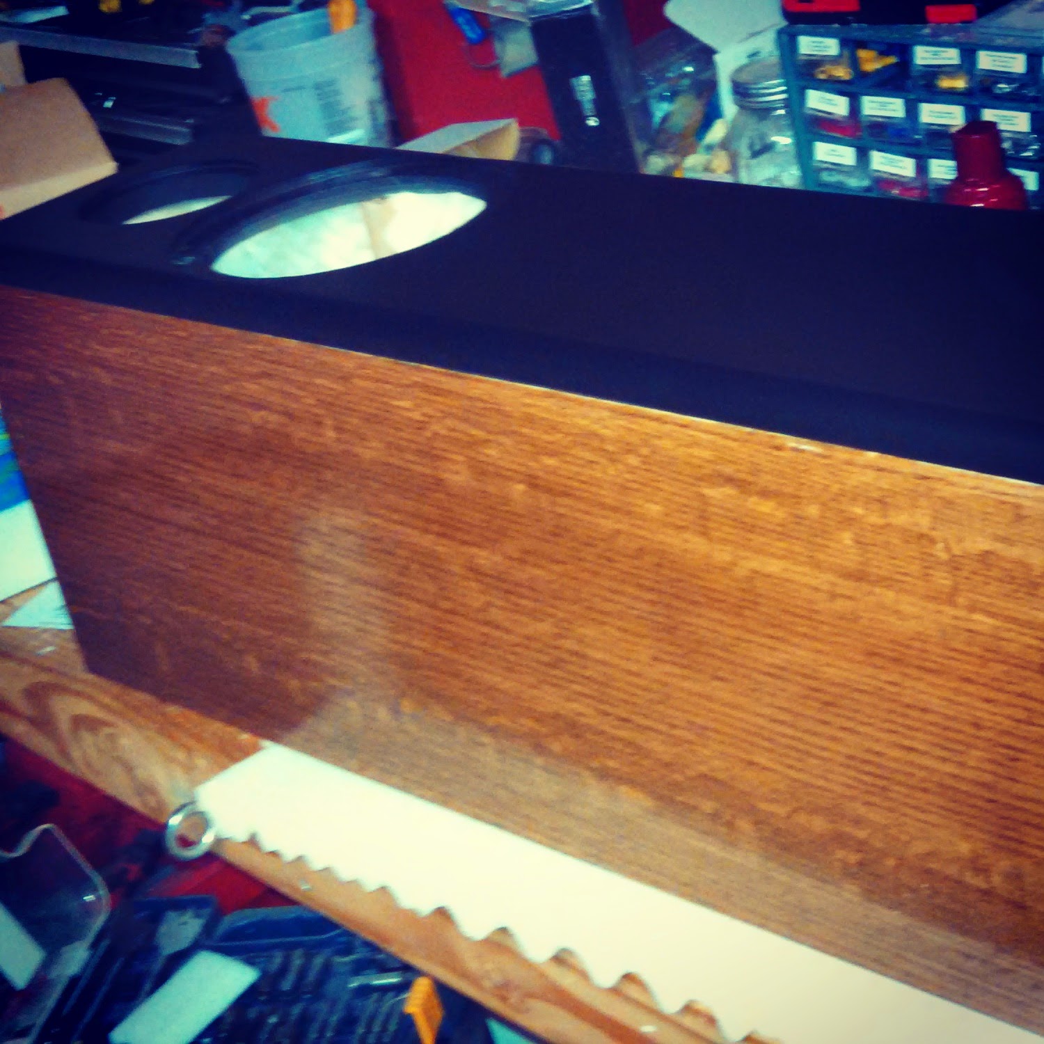

Decided if I was going to get my feet wet- I might as well do the best job I could. All the furniture in the house- save for a couple of things are all antique oak. Some mission era- some more primative- but nearly all oak. Thought a nice quartersawn oak would fit the bill so I ordered a sheet of Paperbacked slip match quartersawn with heavy flake. Was a bit nervous as I had never veneered anything but followed the instructions and took my time. Overall I was incredibly pleased with how it turned out.
Decided on special walnut to get me closer to the color I was looking for. Couple of coats of stain, and then went on to poly. This is where I would do things differently next time. I had some helmsman left over from other projects and decided to use it. It has a good UV protectant in it so I figured no problem. Well spar urethane is a pain in the @#$, and caused a lot of headaches. Ended up with 2 undiluted coats- 5 thinned coats, and then wetsanded with 800. 1000. 1500, cut and buff on top of that. They are as slick as an antique crisscraft now - still see some imperfections and some buildup near edges. I did not realize Helmsman is designed to remain softer- and that made things complicated. All in all though- and from the normal listening distance- I think they look awesome.

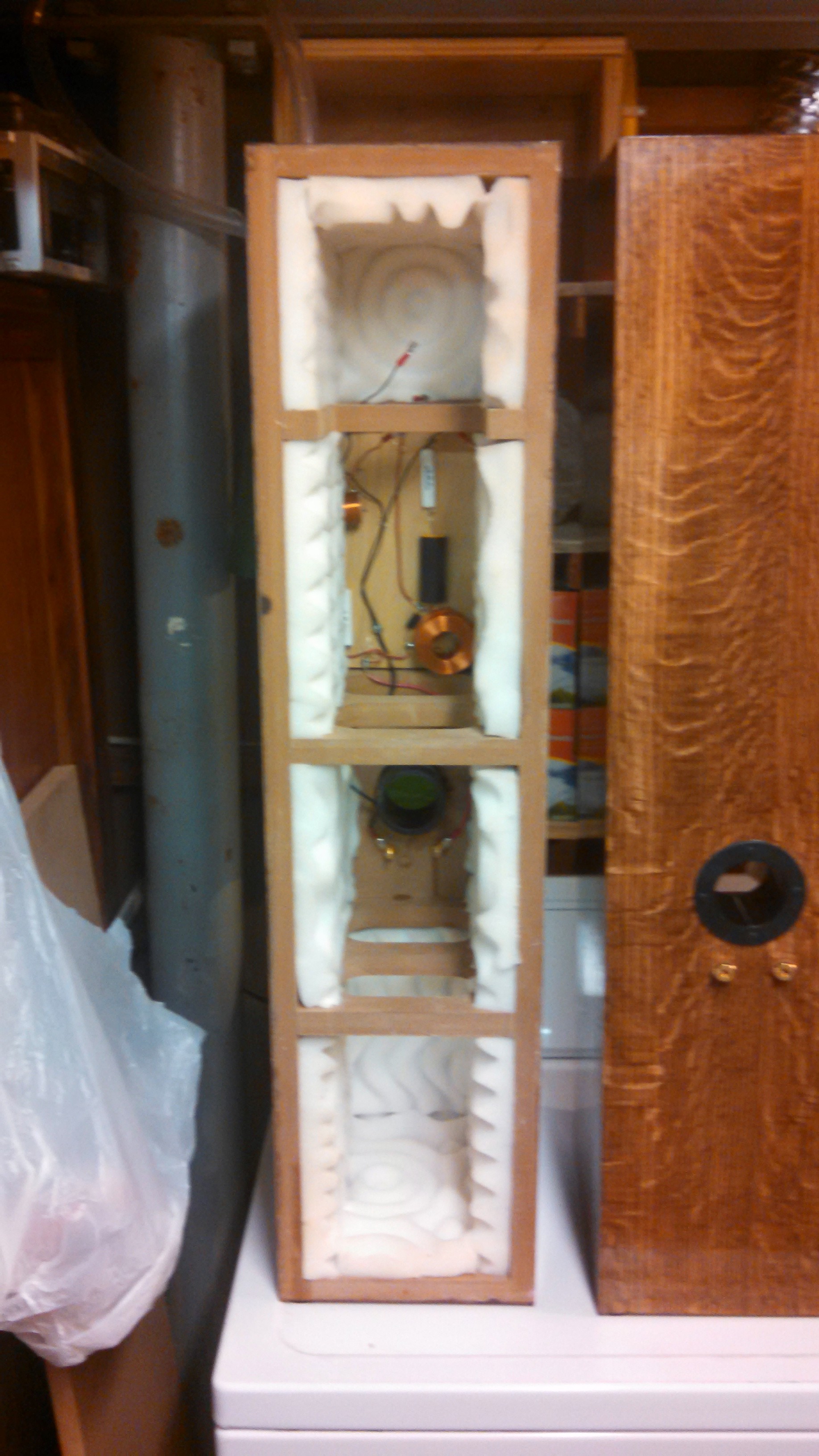

Lined the cabs with dampener- installed the crossovers and wired everything up. Binding posts through the back. I ended up placing them wider apart than most as I like having some room between. Port is nothing special- an adjustable from PE.

Picture of the crossover. Took me having to completely disassemble the first one I made. Tried to do the connections on underside for a more professional look, but getting the connections right doing that was very difficult for me. Then it dawned on my that this would be on the inside of the cab so why care about its look? It was great duh moment
